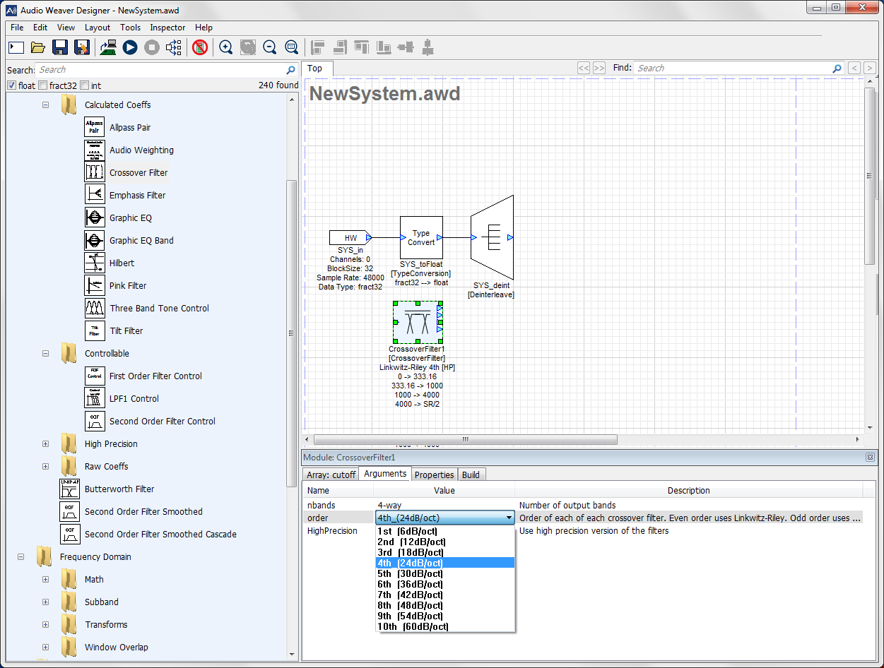

The natural solution would be to use a limiter, which is feasible in Audioweaver.
With Dlcp you can't do this and the only option is to use a subsonic filter.
Audio weaver is great for this, you can set a limiter that increases it limiting based on input level, sonic you work out the maximum signal level which when amplified will cause maximum excursion of the cone you can then set a limiter to work as the level approaches that amplitude. Clever.
