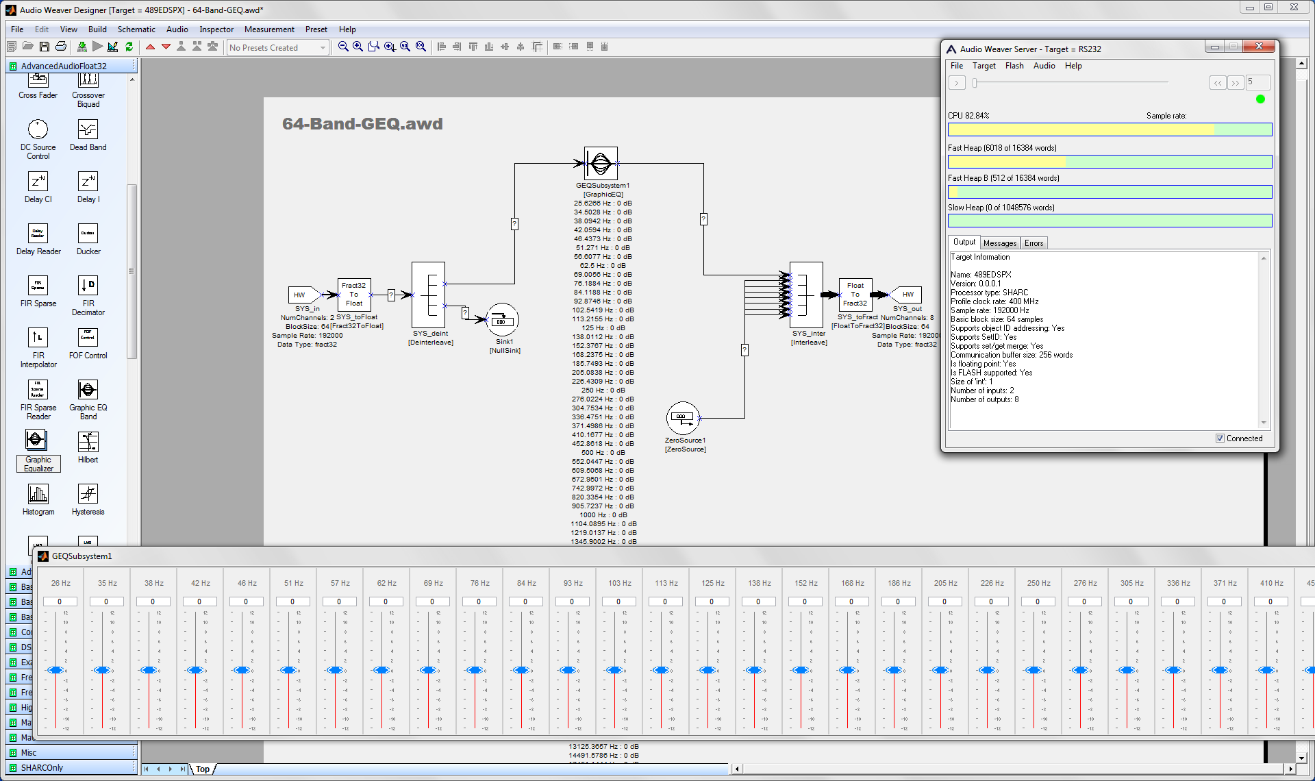

What about 64 - band EQ with some control similar to Audyssey, instead of "tube-like" distortions that don't add tube-like absence of audible distortions?
The tube emulator is a plugin that works in 2/8 channel Preamp mode along with other plugins such as soft clipping, precision 32 bit signal generator etc. The 64-Band EQ I was able to do one channel with Audioweaver but it was pushing it at 192KHz but still I did not have to write one line of code 😉

Waiting for a 64-band EQ. ;-)
Instead of soft clipping there would be better to have a latching compressor - limiter.
There is. Look above in the attached image. I just implemented one in Audioweaver. Audioweaver also has many different types of compressors and limiters.
