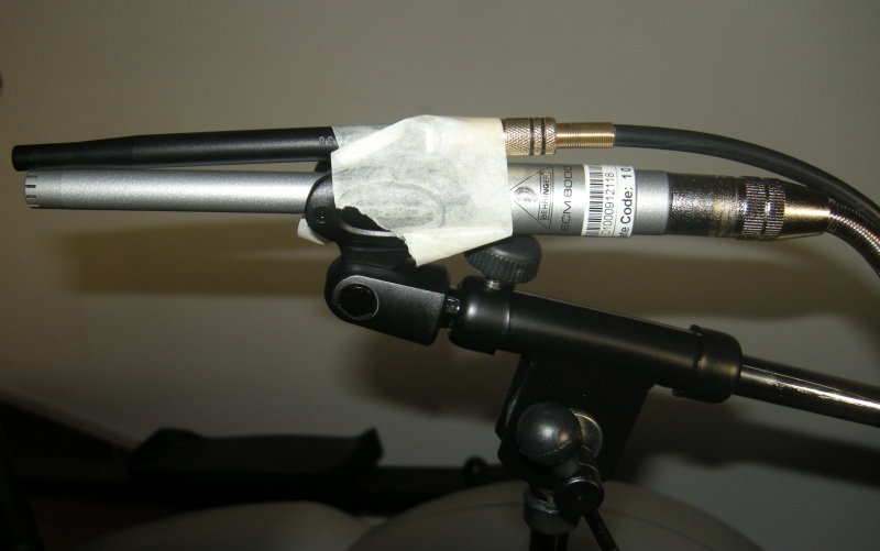

I can calibrate it because I can use the Clio system & Clio mic. like reference.
With a behringer emc8000 the chance is huge that you will have a perfect flat response and phase up to around 10khzin this region they can have non linearity it even can be that it is very flat up to 20kHz.
And like you said you can compare to your clio system.
And when measuring in room with a 80msec window will only give a faulty result.
What you think about the BEHRINGER ECM8000 as reference mic. because probably I cannot use the Clio mic. with EMU 0404 ?

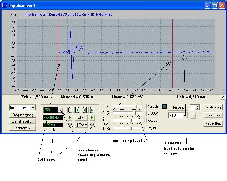

I can do one measurement and look at it in different window length without measuring again.
Distortion measurement in % or dB or at 1 frequency.
DB
On one bad frequency that you want to explore higher order distorsion. Like your clio you can also use it for amplifiers.
You can paste two responses who you saved. Like I explained with a short window for high frequencies and longer window for low frequencies.
spl with phase step response impulse response. It is very complete with many custom adjustable layout possibilities.

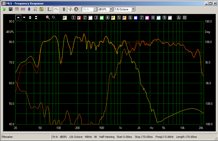

1.5meters
Clio 8 + mic 01
Sampling 48KHz
Size 8K
Window Hanning/2
Averages 5
170msec

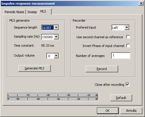

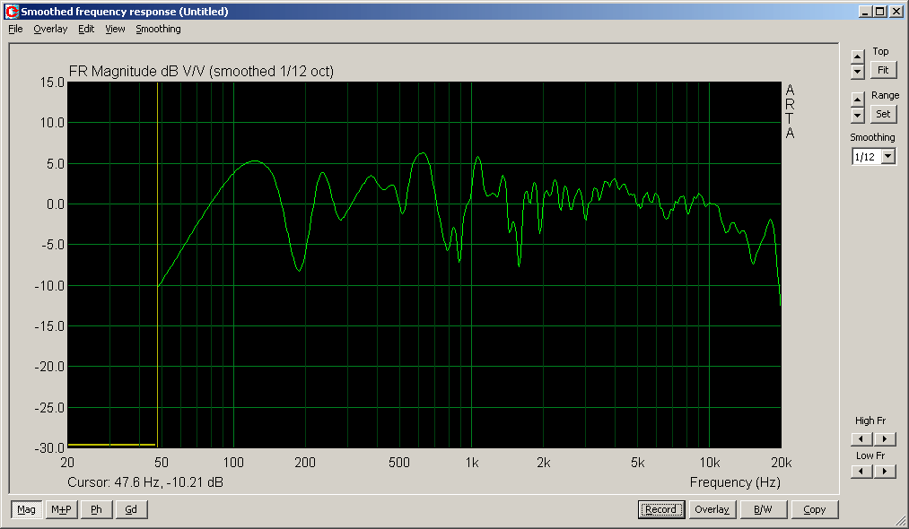

Arta + EMU0404 USB + ECM8000
Sampling 192KHz
Sequence length 32767
Averages 5
Size FFT 8K
170msec

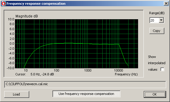

I don't know if the calibration file used for ECM is ok

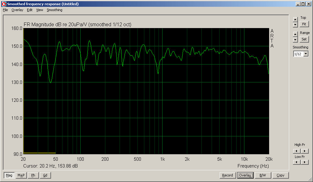

Helmuth, yes now I have disable the calibration file and the result is more near to Clio.

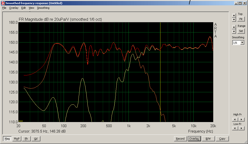

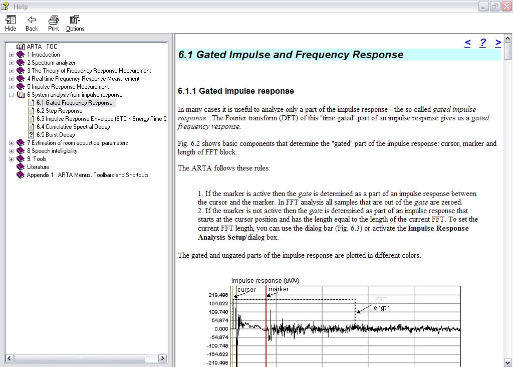

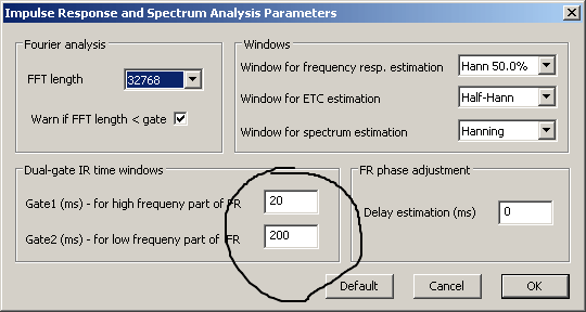

Using Arta there is a funtion to produce a frequency response with two different time window for high and low freq., Is this what you mean ?
This is the measurement with dual gate FR
200msec for low freq, min value 70msec
20msec for high freq. min value 5msec
70 msec means that we wait for wave lengths of 24meter. do not now how big your room is?😀
To get a refection of the floor 1.5mtr s enough 4.3msec. to get a reflection of the sealing 3mtr is enough 8.7msec.
so to calculate how long it takes for a reflection to be measured. You calculate the distance the wave has to travel in mtr.
then: travel distance in mtr / 344 = sec
