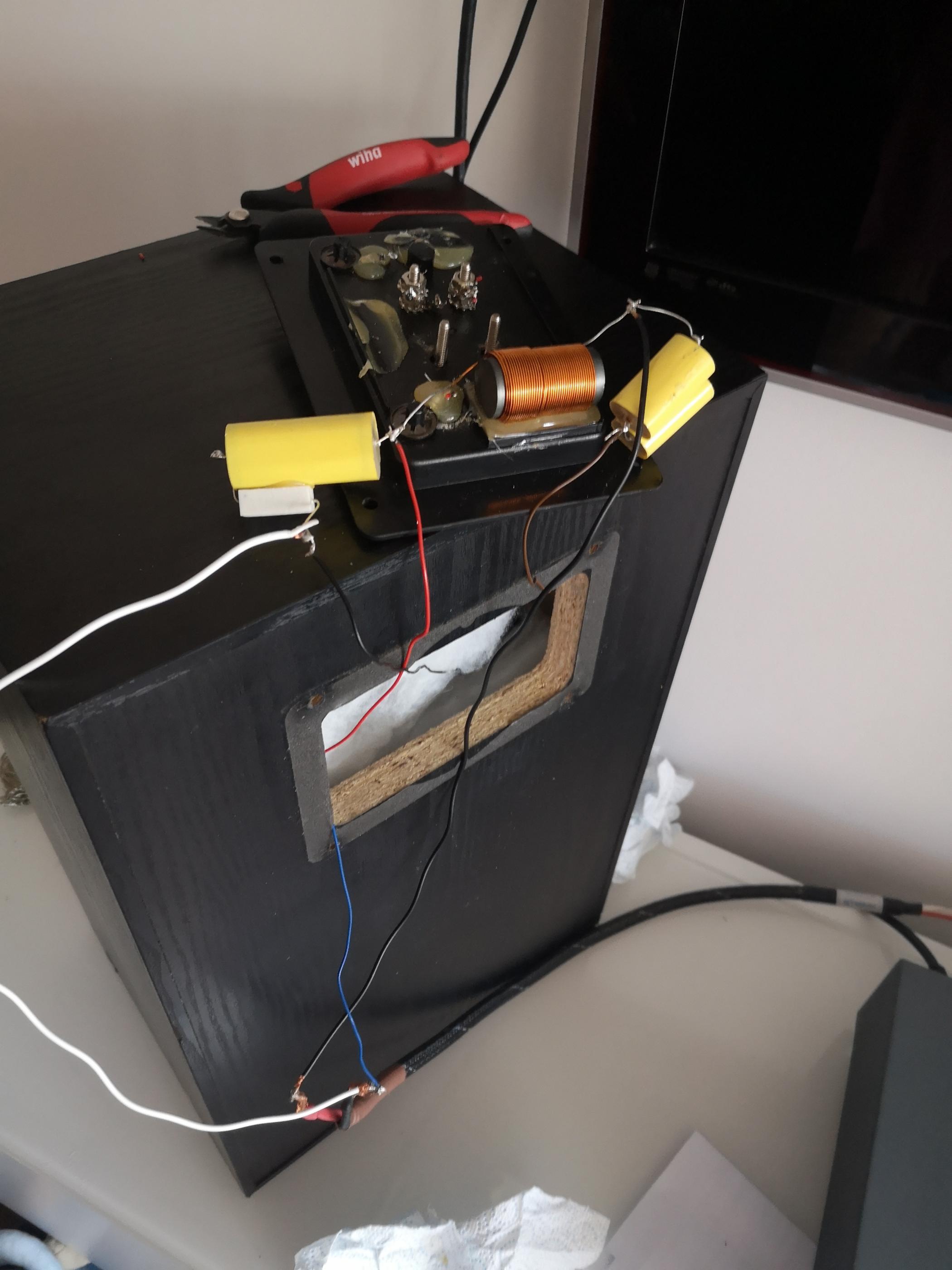

Hello. I have a problem with the heybrook HB1 speakers. After connecting them to the amplifier, the tweeter does not sound, but hums. I pulled out the crossovers and checked under 1.5v and reacted. Then I replaced the capacitor with another one and only at 470uf it started to play nicely. On the other hand, when playing one of the PR speakers, touching the screws that fasten the speakers means making some crackling noises. Ground loop?

Tweeter dont wont to react togheter with midlle woofer.
I think this is problem with crossover.
Alone Tweeter play great.
This is biwiring.

The crossover on the right includes some stranded copper wire which I don't see present on the one on the left - looks like someone has been making alterations.

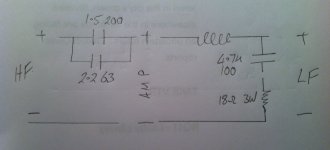

In capicitor 4.7uf with resistor Come only one wire to woofer from one side. In other side its connect tohgether capicitor Wit resistor.

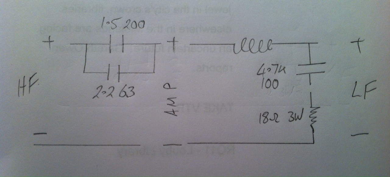

It's bi-wired meaning two sets of + and - input terminals.
On the tweeter side, the negative input terminal should be wired to the negative (black?) terminal on the tweeter. The positive terminal should go, first to the pair of capacitors, and then to the positive (red?) terminal on the tweeter.
On the bass driver side, the negative input terminal should go to the negative terminal on the bass driver and the positive terminal should go, first to the coil (inductor), and then to the positive terminal of the bass driver. In addition, the series combination of resistor and 4.7uF capacitor should be connected across the negative and positive terminals of the bass driver.
The above is a description of what is shown on the attached schematic.
Let us know if you find a fault in the wiring after examining it as described above.
If the wiring's correct, the hum & low volume suggest there's a short in the tweeter. (Roasted voice coil?)
the next step would be to disconnect the tweeter and measure its DC resistance.

I think the tweeter is a Vifa D25TG, data sheet here:
Vifa D25TG-55 -06 tweeter – NedLab,
so its DC resistance should be 4.6 ohms (Will read slightly higher because of the resistance in the leads of your meter)

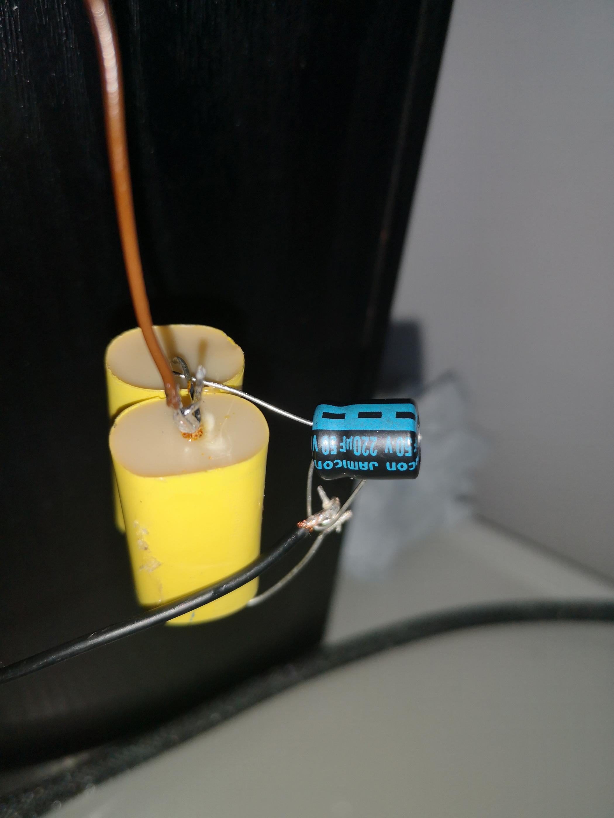

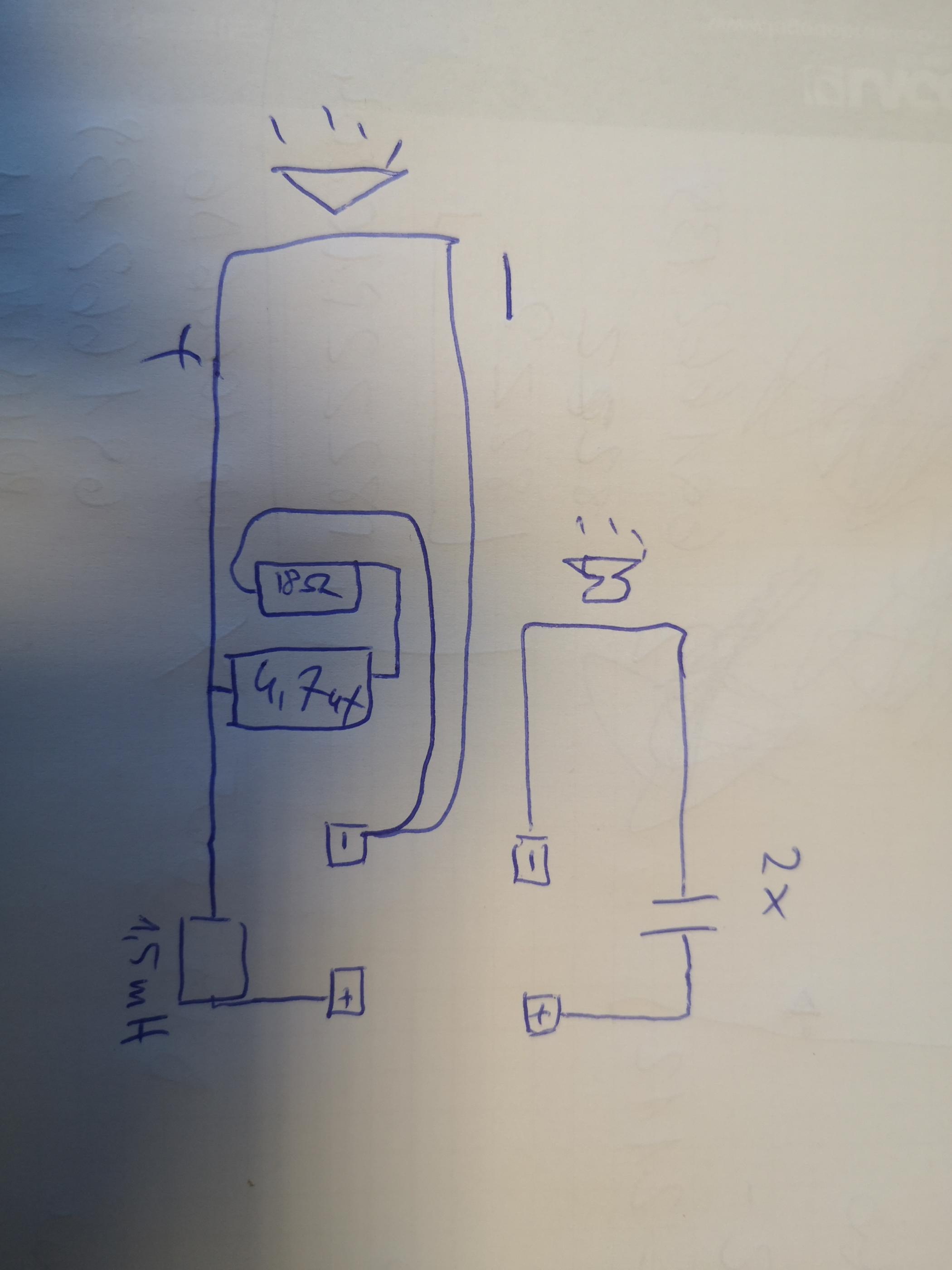

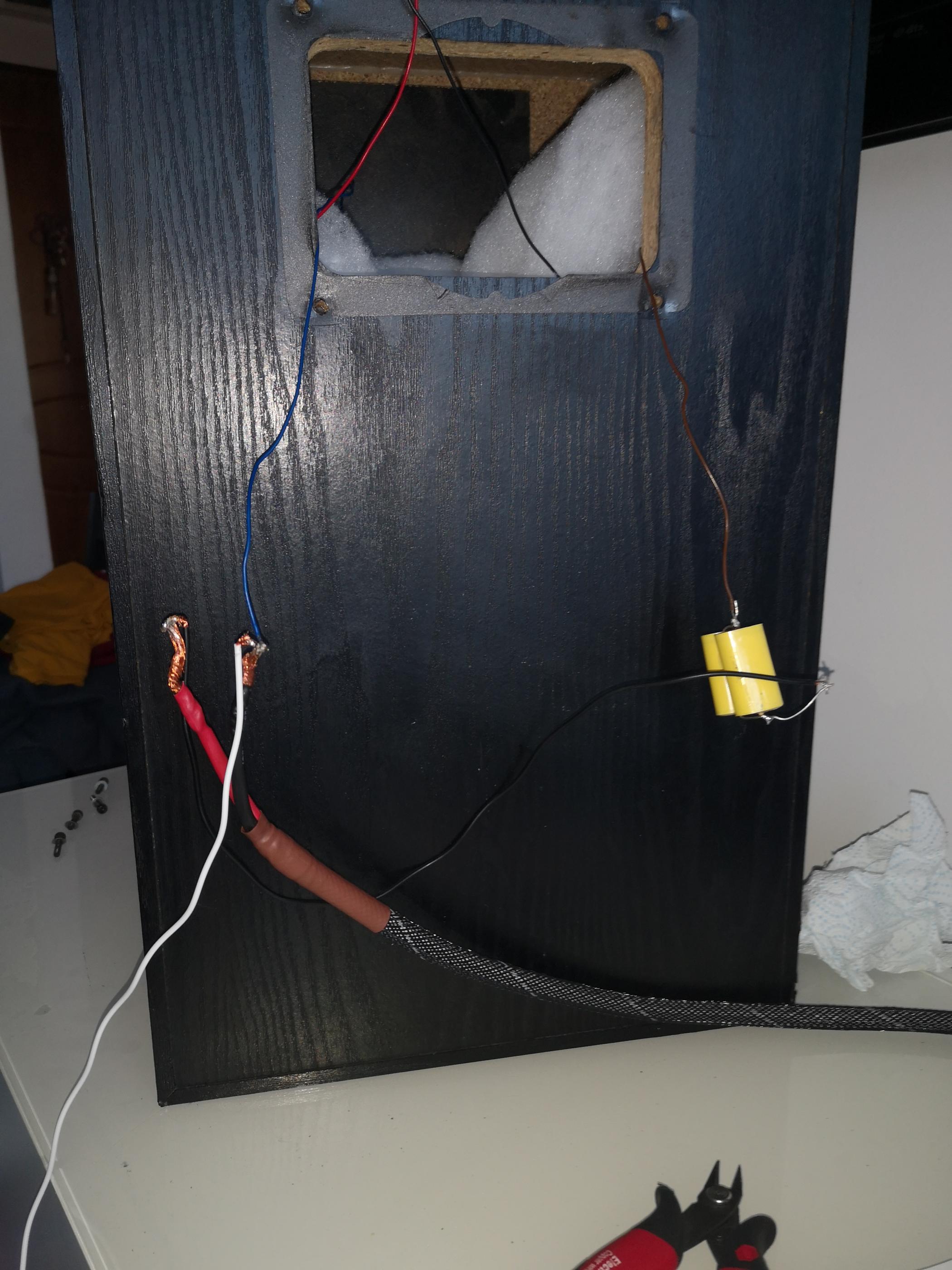

Hi. Tweeter hew 4.9 Ohm. I takę out everything to connect without Old stuuf. Photo Bellow.
Its still doesnt work.
One of this photo its capicitor. They have a liitle hole.
I vaiting still for new capititors.
When i connect Alone Tweeter its work but still to quiet.
Its much better when i give 220uf

There will be nothing wrong with these film capacitors.One of this photo its capicitor. They have a liitle hole.
The fault is obviously in the tweeters themselves.
I can't get the YouTube video to open just now, but, as fatmarley has suggested, the problem sounds like dried up magnetic fluid in the tweeters.
If you have a spare tweeter, or even a small loudspeaker driver, you can try connecting it up to the crossover in place of a Vifa tweeter. If the spare tweeter works you will know that the crossover is OK.
