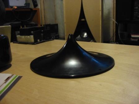

Hi take a look at Visaton Fontana at BMM
part no. 5091 looks quite handy. It may be the wrong diameter and not so much DIY but may help a person interested in a similar project but with lesser woodworking capabilities. Good price to boot.
I do have the perfect reflectors for you but don't want to part with them...I should have the negatives kicking around somewhere... maybe I'll cast a couple with flat tops for you and you can adapt them to your app. I'm pretty f'n lazy though 😀 It may be better if I send plaster negative to you and you can experiment with different materials, filler, CLD, whatever.
Illusus said:Hi take a look at Visaton Fontana at BMM
they are a bit small for the project. Also, the angle is not very diffraction friendly IMO. Most of the sound waves would be radiated upward, and not outward, I would think.
But there is one thing that I am very entrigued with. And that is the placement of the tweater in the top of the diffraction horn. I like that idea. I will have to think if this and see what my mind comes up with.
That reflecter picture you have is about perfect. Only the hole at the point would have to be fixed for my use. The reflecter would have to be 13" in diameter to reach to the corners of the plane of the walls, but that's more than doable.
Coming up with something like that would work very well for inserting the tweater on top. You could carve out the hole, or include it in the cast.
BTY, is your negative a one piece affair, or two pieces? I am not familiar as to how pouring molds would work. And what material would you use?
I don't know if this was suggested before but could you use the a backside of a wave guide as a deflector? The Dayton example here http://www.partsexpress.com/pe/showdetl.cfm?&Partnumber=270-312 looks like it has a very smooth back. You might need to deal with the mounting threads at the end by cutting them off and putting a small cone there. Its a cheap and (possibly) very simple solution.
that's an interesting idea. And it is somewhere close to the diameter I want. It may make a great form for making a cast, but it will not work in and of itself.
I am going to try to pursue both the lathe work and also try out the possibilities of molding one which would be great for hollowing out the top and dropping in a tweater.
Your idea is a very good and sound one. Thanks for the input. keep 'em coming.

Illusus said:I do have the perfect reflectors for you but don't want to part with them...
I have a whole bunch of those too... none big enuff for this ap.
These shapes were used in a whole serious of designer electrohome boxes topologically identical to John's project. A lot of thot was put into the profile to achieve its job.
If someone wants one to use as a profile guide i can spare 1 i'm sure.
It's a one piece affair. I used short strand fiberglass epoxy (body filler) and applied it in 1/4" layers. I used a frying pan as the top half of the mold, to get the top smooth. I really like the body filler, despite the stench, one could use a thin layer to start then stretch it with shredded rubber, lead shot and or sand for the subsequent layers providing damping at the same time. The bondo is easy to work with and finishes very well.

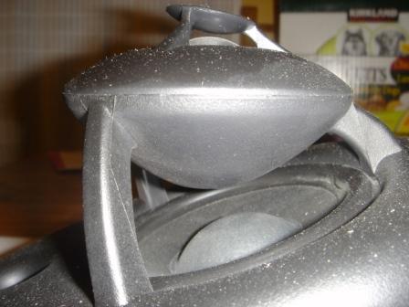

Concave or Convex
I was looking at some omni surround sound speakers, I got from Parts Express. They were on special, and have licensed technology from Mirage. I always thought that the "reflectors" on the omni should be concave, as in the pics earlier in this thread. As you can see, these have convex reflectors. They sound great, with wonderful coverage. What's your opinion?
Re: Concave or Convex
I wonder if you could affect the immedacy of the sound by dimpling those reflectors like a golf ball (okay, yes, I'm trying to be funny, but I've seen it done with flared ports, so... maybe a little bit of good theory there)😀
pblossom said:I was looking at some omni surround sound speakers, I got from Parts Express. They were on special, and have licensed technology from Mirage. I always thought that the "reflectors" on the omni should be concave, as in the pics earlier in this thread. As you can see, these have convex reflectors. They sound great, with wonderful coverage. What's your opinion?
