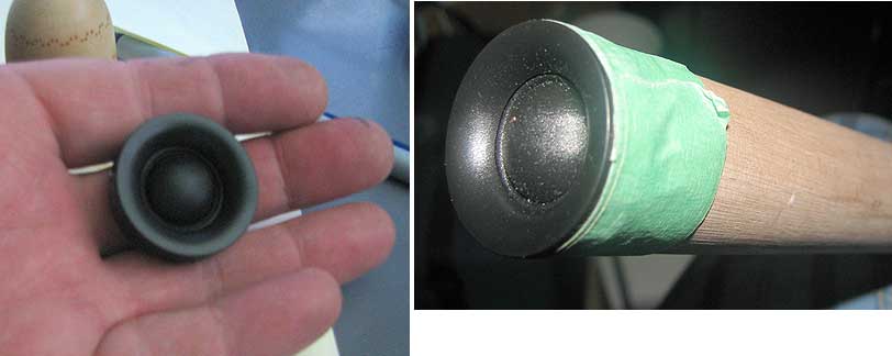

that is why I am trying to make the explanations as detailed, but concise, as possible. It's really not all that bad. It's just daunting the first time around.
My greatest challenge now is to find someone who will be able to turn the upper diffraction piece for the top. Anyone, who uses a lathe, I could use some recommendations, or help here.

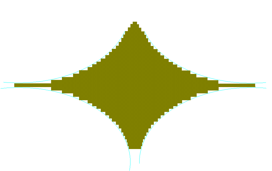

Did you find a source for the top horn section? Seems everything from the sixties and seventies had something with that shape on it - lamps, swivel chair bases, planters...
If your stuck for a source, consider making it yourself like this:
A series of disks, each smaller than the previous one, stacked up and glued together. These would have to be cut to the correct diameter.
You could use 1/4" MDF or hardboard for the clean stepped edge (like we see on some horns), or you could go the extra distance and fill these smooth.
Also the disks could be rings, to have the centre of the horn hollow. This has the side benefit of being able to use the centre cut outs as more disks. The hollow centre could be filled with dry sand to damp resonances.
Not especially hard to layout either. Use some 1/4" graph paper (grid), joining 2 or three together to get the right width. Draw the arcs and measure each piece.
Here's just a rough sketch of what I mean:

Kensai said:Having the tweeter sitting on something (like a length of dowel) that's sitting on the B20's pole piece (yes, with the dust caps removed)
Make the top part out of plaster. cast it in sand.
scrub it with a nailbrush, then coat it with gloss black paint. that will secure any remaining sand and give it a pretty cool looking surface.
Use the first one as a pattern, then shove it into the sand to make 2 more so they will be identical.
OzMikeH said:Make the top part out of plaster. cast it in sand.
Oz, that's an excellent idea! I'm wondering why I didn't think of this earlier. But that is the purpose of a thread, such as this. Imput is great isn't it. 😀
Thanks a lot Oz! You're a real Pal!
