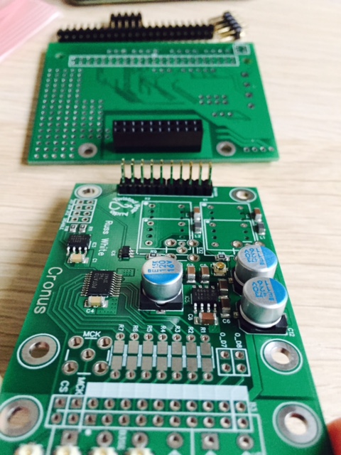

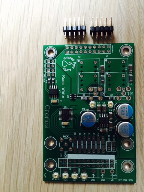

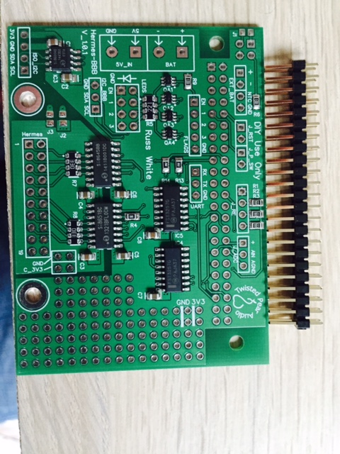

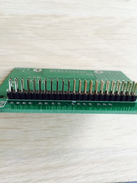

Russ I have the capes for almost a week now and has no idea how to connect them together. Can you please help me out. I am pretty sure it is not complicated but no idea how to connect the boards together.
Just test fit the Hermes headers (on hermes-bbb and Cronus) the way you will want the boards to stack (look at the many photos) then solder the Hermes headers after you are happy.
If you want to use terminal blocks on Cronus solder them on the bottom of the Cronus.
The select the 2:1 (for 45/49Mhz clocks) or 1:1 (for 22/24Mhz) clock divider by installing a jumper at one of the two places.
Cronus datasheet is almost finished. 🙂
For the Hermes-BBB I will post the schematics.
Give everything a test fit - and if you need more help we can get it sorted.

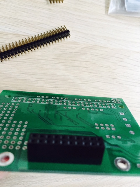

What all mistakes can possibly happen with alignment of headers on Hermes ? I remember reading about some alignment mistakes Twluke made, but never understood what it was
As long as you use the provided (20 pin) male and female headers with the correct number of pins the Hermes header is very straightforward. Test fit and check.
I think his error was with the large green terminal blocks, not the headers.

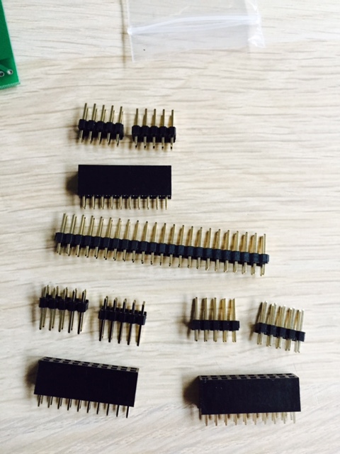

Do you have a 2 x 10 male pin header or just the two 2 x 5?
EDIT (nevermind I confirmed with Brian that some of the kits are packaged this way - 2 pieces of 2 x 5 is just fine)
You are all set on the hermes - I tend to prefer to keep the male headers on the same sides - so I would put the put the male hermes pin headers on the bottom of the hermes and the female on the top of the Cronus.

these are all the headers,that came with boards.Do you have a 2 x 10 male pin header or just the two 2 x 5?
Plus one 2x4 header which is not in the picture
