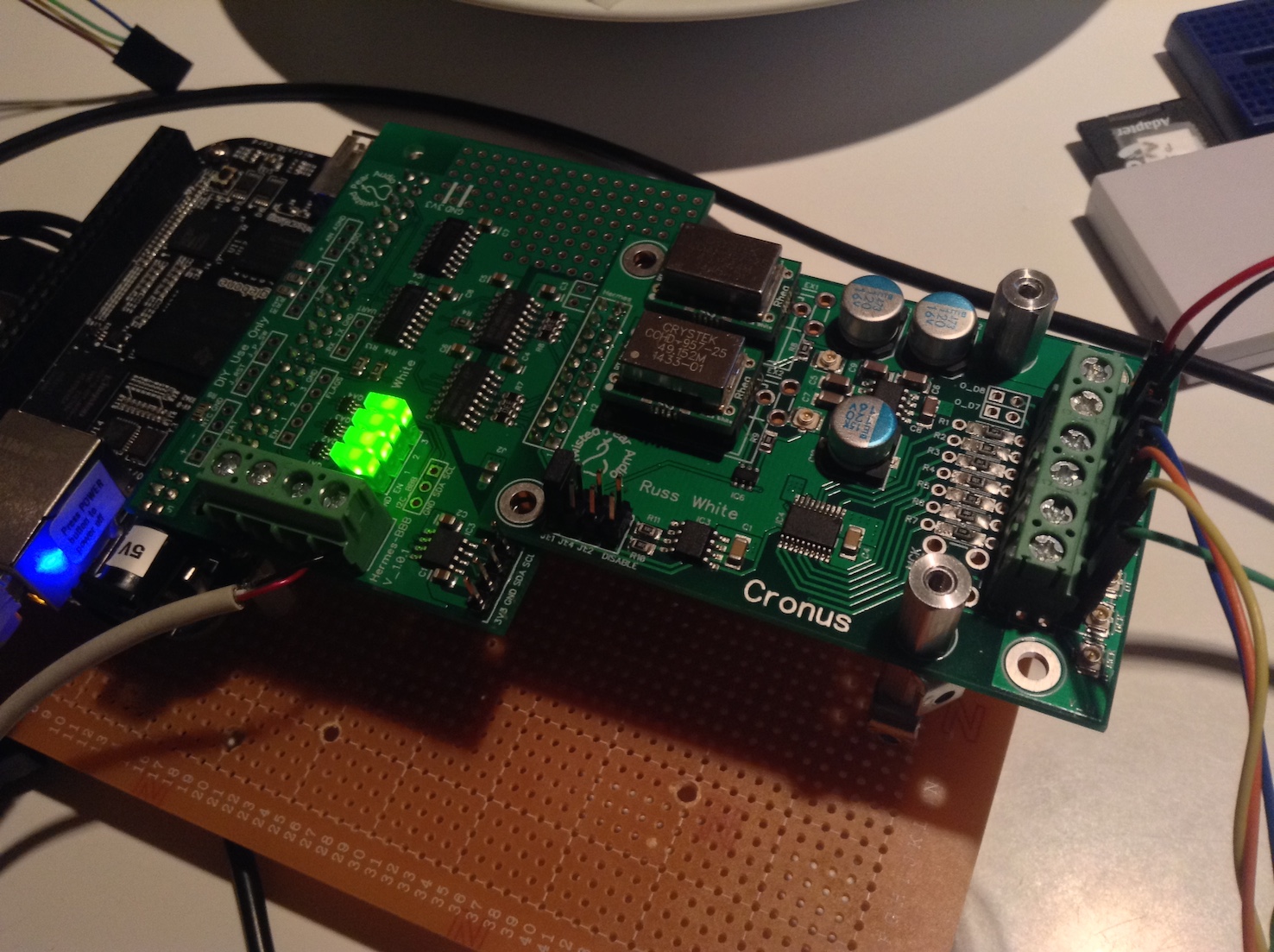

Hi Russ,
First of all, I'd like to thank you and your team for this great work.
The boards were delivered last night. Today I assembled the boards with 45/49 Rhea. Soldering went quite smooth but I made a small mistake to solder the Cronus header to the wrong place, intending to preserve the space for handling uFl.
After several attempts with no sound, I became aware that I was wrong with choosing holes. Leaving the already soldered header as it is, I added other header pins to the original (default) holes and succeeded in getting sound.
Playing DSD128 and PCM on B3SE via teleporter and these board is quite smooth but I'm going to check the details in the weekend. Included is the picture of my rough setup. My next step will be to find a new box for my B3SE and Hermes-Cronus with BBB.
BTW, I'm still using software clock divider by miero instead of H/W divider on the board. If I'm going to use the latter, I think that there is no necessity to edit kernel option for clock rate setting. Correct?

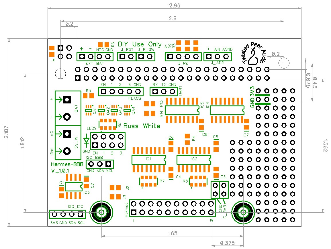

Here are the dimensions for the Hermes-BBB. I hope it helps with planning.
Hi Russ,
Got my Hermes Board (no parts) yesterday, very fast to Germany! Thanks for it.
I believe to have all the right parts, but a schematic or part list would be nice for soldering.
Thanks in Advance.
