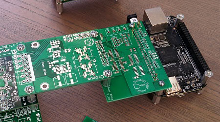

While we wait for production/delivery of these boards, I would like to know if the headers will be pre-soldered ?
I ask because I would prefer an up/down board configuration, as opposed to up/up configuration. Photos attached.
I understand the up/up configuration is suitable for direct-stacking onto a Buffalo+I/V, but I have different DAC hardware.

Another vote for non-presoldered headers here 🙂 I may go for right angle headers on mine so I can have the BBB/hermes/cronus in a U shape and keep it all compact in my case rather than spread out in a long strip.While we wait for production/delivery of these boards, I would like to know if the headers will be pre-soldered ?

Maybe I can stack everything on top of the DAC (need to do something with Tridents/AVVC), but I may have to have mine to the left of the DAC, rather than on top, any right angle connectors or just use cable?
None of the through hole parts are pre soldered - precisely for flexibility in physical configuration. 🙂

I'll post some pictures of the kits tonight. I have tried to include all the headers you will need. For the 20-pin headers that go between the DAC/Cronus/Hermes, you get both a female and male for each position, so you have a good deal of flexibility in how you stack/connect. You could use 90deg headers in several positions, but I am only including straight stacking headers.

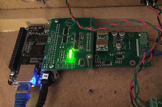

Russ, Congratulations to you and all involved for getting this wonderful project into our hands I am very intrigued that have been using your Hermes/Cronus/BBB as a UPnP device and have since ordered the pair from you. If you have a chance, I would love to hear how you configured your setup. Also if you might be able to provide some advise for SPDIF output.

The reclocking/relocking just alignes I2S/DSD/SPDIF signal incoming from the BBB and galvanic isolator to the master clock. So this eliminates jitter.
No upsampling is performed by Cronus... stream with 44.1kHz sample rate stays on the 44.1kHz sample rate... but perfectly aligned to the master clock.

Here is how you can use Cronus:
* PC -> Amanero -> Hermes-Amanero -> Cronus -> DAC
* BBB -> Hermes-BBB -> Cronus -> DAC
Both options should have equal electrical/timing/jitter signal quality, because the signal is 'fixed' by Cronus.
