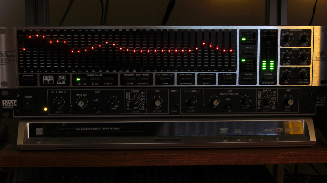

Yeah, I've been putting some time into this. Of course, I want it correct and natural. So how does it feel controlling someone's hifi system over the internet?! LOL
I've been at it again today, this time for several hours. I started completely from scratch, putting the xover and EQ settings to "zero" so to speak. I turned the horns off and just played with the xover settings on the Ushers only. Once I got them where I wanted them with the proper xover point, I turned them off and had a go with the horns. I did the same with them minus the xover point. Once I got their levels just right, I turned the Ushers back on and tweaked with the woofer delay settings until everything was plending as close to perfect as I could get them.
You know, I remember reading somewhere that if you use and adjust a crossover properly (xover point, levels, delay), it can have a similar effect as using a parametric EQ. After spending a couple hours alone simply adjusting the xover, I now see how this is completely possible! Without even touching the EQ, I was able to get a pretty decent flat response from 100Hz all the way up to 10kHz and completely eliminating that annoying peak around 1kHz I had before.
So back to tuning... Once I got everything sounding as good as possible with JUST the xover, I started work on the EQ. With about an hour of tweaking, the EQ itself looks totally different and civilized compared to before, as does the curve on the SynRTA graph.

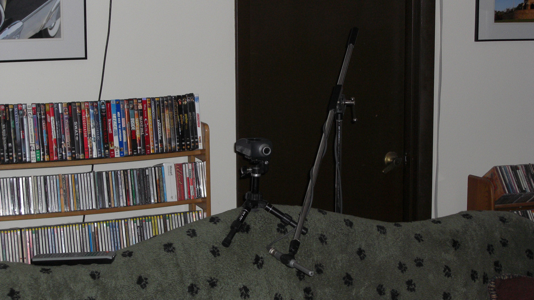

And just a couple pics of the RTA setup...

FYI , you should turn your measurement mic off axis. Both the Behringer and the Rat Shack meter are meant to measure rooms, not speakers directly. If you turn the mic about 70~80 degs off axis, you'll get a flatter response in the high end.

For the longest time, I refused to use an EQ as well. But you know what, if one is used properly, you will never know it's in the system. This little DEQ1024 is a nice unit, even if it "cheap" and looked down apon audiophiles, as is nearly everything Behringer. Their loss I say.
You read that in the users manual of your Rane crossover, of course!.
Your radically new EQ graph shows that very well.
Of course! Now I remember. I should have remembered that ealier...
Yeah, the EQ curve is radical compared to before. Also, it has slightly changed some more, this time on the lower end between 100-500Hz. It's nearly flat now. That's after several hours of listening then tweaking a bit by ear. The top end certainly sounds a lot better than ever before!
If you haven't already, go back and reread your Rane manual and check out the section on delay settings. That will help a lot.
That's exactly what I did. That's how I was able to get that nasty 1kHz peak totally eliminated. BTW, that 1kHz spike would pop up when the xover point for the Ushers would reach 800Hz or higher. Keeping it below 800Hz (600Hz to be exact) completely wiped that spike off the chart. The midrange sounds very clean and natural now.
I kind of wondered about that since my ears don't point directly at the speakers either. So I should have them pointed 70-80 degrees towards the ceiling, right?

As for the mic, I don't know. Turn it toward the ceiling, I guess - that's what I do. Maybe better yet, toward the sofa - it shouldn't reflect too much. What happens when the mic is pointed straight at the driver is a pressure build up in font of the mic capsule. That will give you a high end bump that depends on the size of the capsule. You can see that bump on the FR graph for the mic. Not a big deal, as long as you know it's there.

The EQ. Yeah, I figure that as long as the math is done right in the Behringer (not a gvien) then it should not hurt the signal path at all. I would use it digital in and out. Use my own DAC at the end. Would have to use the analog in for some sources, but no worries.
Good to hear that moving the x-over point and tweaking the delay fixed your 1K peak.

I'm off Friday, so I may try some different mic positions then. If anything, I can see how much of a difference it makes having the mic off axis.
