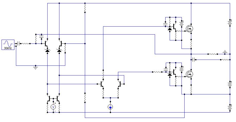

Thanks Tim for your schematic I dont feel that your toplolgy will work I did ask for 30 watts or more !
I have got a problem with my scanner at the moment so can not put my proposed solution on as a schematic at this time !
However I will say that the inputs are a differantial pair with opto isolator transmitter diodes in the collectors these are then connected to totem pole darlington transistors with the receiver transistors connected to the bases of the darlingtons
I will try to get this on line this weekend !!!
I must stress I have not yet made the amp its only a design exercise at the moment
there will be stability problems to be sorted I am sure !
At this time I must say I had not thought of the solution when the challange was made but must say I have been stimulated via the challange to think about it on my dailey 3 hour commute to work and back
regards Trevor

I beg to differ, by design it's trivial to take a differential output from the second stage and use a push-pull class-ab output stage.
I did say the output stage needed revamping, being only one of the simplest NPN followers possible.
There nothing stopping it from going within a couple volts of either rail.

Please do not get me wronge I am not Knocking your design
However I feel that to get a practical design your output stage leaves somethingto be desired ! From what I can see it would have to be class A. Nice but not practical , now if it was Ab that would be a different thing!
The front end and driver of your design is ok, but as I see it would be the driver outputstage where we have a problem .
Please think again you at least have the courage to put your ideas forward for which I thank you .
The Idea is to see where an alternative/restrictive design concept would get us
Regards Trev

Really guys, there's a ton of designs that fill this requirement.
The stupidest of them would be the Son of Zen - just throw some feedback around it for a distortion spec.
Other ones? Balanced versions of the PLH, ZV4 or ZV9, without the coupling caps.
Don't like that? I have a swell circlotron...
Workhorse I like your solution I thik it has potential !!! You have implimented a solution at the front end that to be honest I dont think I would have come up with .
Sorry I called you Trojan erliear got a little confused with your label.

latala said:Workhorse I like your solution I thik it has potential !!! You have implimented a solution at the front end that to be honest I dont think I would have come up with .
I just accepted your challenge and now rest is history.🙂
I like it, looks like mine but without the first stage and without component values to expose its lack of polish.
