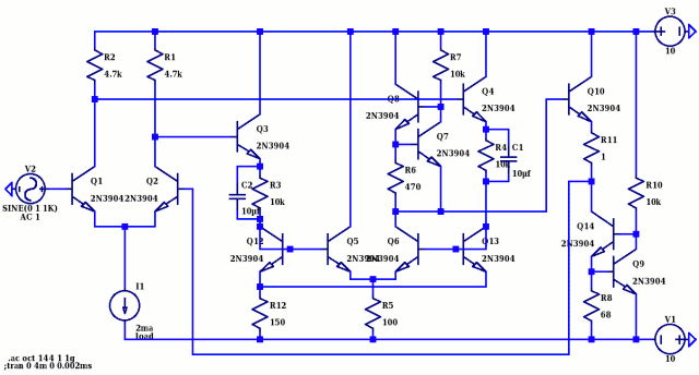

Whoop, this is the result of ten minutes. The output stage could be drastically improved and scaled for a typical load, but that's the easy part, this is just an example topology.
Around 40db open loop DC gain climbing to 80 some db, currently uncompensated and marginally stable with a 260mhz gbw.

By NPN only, are you being literal in that you only want NPNs as in bipolar NPNs, or does that also include N-type FET devices? If so, here's a concept for you.

It was an LT Spice simulation file, earlier I wasn't on a computer with image editing software installed.
Obviously I ignored the power goal, and only focused on making a workable topology with only NPN devices, I chose to go DC coupled throughout including the input. The two caps in the second stage serve only to enhance AC gain, there is still considerable DC gain and complete control of the output stage down to DC.
