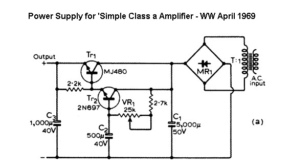

In the power supply of his first amplifier (model 1969), Linsley Hood himself used an electronic filter to obtain acceptable ripple.

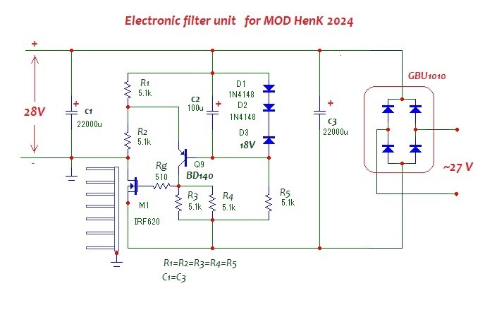

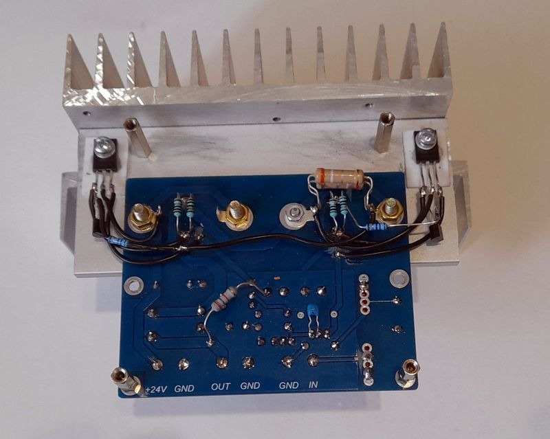

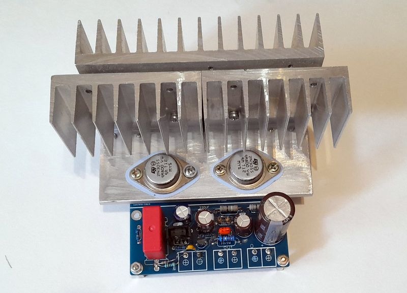

I also decided to use this device so that I could use higher voltage transformers, I have an unused 27 volt secondary transformer, so I decided to make an electronic filter circuit for it that could work on a high-rated capacitance.
Also, this solution makes it possible to avoid isolating the power mosfet drain from the cooling radiator, which is fixed to the chassis of the case and connected to the GND.
electronic filter circuit:
it is also a stabilizer; the voltage can be selected either by a zener diode or by the number of diodes in the D1D2 circuit.
The electronic filter-stabilizer is assembled using resistors of equal value, except for the resistor in the power Mosfet gate.
Later I’ll try to use, for example, the more powerful IRF1018 instead of the power mosfet IRF620.

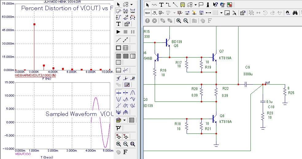

Hennady, an interesting improvement to such a well-known scheme. I have not yet analyzed its work in detail, but I would like to ask you - are the distortion figures given measured data or obtained using a simulator? It would be interesting to see the level and spectra of distortion at various output signal levels - from minimum to maximum (one step before the clipping occurs).

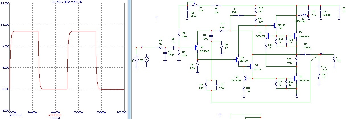

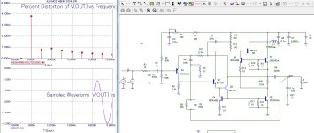

According to the diagram and measurements, everything is very simple - there was a video where a person measured distortions and spectra in real time in the laboratory, all parameters, all harmonics and their level were visible, there was also a dependence of the growth of harmonics on the output power, in the original version at the input amplitude voltage +/-9 volts at a load of 8 ohms at 1 kHz showed 0.4% of the second hamonics, which was also confirmed by my simulator. Having increased the maximum power due to modification - at an amplitude output voltage of +/-9 volts at an 8-ohm load, the distortion at a frequency of 1 kHz was 0.04%.Hennady, an interesting improvement to such a well-known scheme. I have not yet analyzed its work in detail, but I would like to ask you - are the distortion figures given measured data or obtained using a simulator?
spectra with dominance of the second harmonic, the clip is symmetrical.It would be interesting to see the level and spectra of distortion at various output signal levels - from minimum to maximum (one step before the clipping occurs).

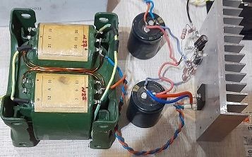

I am currently optimizing the design of cooling radiators, because... The temperature of the radiators above 52 degrees also affects the sound quality - i.e. While additional cooling is required (fan), the radiator is still being completed; in the convection form, the flat surface does not provide the necessary heat removal, so we make a U-shaped design of the radiators, and there is already a positive result.
Those. the result will be the optimal value of the radiator area and its design features to use only passive convection type of cooling.

What exactly is not clear? circuit clone of the original topology from 1969.In addition, it is not clear which circuit it refers to - you write that you modified the circuit.
data of course from simulator, I did not indicate anywhere that this was measured data. We were talking about measurements after manufacturing the amplifier; so far only the manufacturing process is underway.this is measured data or obtained in the simulator.
Will it be clear like this (see attachment) or does something need to be explained?is it possible to use KT819 in the output stage and how much will this worsen the parameters of the amplifier?
I don't really trust the simulation results. They are usually overpriced. In practice, other results may be obtained due to deviations in the parameters of the components used and other unaccounted factors.

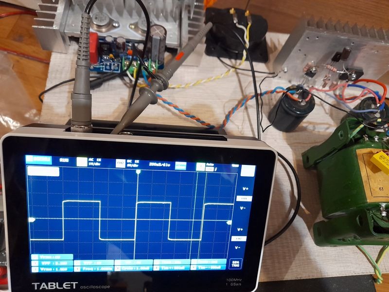

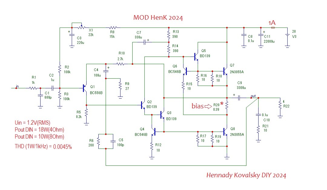

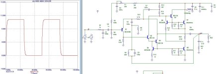

Finally, after much listening and 8 options for a set of compensation elements, I settled on what seemed to me the best in terms of subjective perception of sound.
The amplifier produces a slightly unusual sound, I would say an ambient sound.
The issue with temperature has also been resolved - in this design it is not necessary to make the current higher than 1 Ampere, because the power drops and it begins to sound less “light and powerful”...
With a current consumption of 1A and 28 volts of power supply for the amplifier, a convection cooling radiator of 900-1000 cm2 is sufficient. For Q5Q3 you need a separate radiator, I used a 300 cm2 radiator. which is secured together with a detachable heatsink for power transistors through thermally insulating gaskets.
According to the scheme :
It is with this circuit that the second channel will be completed and installed in the housing. A stabilizer on the Mosfet circuit will be used, which is available earlier in the topic. The voltage block will be 1 to 2 channels, (no dual mono).
Modification result:

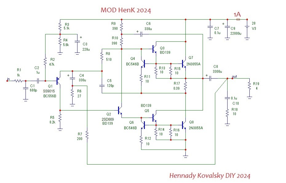

diagram in attachment:

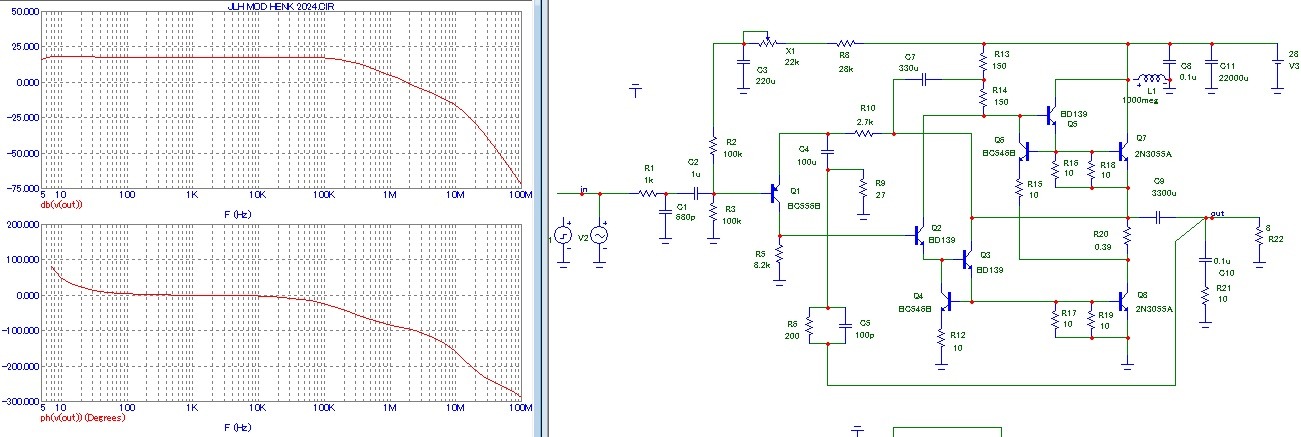

- R1С1 - frequency filter 225 kHz
- gain Q1 open loop 24dB
- gain Q2 open loop 40dB
- pole above 20kHz
- the value of capacitor C4 has been reduced to 100 μF so that it does not affect the phase distortion below 20 Hz, the cutoff frequency from below is now 10 Hz, i.e. 1 octave lower than 20 Hz, which is good.
- setting the Current or increasing it can be done by selecting resistor R20, you can simply solder an equal value of Resistor in parallel, a lower resistance corresponds to an increase in current
- X1 - configures symmetrical signal limiting at a frequency of 1 kHz. (approximately X1+15 kOhm = 28 kOhm).
- minimal changes to the original version
- ultralinearity preserved
- increased output power
- it became possible to use speaker systems with an impedance of 4 ohms without increasing the current.
- good transient response
- less dependence of sound on the set current
- less thermal load on the amplifier elements

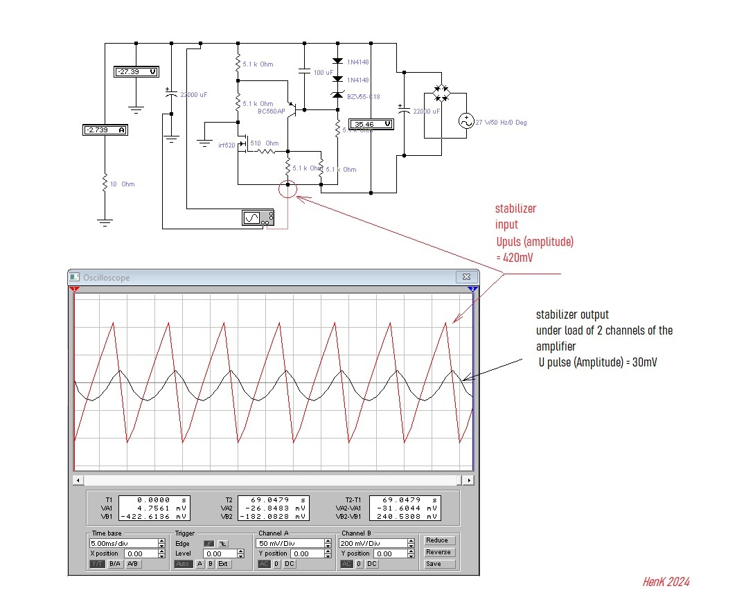

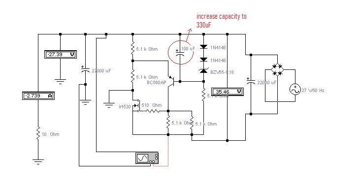

Let's evaluate the contribution of the stabilizer and rectifier capacitors to minimize the ripple voltage to power the amplifier.
The need to reduce supply voltage ripple is associated with the possibility of obtaining low distortion at the first watt, in our case this is 0.005% distortion percentage.
I typed a stabilizer circuit and a rectifier connection circuit with a load equivalent to the load of 2 amplifier channels.
As a result, the stabilizer reduced ripple by 11.5 dB for two amplifier channels.
Let's try to reduce this level of pulsation, to be continued....

Of all the possible options, without significantly complicating the circuit, increasing efficiency is to increase the capacitance in the base of the bipolar transistor from 100 uF to 330 uF (see attachment). This allows the stabilizer to reduce the level of supply voltage ripple by 20 dB when feeding through it 2 channels of amplifiers in class A at once.
If anyone has any ideas, please suggest them, we can check what the result might be.

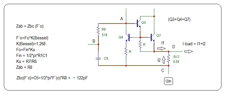

Hi all!
Today I decided to finish the issue with compensation, because... a capacitor shunting a negative feedback resistor is not compensation in general terms, because This capacitor makes the feedback resistor frequency dependent at high frequencies and load impedance, and its presence also increases sensitivity to the wires that connect the speaker systems.
Therefore, I decided to completely redo the compensation.
Because we have a cascade of transistors Q3 Q4 Q7 is a controlled current load for transistor Q8 it is logical to use a “current compensation bridge”, the circuit for this compensation looks like this:
The figure shows the formulas for calculating the compensation capacitor C5.

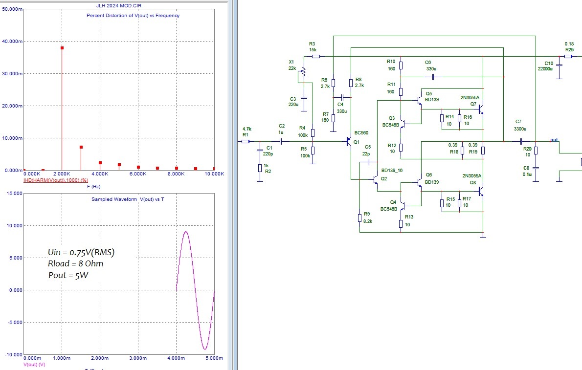

You can also see that I rebuilt 2 nodes in the amplifier
this current communication circuit P8 is now taken from Collector Q2, the reason is to reduce the current modulation when operating the stage Q3 Q4 Q7 to the input stage through the emitter Q1, the base current Q3 is sufficient to stabilize the operating point at the output of the amplifier.
Changing the current feedback connection point made it possible to use the R3R4 divider to form a symmetrical operating point, which will not depend on the supply voltage and current setting of the power transistors. Thus, there is no need to adjust the operating voltage at the amplifier output; it will be set automatically regardless of the supply voltage level.
C4 with a nominal value of 330 uF returned to its place, after changing the point of connection of the current feedback, phase distortions at infra-low frequencies no longer appear and increasing this capacitance significantly reduces distortions in the mid-frequency band.
The circuit is assembled and now it reproduces for me - everything sounds very good, clean and powerful, and this is the result for distortion:
Please note this distortion is at a frequency of 20 kHz, where the influence of the compensation bridge is maximum.
