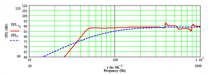

Henkjan's easter project 2010 - compact horn/BR with Alpair6
I have to say they look great!
Ideas like this have popped into my head, but i hadnt messed with the raw math enough to try, other than in hornresp. im sure its possible to sim it.
I would love to try and do a version for the alpair5 that i have, I might get the paper and calculator out 😀
What would be the effect of increasing the ratio of A1 and A2 further, ie a greater expansion of the port?
I have been toying with a old school reflex design where vent area= Sd, the simple port tuning so to speak, but and expanding port may be a great way of doing something a bit more unusual...
if you increase the A1/A2 ratio, it will be moving more towards a 'normal' horn and less like a BR.
For the A5 this might be difficult, because of the rather high Qt of the A5. A good starting point would be if you can make it work in a normal BR, and then move towards the horn/BR
