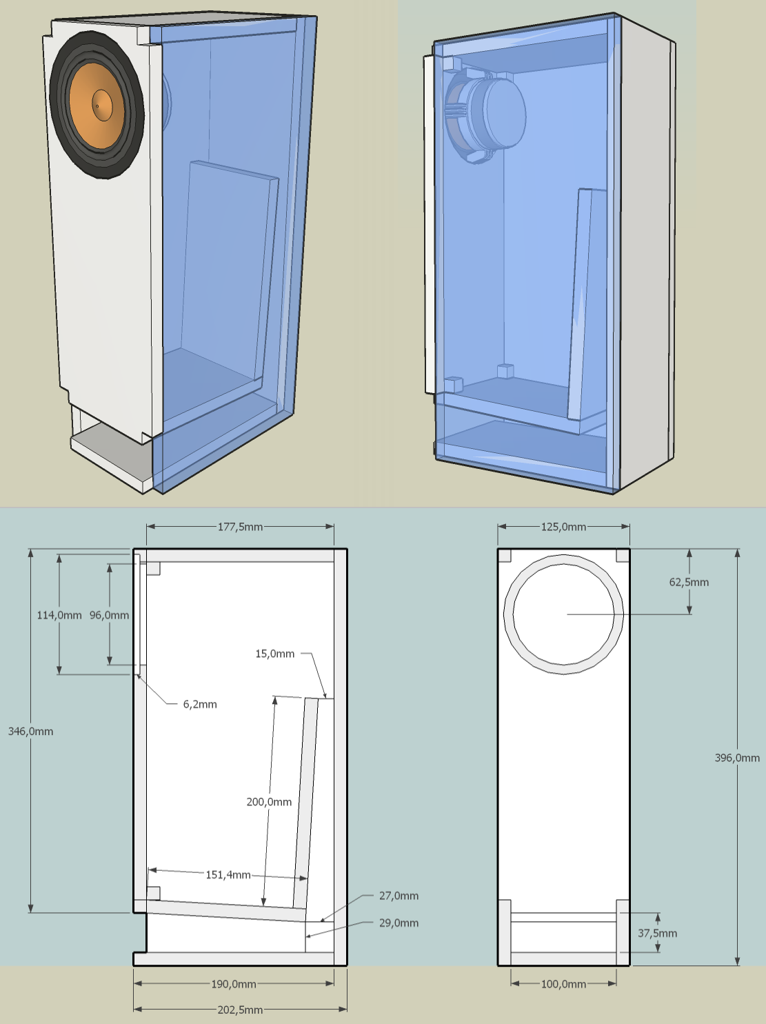

~50HzWhat's the bass extension on these?

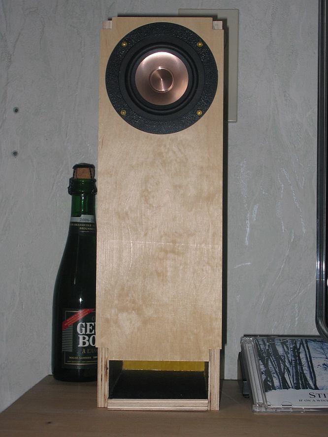

I have to say they look great!

What would be the effect of increasing the ratio of A1 and A2 further, ie a greater expansion of the port?
I have been toying with a old school reflex design where vent area= Sd, the simple port tuning so to speak, but and expanding port may be a great way of doing something a bit more unusual...
if you increase the A1/A2 ratio, it will be moving more towards a 'normal' horn and less like a BR.
For the A5 this might be difficult, because of the rather high Qt of the A5. A good starting point would be if you can make it work in a normal BR, and then move towards the horn/BR
~50Hz
wow 50hz for a paper 3". I was debating between the 6M and the chr70; 6M looks impressive but I'm guessing the larger driver goes much louder.
