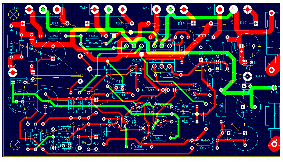

I have also been busy doing a tentative board layout. As pictured below, it is 191mm x 62mm and includes all power supply components. One of the things I learned recently, is to give myself a little more space on the board, not to pack it in so tight. Still, I have managed a fairly compact design.
On this layout, I have the Vbe multiplier transistor sharing a small heatsink with the VAS and drivers. Is this ok for thermal tracking?

Hi MJL21193,
Regarding layout:
How about running the (-) rail trace that supply the power transistors on the top board edge. Then you will have much less magnetic fields affecting lower level stages.
And of course beefier rail traces, but I guess that you are early in design and just laying out traces for later fine tuning.
Thoughts?

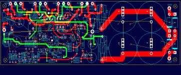

Hi 4fun,
I have the output transistors on the edge of the board, mounted vertical. This doesn't leave any room. If I move them inwards, it will be a problem for mounting on the heatsink. Besides, not much of it is close to small signal area.
I consider this layout close to being final. I'm looking for suggestions, such as yours, to improve it.
I have a better pic below, showing the "business" section only. Note that power ground throughout the board is not connected, as I'll do a poured ground plain on the top (green)
Yes, current power traces is fairly away from low levels. I can alo spot short path for the power ground and hopefully no small signal areas surrounded by high current ground traces. 😉

...short path for the power ground and hopefully no small signal areas surrounded by high current ground traces. 😉
What do you think of a poured ground plain on the top side of the board? Signal ground is seperate from power ground.
Why not, as long as there is no serious interruptions (cutouts for other traces) from the shortest path where high current flows.
I think a true ground plane is more predictable (where there may only be holes for component leads)
In a ground plane that has interruptions there may be necessary to have some stub areas in order to prevent loops. I once experienced this when designing a 10-channel video amp (some ground trace cutting necessary)
I have limited experience of ground planes so I better stop here. 🙂
Some rambling: Let’s suppose we have two wide traces where high ripple current flows and we connect a decoupling cap to the edges somewhere along these traces. Now, how much current will go through the cap and how much will bypass it in these wide traces (that has some inevitable resistance)? I think we must make sure that as much current as possible goes through the cap (pad) and not around it, at least if we want just decoupling.
I will be interesting to se your futher progress and finally end result with possibly real life measurements.
