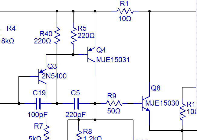

Dear MJL21193,
Changing the Miller-cap to a two-pole compensation (see Slone) would decrease that 0.05%/20kHz THD to about 0.005%.
Worth to try.
Best regards,
Thanks Donk,
It reduced 20KHz distortion at 150 watts from .048 to .011 and at 4 watts from .017 to .001.
Do you have anymore good ideas? 🙂
I will implement this and post a full revised schematic shortly. In the meantime, here's how I did it:
Look at the values, especially R40. Is tis too low?

MJL21193 said:
Thanks Donk,
Move the right hand side of C5 to the output feedback point to include the output stage in the Miller loop. Stability analysis is now even more important.

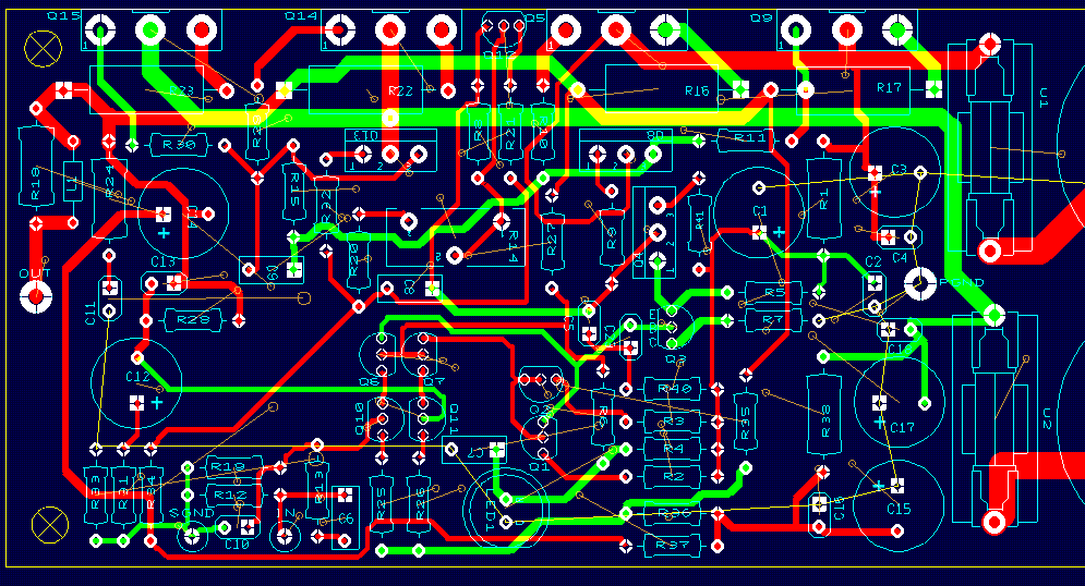

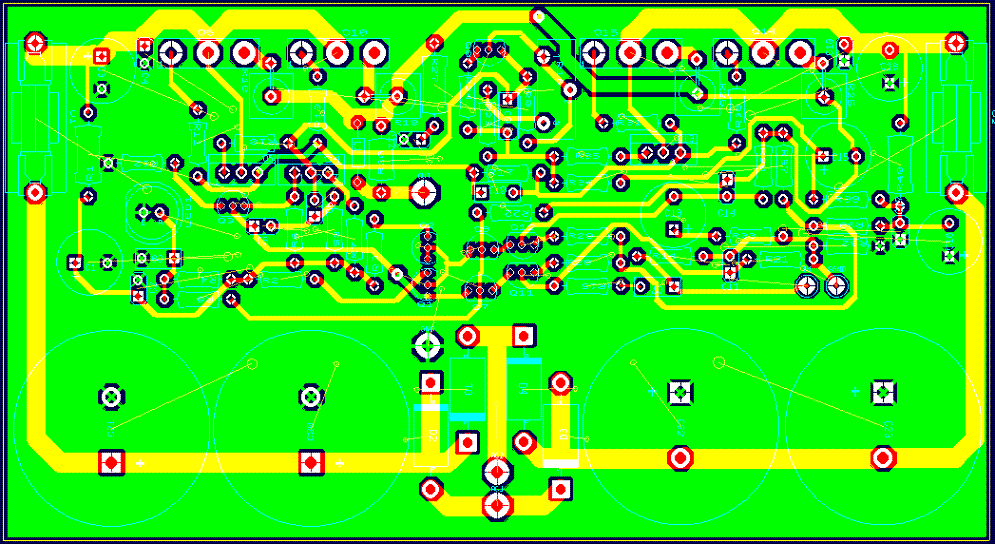

Here's a board layout. Power ground is not connected as this will be poured on the top layer (green).
Comments/opinions are welcome.

MJL21193 said:
protection. Is this fuses only, or do you mean a more active approach? I will have a sub-circuit board with the output relays and fuses.
IV protection on the output for short term transient, supply rail fuses for the medium term. You've already looked at that EF between LTP & VAS.

Any thoughts or comments on my board layout? I have the differential inputs as separate Q's on the boards to provide more flexibility for device selection. I'm assuming that the LM394 has leads long enough to bend to match this pin-out.
Hi John,
Yes Q3 acts as a buffer.
The LM394s that I've used had about .5" leads, the pin out is in the data sheet of course. Two Q's back to back is fine, usually the flat sides would go face to face and you can put a tie wrap around them with a dab of thermal grease to keep them coupled. You may want to do some economy versions without the dual, this makes sense. I'm not sure if the LM394 will match up in any simple way if you do this, you could have two different positions and just populate whichever you use.
About your layout, have you read much about it?
Here are a few papers:
http://www.analog.com/library/analogdialogue/archives/39-09/layout.pdf
http://www.analog.com/UploadedFiles....aspx?url=http://www.analog.com/UploadedFiles
http://www.analog.com/UploadedFiles...g.com/UploadedFiles/Application_Notes/5008249
http://www.hottconsultants.com/pdf_files/june2001pcd_mixedsignal.pdf
Does this inspire you at all as far as neatness goes:
http://www.diyaudio.com/forums/attachment.php?s=&postid=614697&stamp=1112913063
I've not spent too long looking at your layout, I'd want a heat sink for the VAS and drivers, I think you said you had one, but just to be sure.
Careful how you pick off the feedback point, Self talks about this.
Many have commented, including Cherry, Self, and others, about how routing can impact distortion at these very low levels. Chassis grounding is very important, however you've got almost everything on the board which is good.
Keep high current traces away from low level traces, keep high current loops as short as possible.
It's good that you have the PSU caps and diodes on the board as it keeps the traces short. The junction of the PSU caps and the transformer center tap is the single point high current ground. Think of how the current flows in your design.
It would probably be helpful to have a few of the layout experts look over your next cut.

Hi Pete,
Thanks for the references, I need all the help I can get.
The pinout of the TO-5 LM394 is two TO-92's back to front, so that's how I have it on the board.
The board... I have been further refining it, moving components, trying to get as neat and simple as possible. But, as usual, I can't see everything. Help here from other, more experienced members, would be appreciated.
At one point I was tempted to scrap the whole layout, go back to the schematic and add 2 more pairs of output devices (as a higher output option - the sub amp looked at earlier). I may still do this, though it would increase the boards size quite a bit.

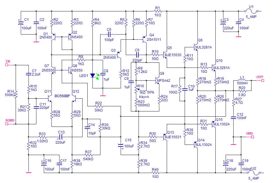

The final schematic update? Maybe.
Not much in the way of changes - tidied up the two-pole compensation and swapped the VAS for the 2SA1011.
I still haven't started to prototype this design but have been steady working on a board layout. Maybe a bit of "putting the cart before the horse".

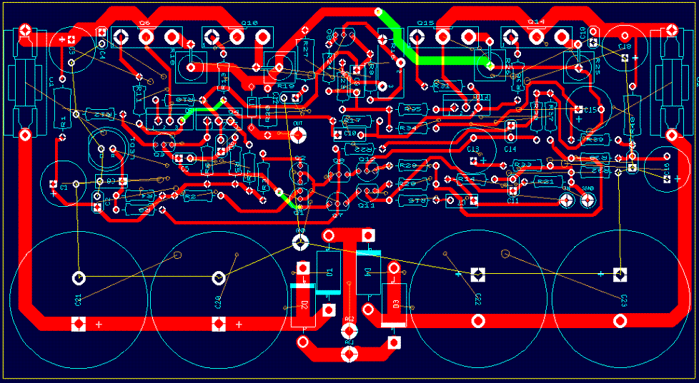

The latest board layout. Much improved over the previous efforts, with most of the routing on the bottom. The layout also follows the schematic, making for a more logical placement of components.
As recommended earlier, I've allowed space behind the output devices for routing of the power traces. I will attach these transistors to a thick copper heatspreader, which will be bolted to the heatsink.
