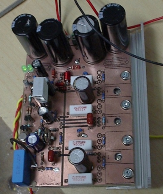

Here's a pic of the completed amp (actually in operation!).

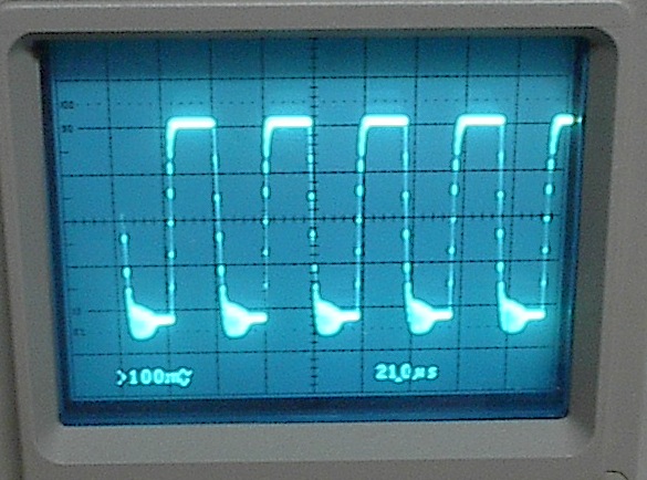

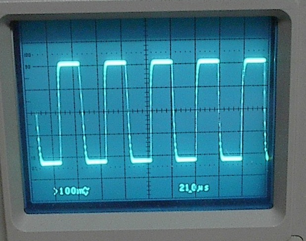

I have a couple of photos to share. The first is the output from the amp with a 20KHz squarewave, running with about 6mA idle current. Higher idle current was giving some ringing at the bottom half of the wave. I will get a shot of it running "normal" idle later, after it cools down a bit (gets REALLY hot amplifying this signal at full input, the reason I had to shut down).

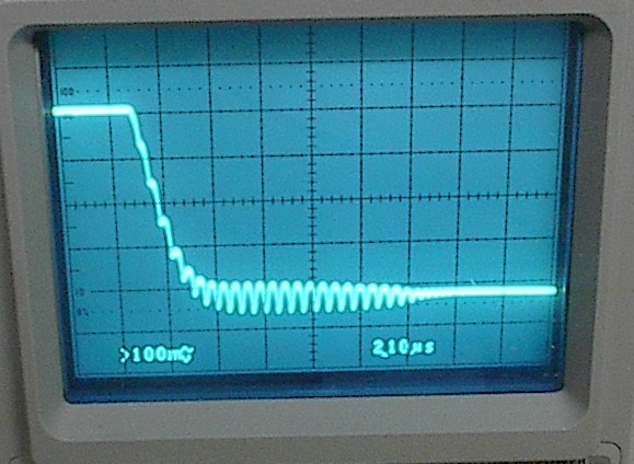

And here's the same with the 15X magification. Notice there is still some evedence of ringing in the botton half of the wave.
Otherwise, I am impressed! This is much better than I thougth it would be - proving out the simulator yet again.

Here's the amp running at about 60mA idle. Notice the ringing at the bottom. This is just waiting for the opportunity to break into full scale 1MHz oscilation...
Ideas?

Try increasing the values of the emitter resistors to 0.47 Ohms or even 0.68 Ohms also move the zobel to after the inductor and check again for oscillation. Increasing the emitter resistor will provide a little more local feed-back. It will not change your output impedance by much.
Hi Nico,
The magnified scale is 2.1uS. When I say 1MHz, that's really a ballpark figure. I'd like to know if it's possible that this is the result of parasitic inductance/capacitance between the output trace and the negative rail.

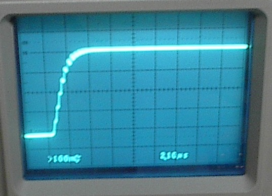

Here's a shot of the top half of the wave magnified 10X. No ringing.
