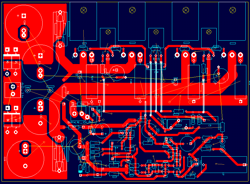

I have made some changes, taken Nico's advice and re-arranged the outputs and a few other places. A big change already.
I have printed a full size copy and checked the component sizes and placement - everything looks good. This gives me a board that is 122mm x 168mm (4.8" x 6.6"). With some creative cutting I can get 4 of these out of a 12" x 12" board.
I have many pieces of aluminum, both plate and angle in various thicknesses. I'll start with a thinner one.
BEAUTIFUL! That is a monster board. Angle of about 3mm thickness should be mechanically quit rigid and will make a good mounting bracket to the heat sink.
You should also start considering your chassis design at this time so that you don't end up with a PCB that fouls with the transformer and other internals. So sketch a bit before you make the final boards else you may be very annoyed (as I have been many times) when things don't go together as planned.
Nico
Hi Nico,
I have some chassis ideas in mind, and a big one doesn't bother me. I have another project that I'm doing here , where I'll be building a new case. I'll make both to match
I have looked the board layout over and haven't found any faults (maybe my layout skills are improving 🙂 ). I may take the big step this weekend and etch these boards, using the 2 ounce copper boards.

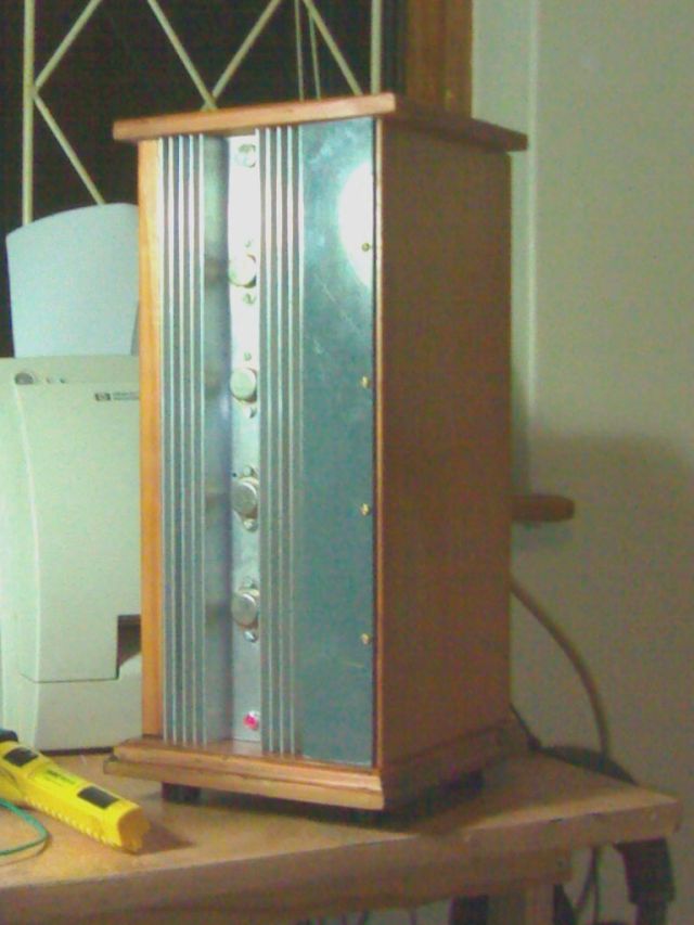

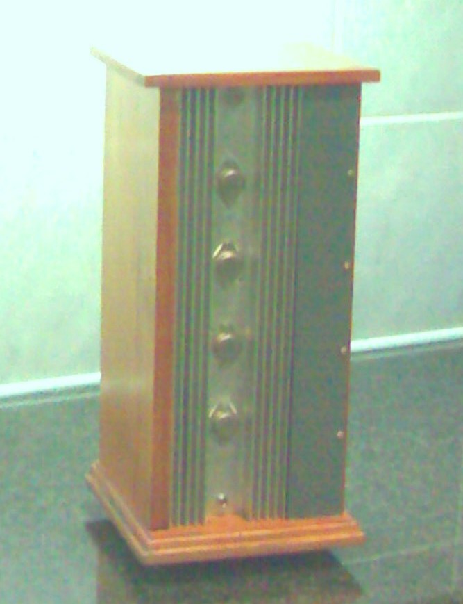

Hi John,
I just completed my 12 watt/ch SE class A by modifying the headphone amp. I post a picture maybe give you an idea of a different type box. I made two mono-blocks each can stand next to its speaker. In case you wonder, that is actually a butchered CD rack. Not bad, yes?
Kind regards
Nico

Nico Ras said:
Hi John,
Kind regards
Nico
Very nice Nico! You are very productive, you make me jealous🙂
I struggle to get one project done, while you finish 10! I see TO-3's, what outputs are you using on those?

Here is the copper bottom for the final board layout. I have compacted it slightly and checked it over for mistakes.
Board is 165mm x 113mm (6.5" x 4.45").
To scale print, pin spacing on C7 is 27.5mm
