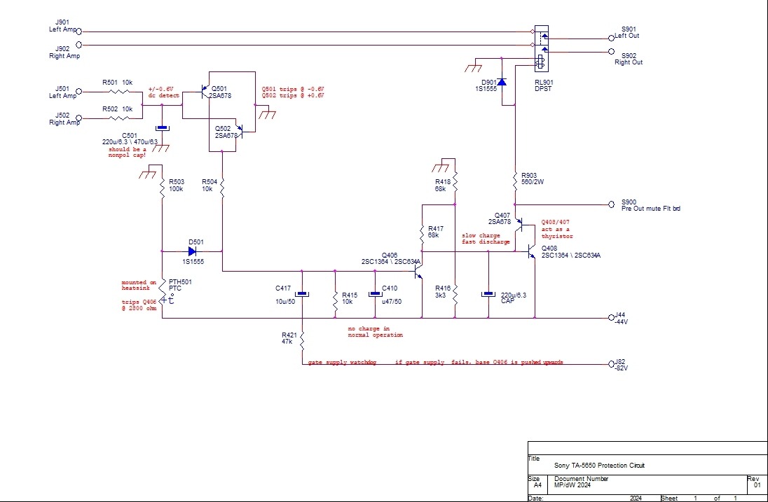

The C417/R421 combo should prevent this. C417 is 'large' (10μF) to span this time. With a 50V spec, this can become a suspect after some time. Better repalace with 10μF/100V tropic (105°C) grade.the relay coil again get energize a few seconds

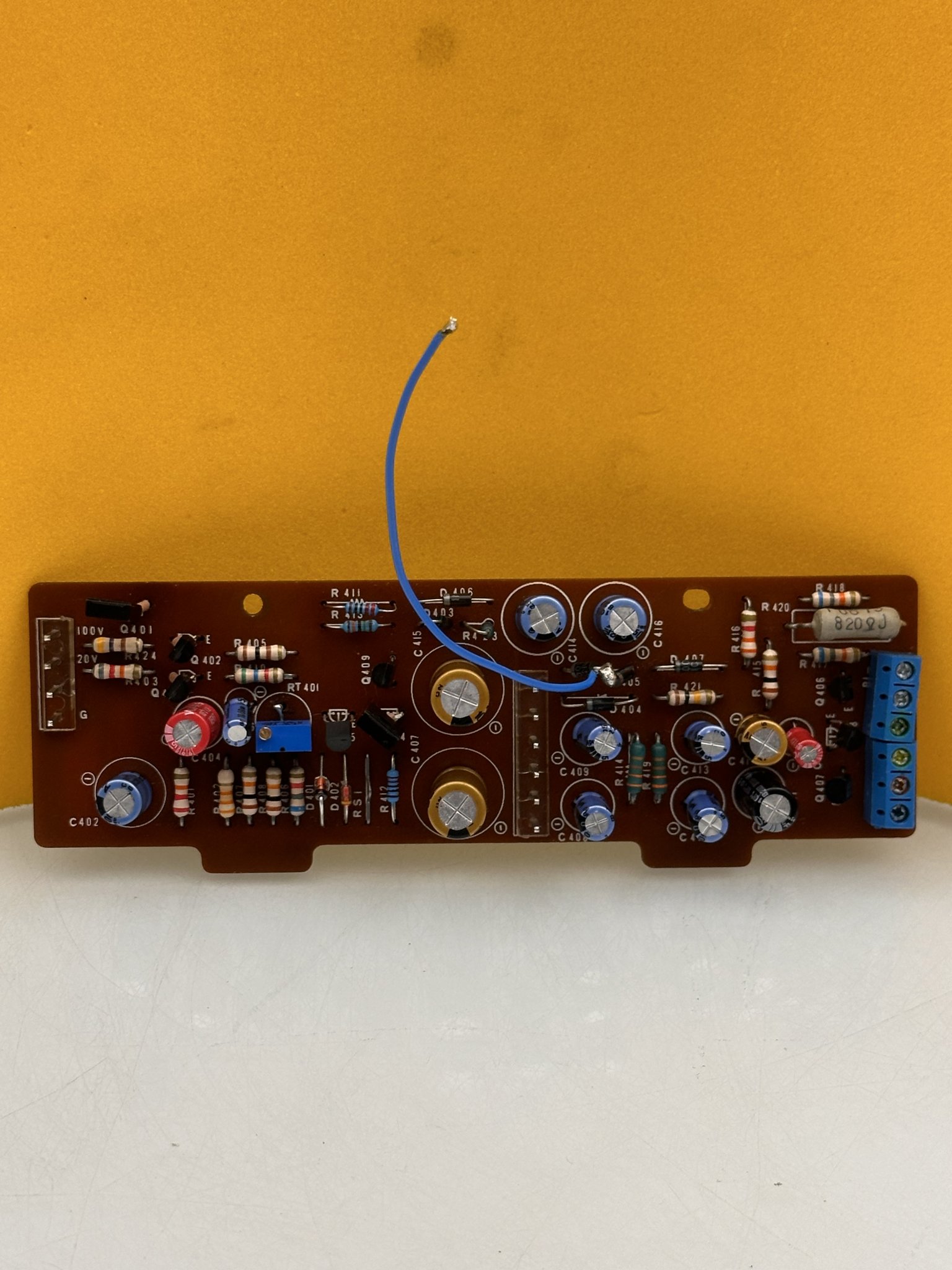

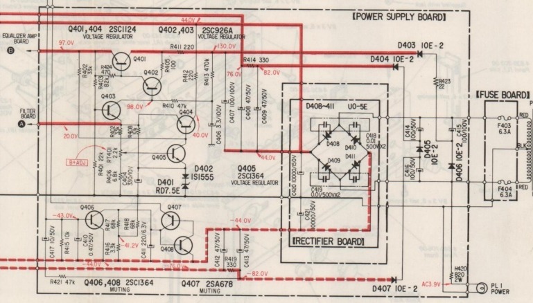

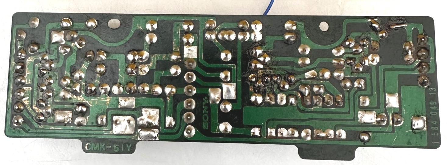

I think I have a later production SONY TA 5650 On the power supply board there is an additional JFET transistor marked Q 409 2SK23A what is the purpose of this JFET? The service manual I have does not show this transistor on the power supply board . When I was rebuilding my TA 5650 Power supply board I replaced all the electrolytic caps and transistors on it . The transistors I replaced: The 2sk23a JFET I replaced with NTE 312, the 2x C1124 with BD 139G , 2x C1364 with 2x NTE 293 .

I really applaud you for the great very easy to follow diagram much easier to understand than the service manual and your great explanation how the protection circuit works in this amp !🙏👍😊

Huh???there is an additional JFET transistor marked Q 409 2SK23A
I have several service manuals, drawings and pictures collected but none have a Q409 2SK23A Jfet in the power supply.
Sony did use these as a current source in several designs. But there is no good reason for a CS in the 4650/5650 power supply.

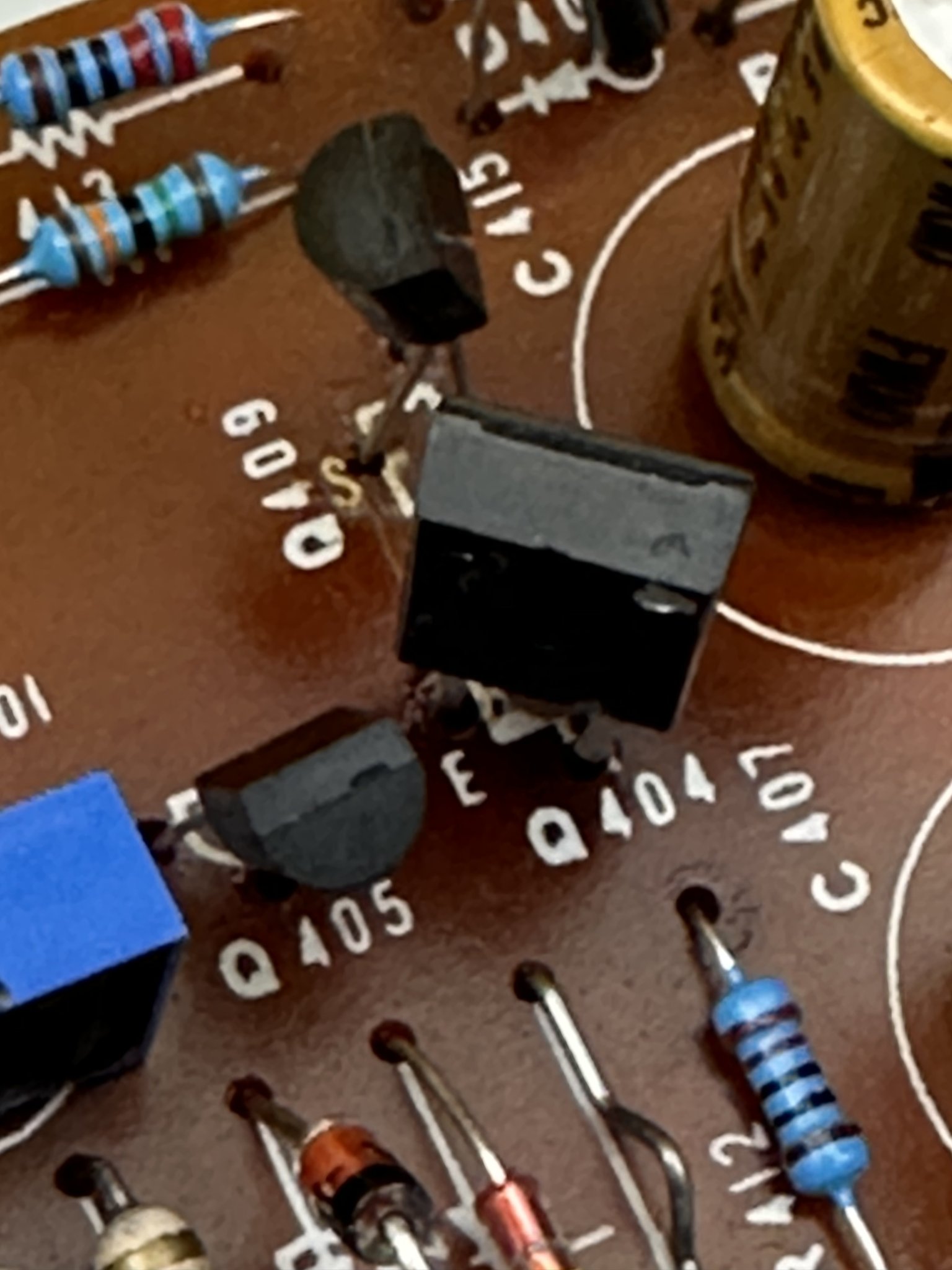

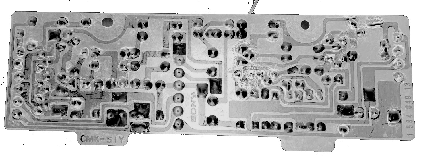

Being very curious, can you post a picture of it (both top & btm sides)?

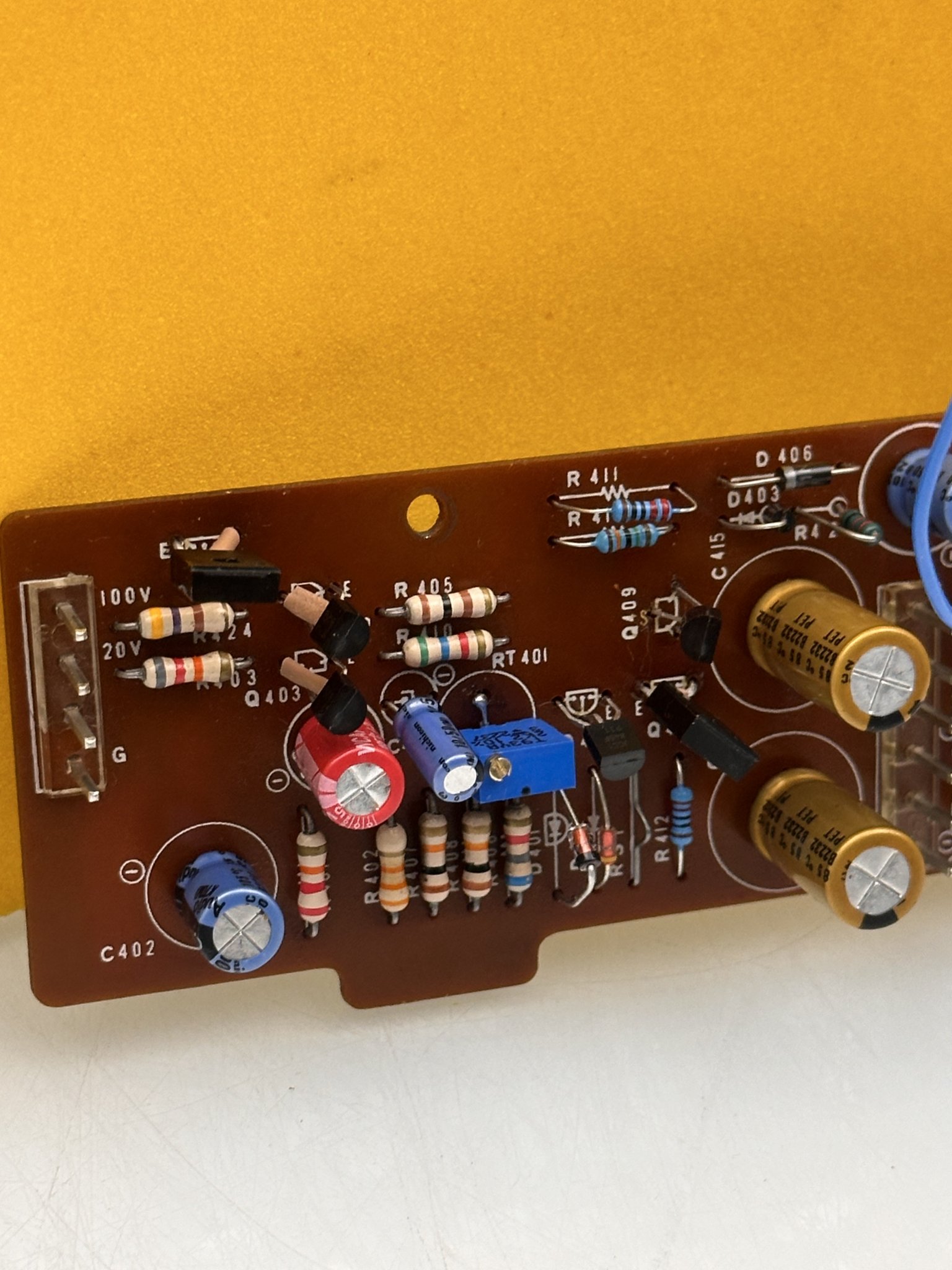

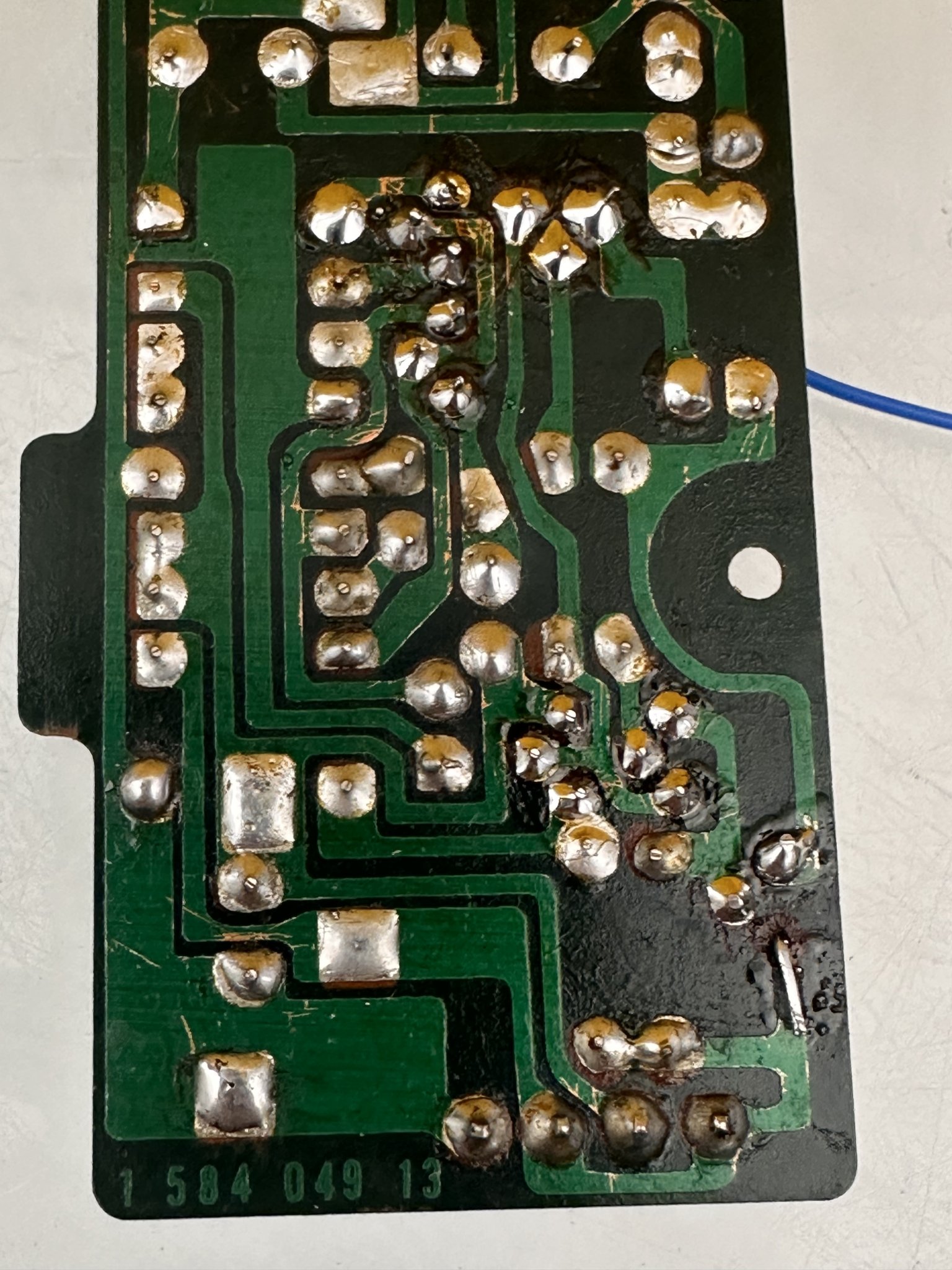

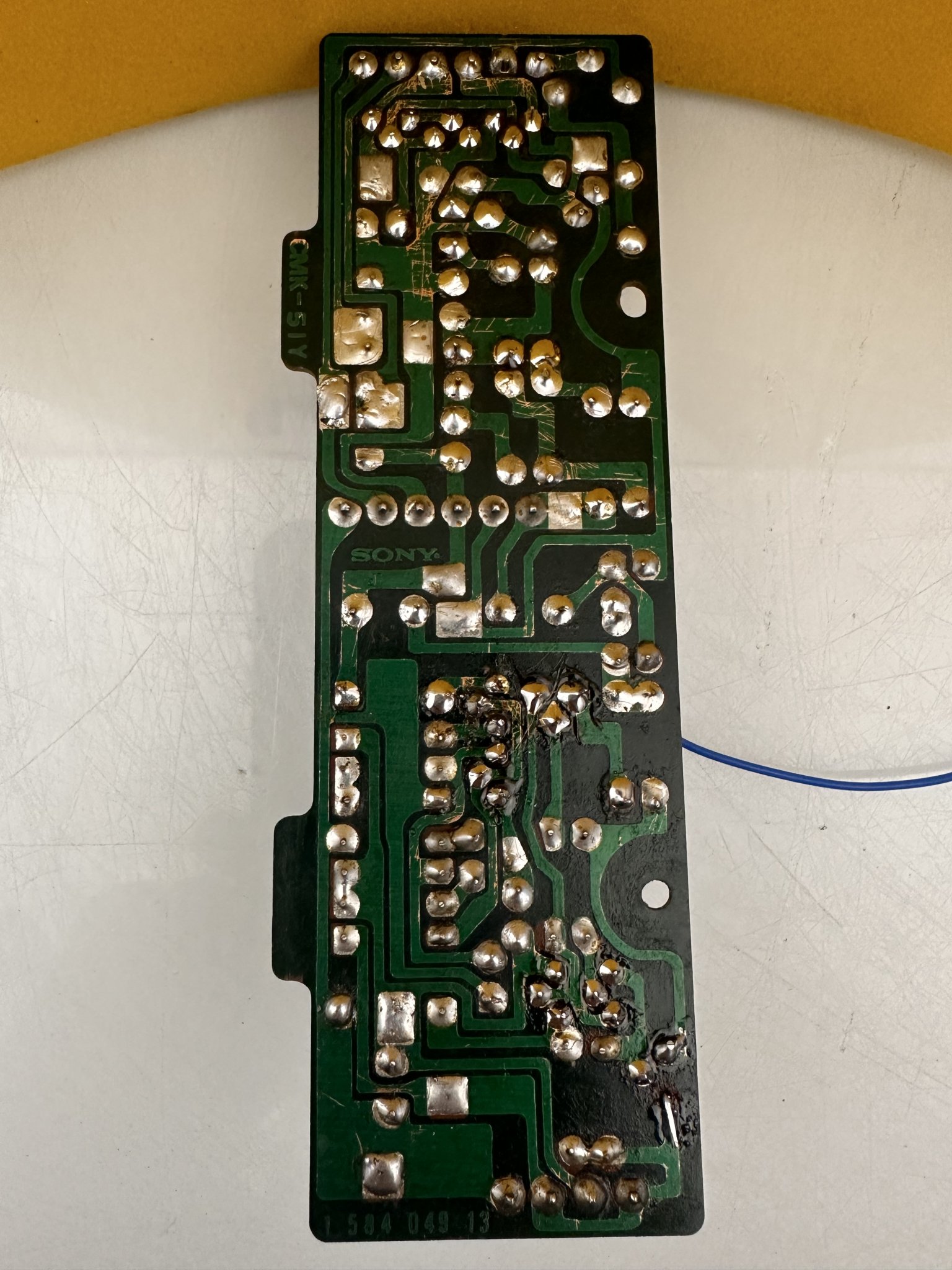

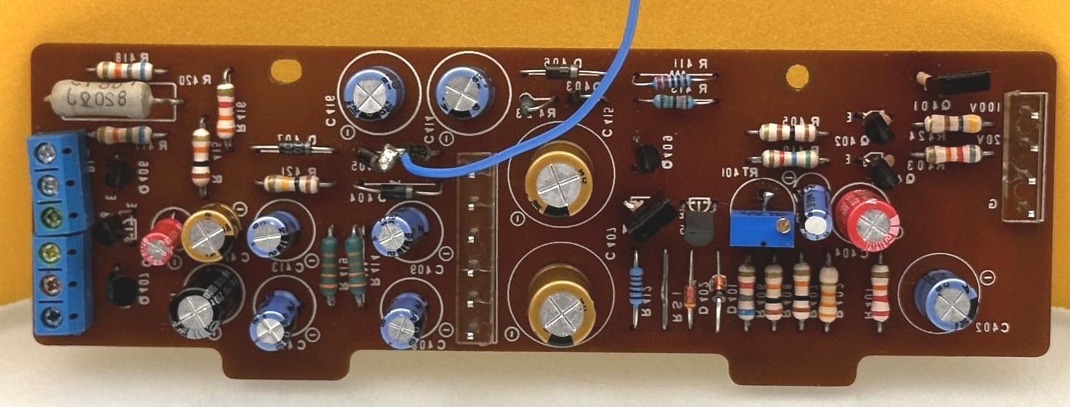

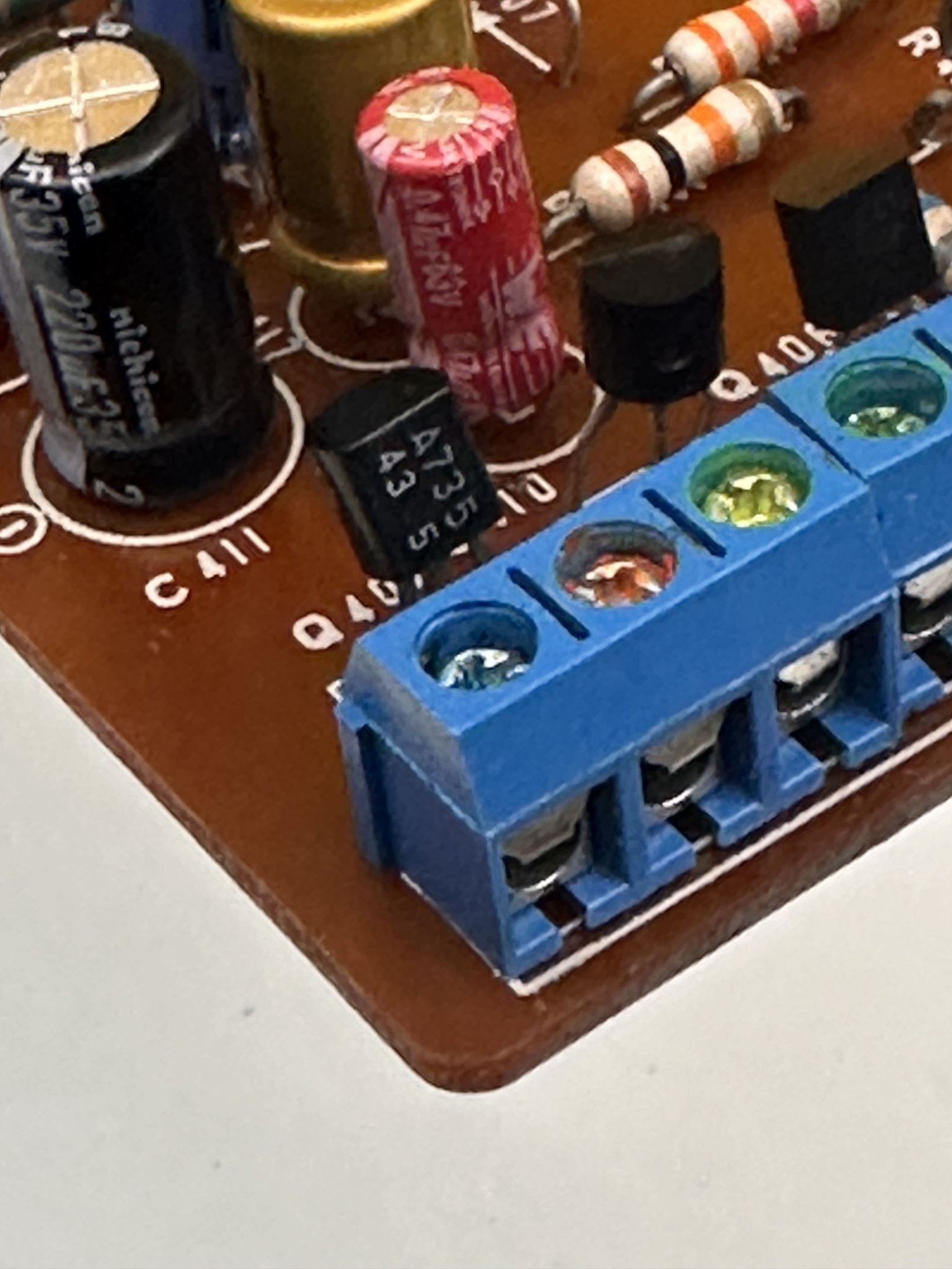

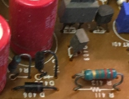

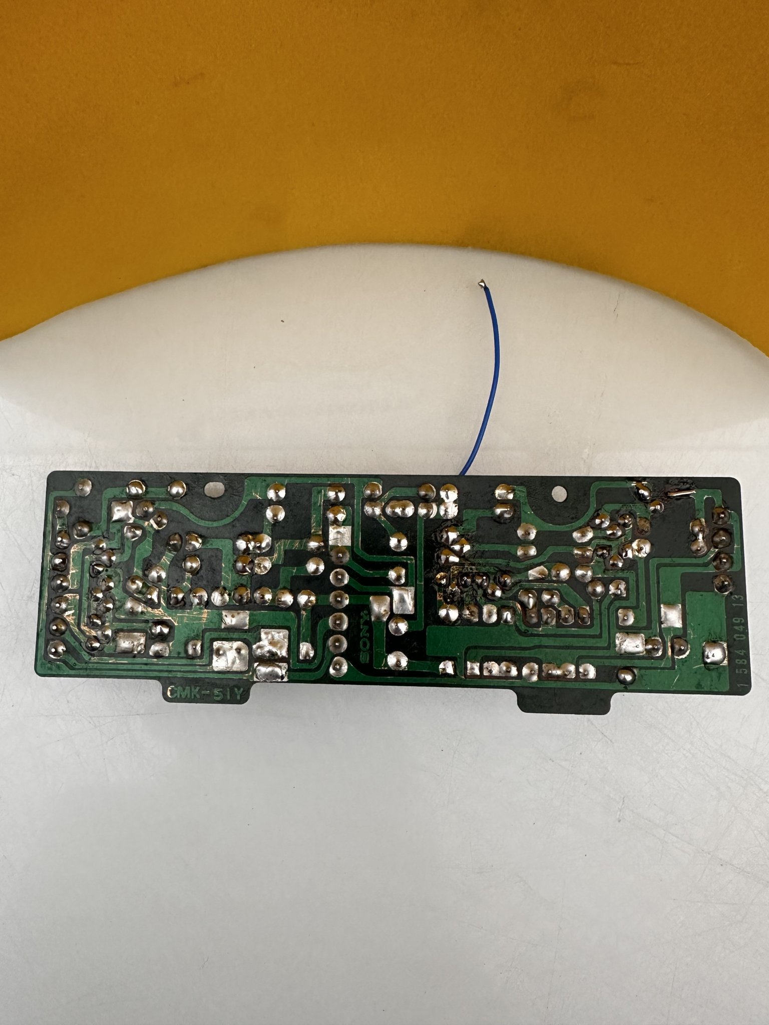

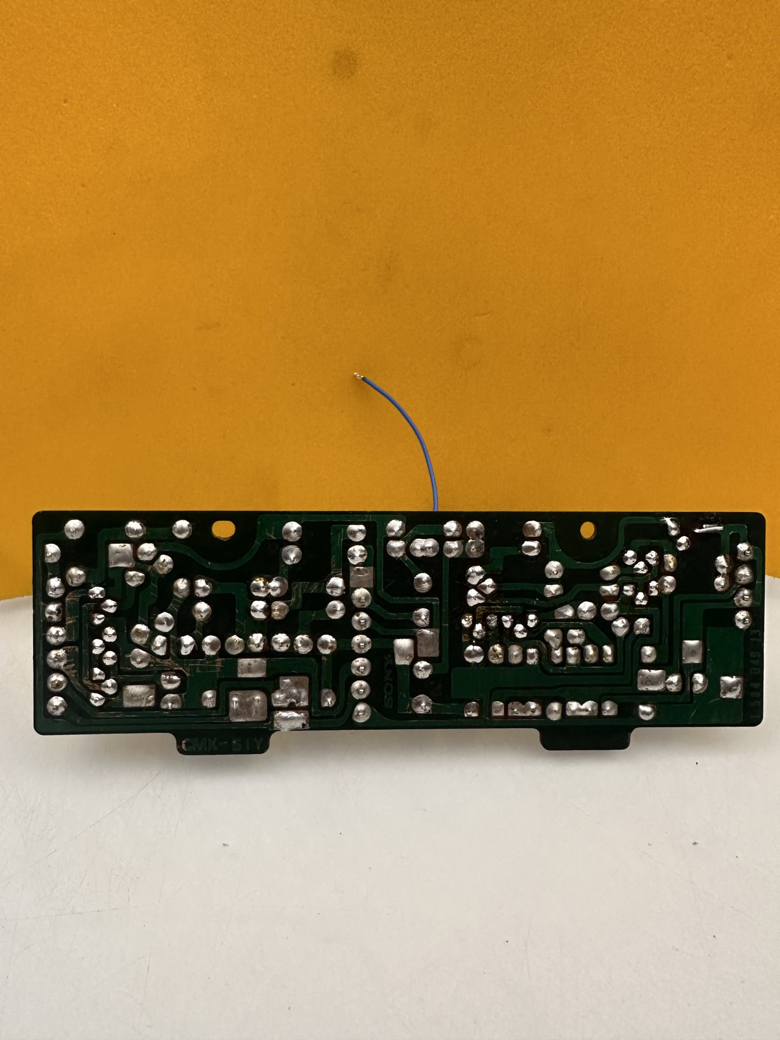

Hi citizen , here are the pics of the power supply board I replaced some the the transistors recently with better ones! All are new except the A735 do you know a sub for this one ? The Q 409 was a heft 2sk42 not 2sk23a looking from front of this transistor the pins allocation were GSD GATE , SUPPLY, DRAIN I replaced it with J113 jfet with pinout DSG you can see it in the pics . With new close orig specs transistors the relays no longer engage for few secs after pwr to the amp is shut off . Now what happens is that after the first time you install one channel FETs the relay engages but when you turn up volume it disengages if you lower the volume very low like at 7 -8 clock position the relay again engages but again disengages of volume is increased and after that it stay disengaged unless you remove the FETs without FETs everything seem perfect gate ,source voltages at VFET sockets are all correct ! I am thinking removing the 68 ohms/5w protection resistors one each in series in the +- 44dc power supply line to the power board to protect the VFETs from drawing excess current in case there is problem with the repair and hence saving them from destruction! I am thinking the resistors are limiting the current to VFETs hence the relay disengages when volume is increased . With the new better specs transistors in power supply board these protection resistor no longer get hot . What is your expert advice as to what might be happening when VFETs are installed for the relay to disengage ?
Alas... I knew these things in the 80's and 90's, but my knowledge is outdated. Other members here maybe?A735 do you know a sub for this one ?

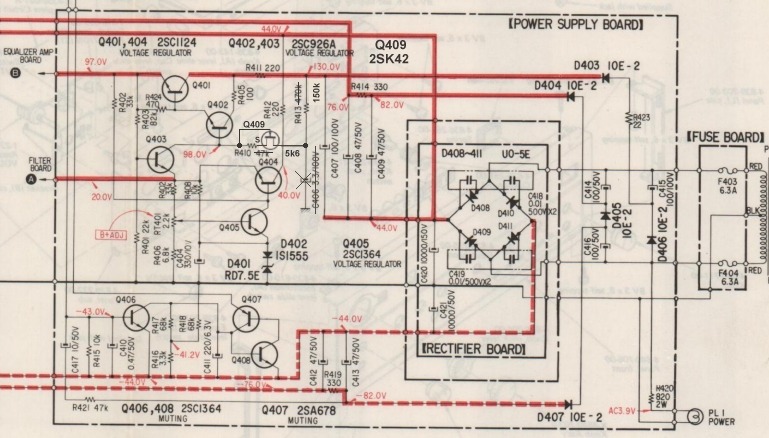

Ah, that's curious! The 2SK42 is a very low Vds type (10V!, Sony breed)), so odd to find it in the supply.Q 409 was a heft 2sk42 not 2sk23a

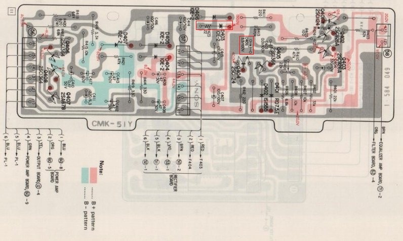

And on this supply, there's also this Q409.
But I have not found a circuit drawing or service manual where this J-fet appears.
Anyone out there???

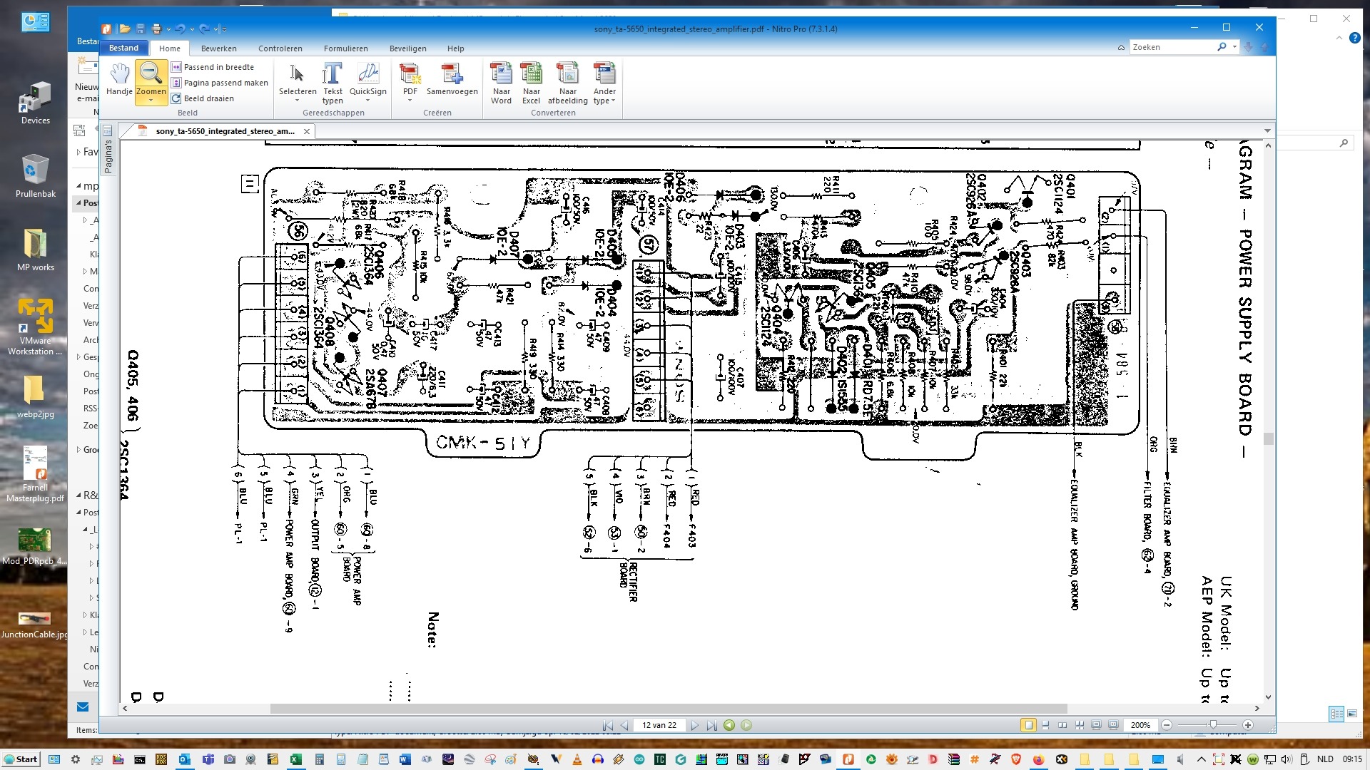

I'll try to reverse engineer that circuit diagram this week. Some manipulations with the pictures provided.
I guess it's used as a current source.

Yes, a current source.
