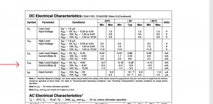

If you can get enough drive current from the 4017 and it works then I would say its OK. You are limited though to just a few milliamps.
Edit... the data sheet shows the official value to be small.

It's working fine so far. Even with indicator leds for the different inputs in the circuit as long as the resister is above about 600. I'm using 4.7k but may go higher as they're still a little too bright.
