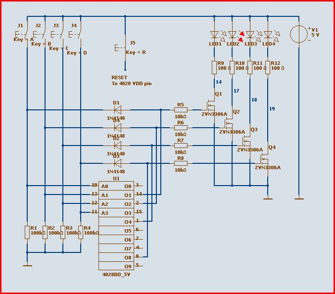

Here is another circuit that I think member Lineup posted years ago. I've never tried this one but it looks reasonable. This uses four buttons, one for each input.

Ok thanks for that. so I can use the 2003 in place of the individual transistors. So I'd have the 4017 as the counter and the 2003 would provide the current to drive the relays? If that's correct, that sounds like an ideal, simple solution.

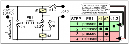

What would usually be done is a Ratchet Relay. Each pulse worked a rotary ratchet. Cams on the rotary shaft pushed contacts. The most common are 2-state. I have one here. Attached old and new styles. They are used in France (nowhere else!) for light control. See also Omron G4Q-212S. Mine (most) is actually 4-state. ON/OFF repeats twice each revolution. A custom cam and different contacts would give a 4-choice repeating. There's usually 2 cams so some thought would give 6 choices in 2 revolutions, which can give essentially 3 choices repeating.
There are also "pure relay" techniques. Relays can do AND/OR/NOT and thus can do anything a "computer" (microprocessor) can do. If you have enough relays, enough time, and enough brain-pain. Some cheat-tricks may simplify the work. The old circuit below is a 2-state flip-flop. It "cheats" because while the button is pressed, each relay must hold with half voltage. If the supply is full nominal voltage, nearly all relays once-pulled will hold-in with half voltage.
Yes.
