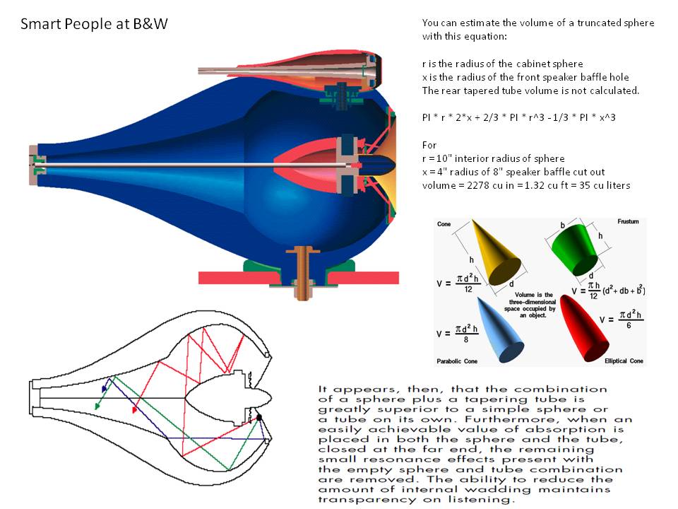

I've been using square pyramids for most midrange designs for a few years. Idea stolen directly from B&W. With some care and thought in the early design stages I've done one inverted J that need to bend to get the length. I'll be using this in the large 4 way design that's been slowly moving along for a while now.

I use the free transmission line modeling program from Leonard Audio which supports tapered volumes and variable density stuffing. A conical (pyramid) shaped rear taper using flat sides works well, an eliptical curved taper will model slightly better at smoothing reflections but the benefits of this complex construction are very small. Both B&W and Vivid put a volume around/behind the driver which is large enough with modest on-wall absorption material to reduce early reflections back to the rear cone, and attach the tapered tube/pyramid behind this.
http://www.diyaudio.com/forums/software-tools/220421-transmission-line-modelling-software.html

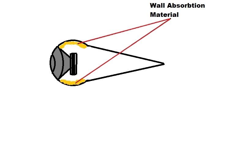

Do you mean they only put the "wall absorption material" near the driver? Like this:
Sorry for the bad picture.
In the best constructions:
The expansion chamber around the speaker has a thin layer of absorption material glued to the walls to absorb the higher frequencies. The rear tapered chamber is filled with low density absorption material like Poly-Fill, loose wool, or fiber glass ... similar to a transmission line ... to attenuate a wide range of mid frequencies with reduced resonances. Some engineers leave a very small opening(aperiodic loading) at the end of the taper.
Some companies create similar (volume+stuffed_taper) using bent boards, or internal V-bracing.

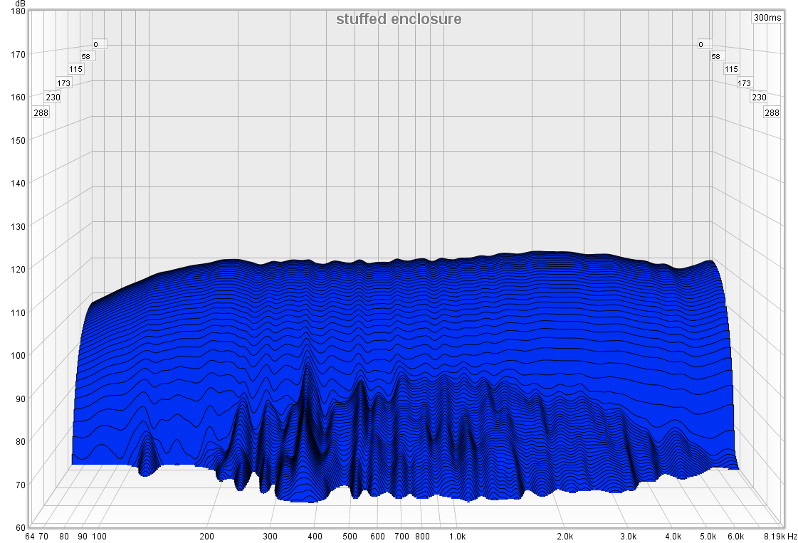

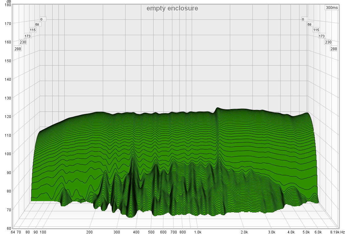

Do not try "Hypercube Loudspeaker", it is almost the same as spherical enclosure - only one, but giant internal resonance.
Please elaborate (perhaps not in this thread) on your experience with this enclosure. My measurements do not seem to indicate that this problem exists. The attached waterfall plots show the effect of stuffing a hypercube enclosure which in this case damps a structural resonance (related to panel stiffness) at 1.5khz. With adhesive vinyl damping sheets applied to the interior surfaces, the difference becomes even smaller.
