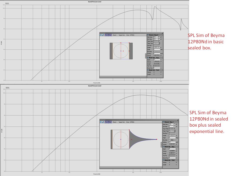

after reading a post of Arty , I did that simulation with a mw16-4 of sb acoustic to compare heavy stuffing square cabinet and triangle end box. My result with Leonard software regarding the spl is that both box look the same. Is there a better way to see the difference between the two concepts ?

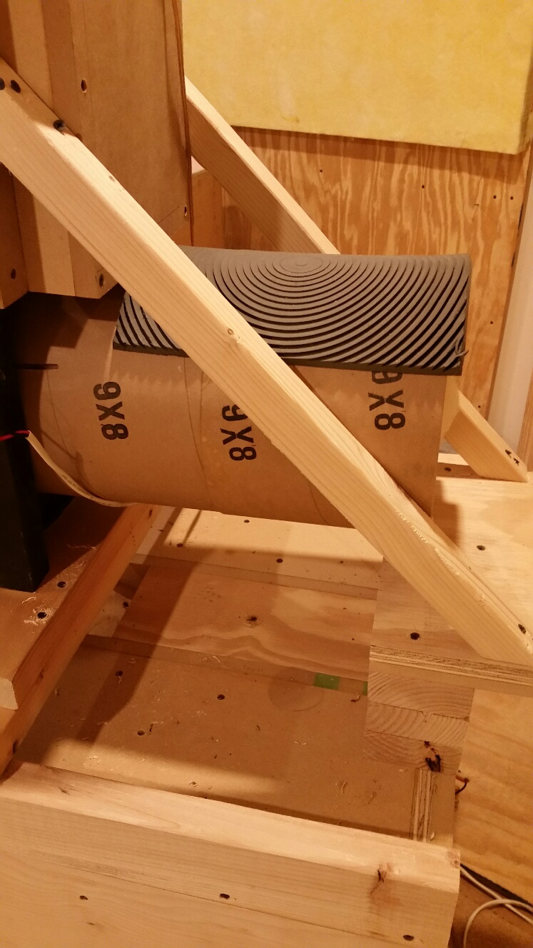

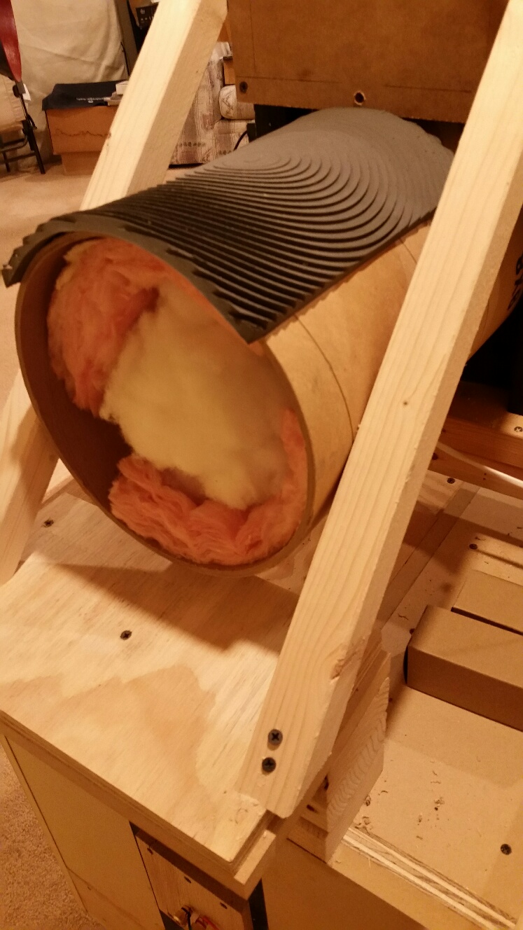

I found 4" pipe didn't give that much volume. Though talking in metric speak.... 100mm diameter pipe by 120mm long gives just under a litre volume. Whereas 120mm pipe of the same length gives 1.35L.
This is using ventilation ducting. It's quite floppy until braced by end caps or "sockets" routed in panels. when braced it's nicely rigid. I used bitumen/aluminium flashing tape on the outside to deaden it, lined the walls with 12mm wool felt and stuffed with 20g wool.
If wanting to avoid a flat end cap, possibly routing smaller disks of ply/mdf/wood can be formed into a "Mayan pyramid".... And the edges bevelled?!
