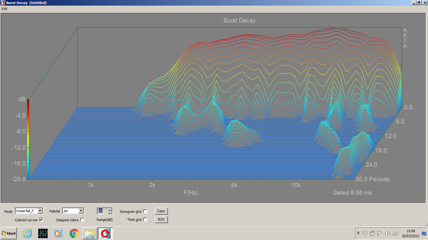

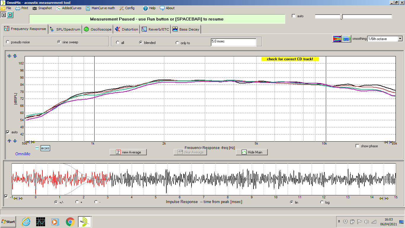

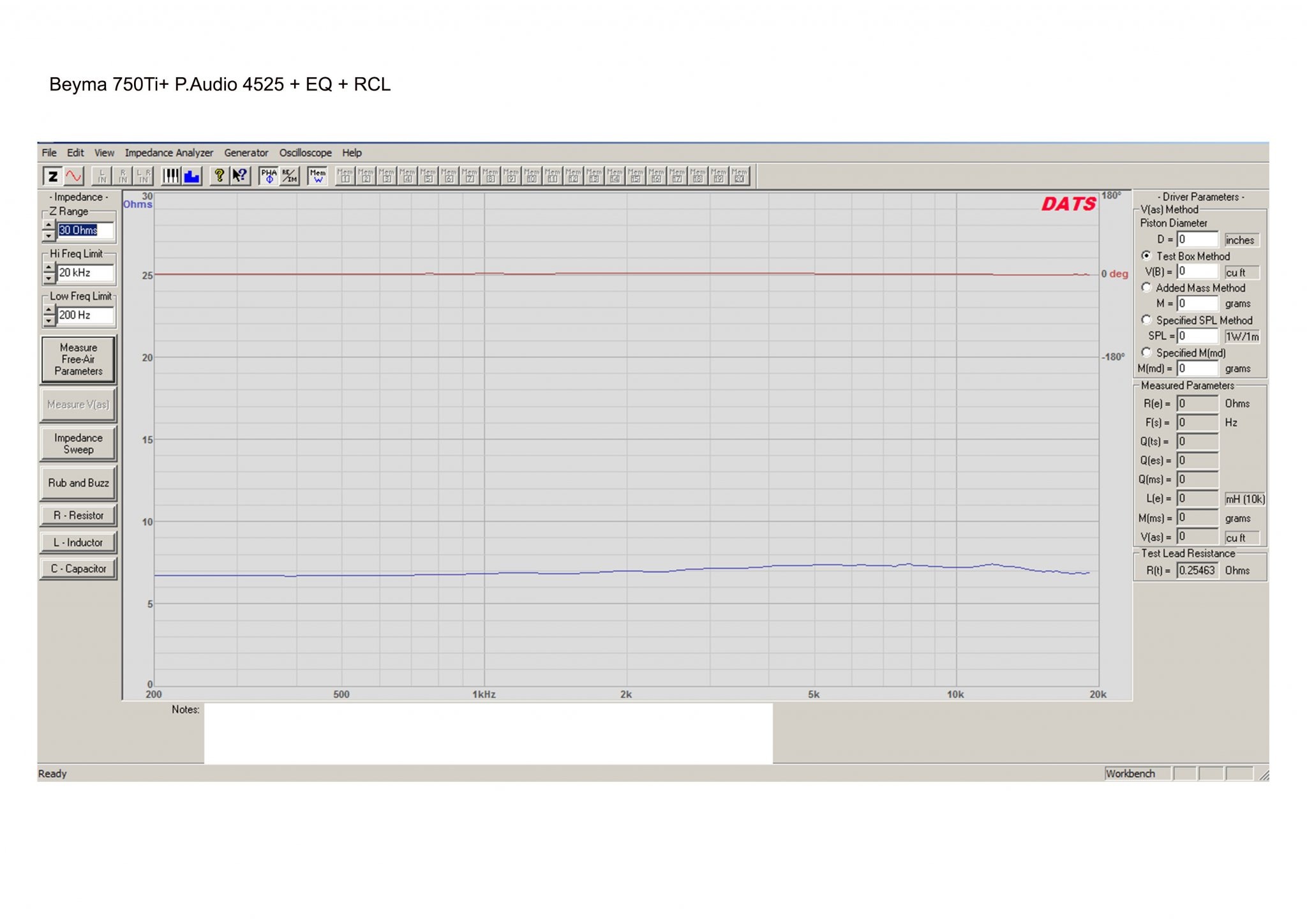

Yet to try/measure FR with my JBL 2360a's with EV DH1a's, but have used DAT's to test the drivers (consecutive serial nos!) and create impedance plots with horns attached which has enabled me to create a passive EQ circuit which also levels the impedance to present an easy load and maximise amplifier damping from Fs to 20KHz. (Yet to have the boards created for this project!)
I did the same though for my current system which is based on the P Audio 4525 (the 90 x 40 with the slot/circular throat..same as the Goldwood pb450..same horn!) with excellent results. I have found using science and getting the basics right bring rewards and rather more so than swapping cd drivers/horns etc or repeating the usual arguement about CD vs Tractrix vs spherical or whatever...so here are some plots (P Audio 4525/Beyma 750Ti at 15,30,45deg Horizontal, Impedance plot showing the +/- .5ohm deviation and 0 deg phase angle.. and a decay plot to enjoy! Crossover is around 900Hz with a Rane 23s active, delay was optimised using an analyser, to provide a flat response and minimum phase condition with the 10" mid. Vertical driver spacing as per Pi loudspeakers to provide nulls vertically at +/- 30 deg to suit the horns 40 deg vertical dispersion. The horn cut off is supposed to be around 450Hz so doubling this frequency ensures we are in the territory of full directional control..)
