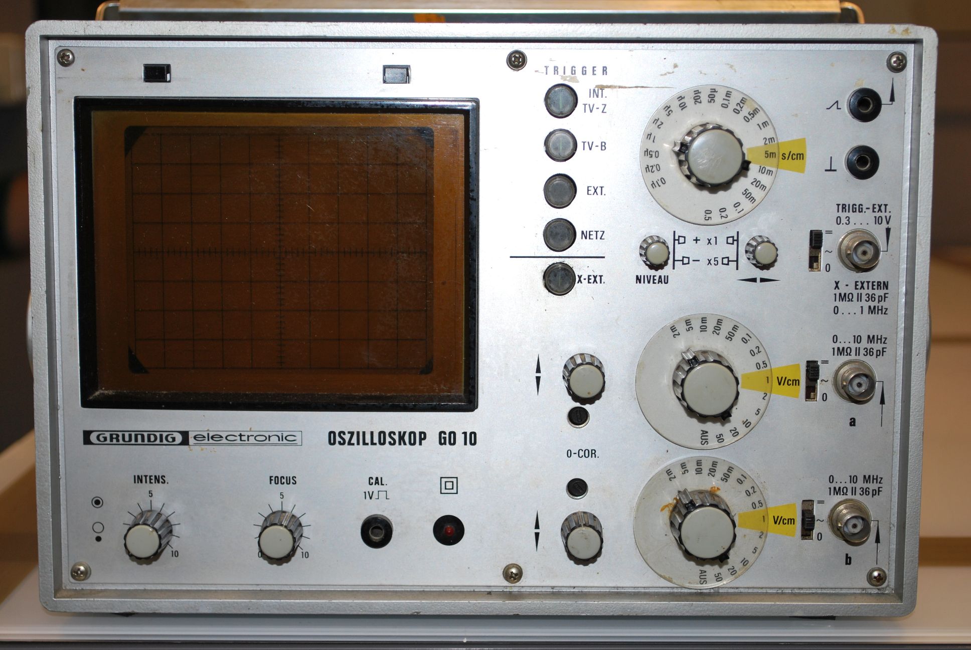

Any analogue scope with at least 10Mhz bandwidth and a sensitivity of 1 to 5 mv/div should be useful (which covers just about any traditional scope made in last 50 years ).
Only silence and yet the VU meter registers... that points to some form of HF instability. If I remember correctly we proved the VU meter OK by disconnecting its input and it then showed zero.
He did say the scope was old, but probably not that old.

There's probably quite a bit on-line on using scopes.
The oscilloscope is really just a voltmeter along the vertical axis, and the horizontal axis which "measures" time.
One very important point to be aware of is this. 99.9% of scopes will (should) have a mains grounded case and that means the "outer" or shield of the scope probe leads is connected to mains ground.
And if the amplifier is grounded... well you have to remember that you must securely clip the scope lead ground to "ground" in the amp. If the croc clip flirts off (and they do ) and if it touches anything with voltage on it then you have a dead short to ground via the scope lead.
Also beware any uninsulated ground parts on the probe... its so easy to let it touch something "live" accidently.
2 seconds with a scope will show what is or is not going on with that amplifier stage.

Do I really want to use the scope after knowing what can potentially go wrong?
Yes, I do. I will be careful and not connect anything untill checked here first.

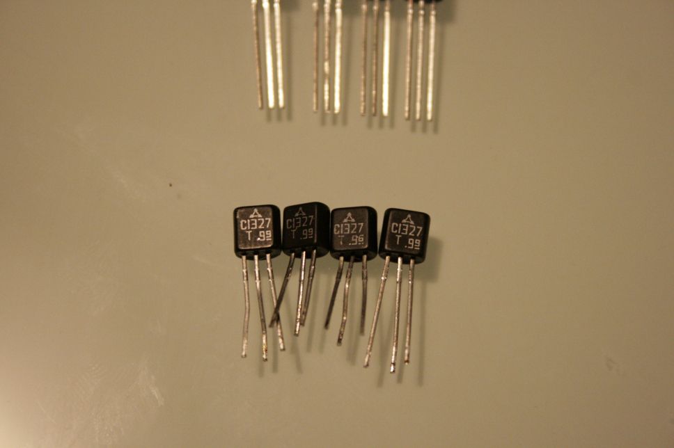

You can leave the C506 as it is as we know the problem is present with it like that. It eliminates any (further) trouble from the input and pot side of things.
The transistors. In practice the gain of the transistors won't make any practical difference in the performance of the amp as long as they are reasonable. The gain of the amp as a whole (and the various stages) is determined entirely by the feedback components.
You could always fit the originals back as they appear undamaged but lets scope it all first and see what is going on. The ancient BC549C (different pin out) is a good low noise device in you can get reputable ones.
The transistors with "painted" fronts are likely genuine, I have seen and used plenty of official Philips (as an example) supplied parts marked like that.

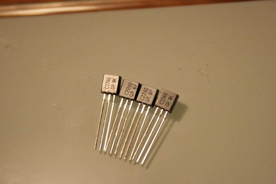

Marko,
The 2SC2240-GR you have are 0.0000001% original. The 2SC2240 has long been discontinued by Toshiba, so most of the parts out there (eBay) are counterfeit. This applies to a lot of Japanese parts so be careful where you buy them.
The physical dimensions of counterfeits are smaller than the originals. It's a general rule and it doesn't always apply. Measure with a caliper and compare. The Chinese counterfeiters has to skimp somewhere, in this case the epoxy material.
The other counterfeit test is with a curve tracer to verify gain and HFE linearity. A DMM HFE test is not sufficient. Most Japanese audio transistors have uniform HFE across the operating range as shown on their datasheet and a curve tracer will give you this information. Like I said before, counterfeits are always short in gain and this test will weed out most of them.
The final test is in-circuit where noise performance is measured. Noise difference can be 6dB (2x) or more. Bad news when you are dealing with phono preamps.
I routinely do all of the above plus more battery of tests to evaluate unknown parts.

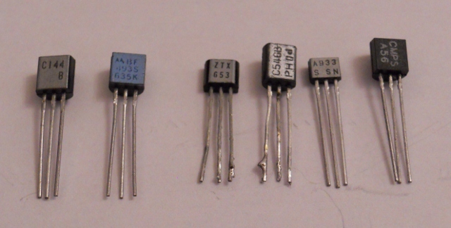

Is the above post a dig at me ? I think it must be as myself and hitachi_nut are the only ones posting.
Here are some 15 to 20 year old parts from before the days of widespread counterfeiting and internet use. One is very definitely suspect... the MPSA56. As tested it's a good NPN device (the clue is in the NPN bit). Could it be a genuine marking mistake. I don't know. It was from a batch of 50 or so from a major well known UK distributer and a handful were like this. Many common devices are made under license so just because it isn't marked as the original manufacturer doesn't mean it isn't "genuine".
The painted ones such as the Philips were supplied by Philips themselves as part of official repair kits for Philips consumer products.
With the explosion of internet use, auction sites and so on, the last few years have seen an exponential growth in counterfeiting and these days the only sure way (as sure as can be) is to buy parts from major companies that guarantee traceability and that what is offered is actually what you get.

I said I did not buy transistors from ebay, but locally. However I can not call my local shop reputable, although one of its sources is dutch company Nedis (Groothandel en distributeur voor kabels, consumenten electronica en accessoires | NEDIS).
However, if transistors on eBay are mostly counterfeits, and the pictures of SC2240 transistors on eBay are totally different from my transistors I can only concur that mine are originals, and yes I measured them with caliper, dimensions check out OK.

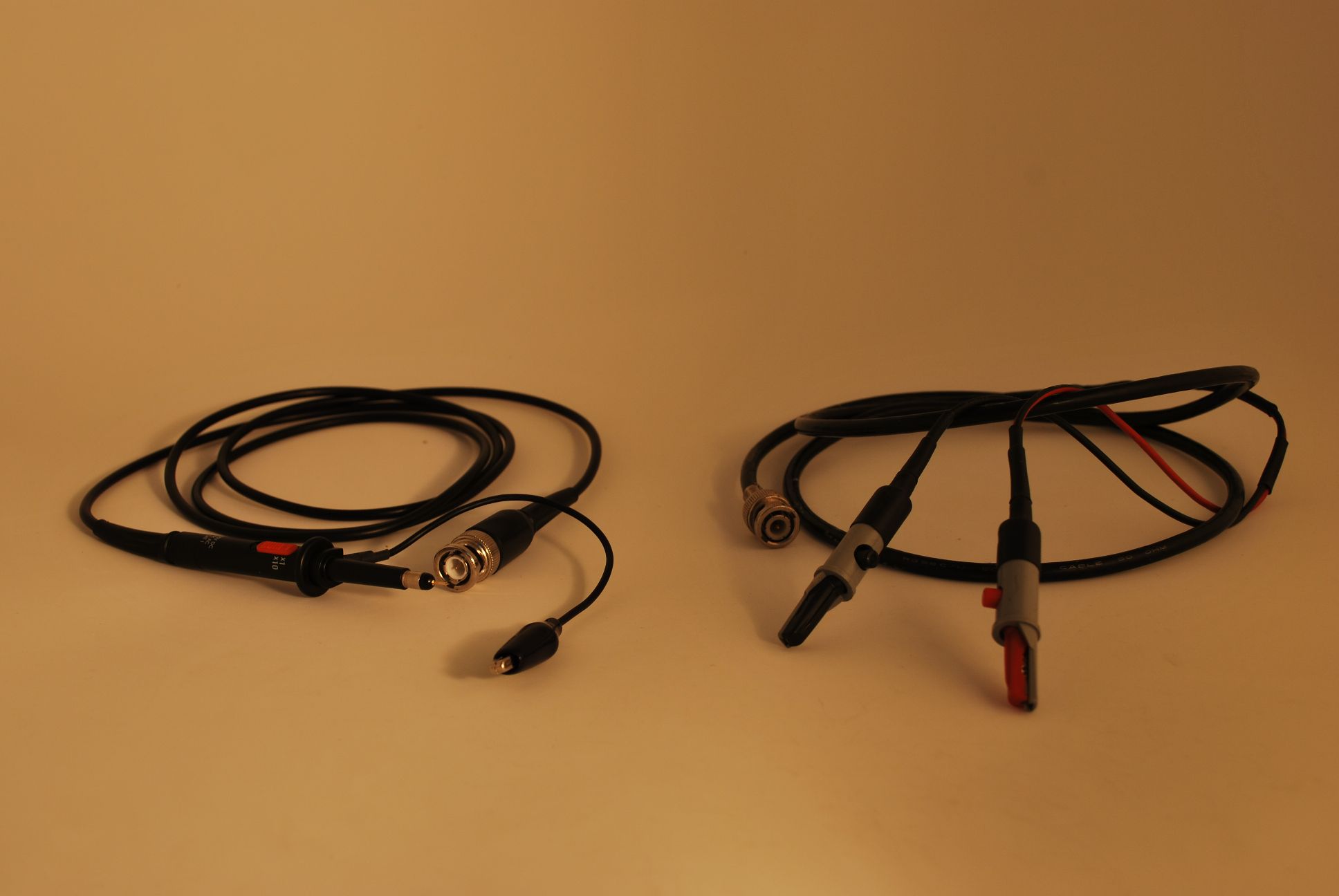

Try and get some "proper" probes with it too as we are looking at tiny amplitude signals.
Hi Mooly,
unfortunately I don't know what kind of probes will come with the scope. If needed I will buy new set.

This is xmas after xmas for me, santa brought me this:
Oszilloskop GO10 Equipment Grundig Radio-Vertrieb made in Germany, which is always a good thing, but dangerously close to 50 years Mooly mentioned by the looks of it. I hope it will suffice, as well as the probes.
This the only link to specs I found online:
http://www.radiomuseum.org/r/grundig_oszilloskop_go10go_1.html
This is the moment when I listen carefully.
