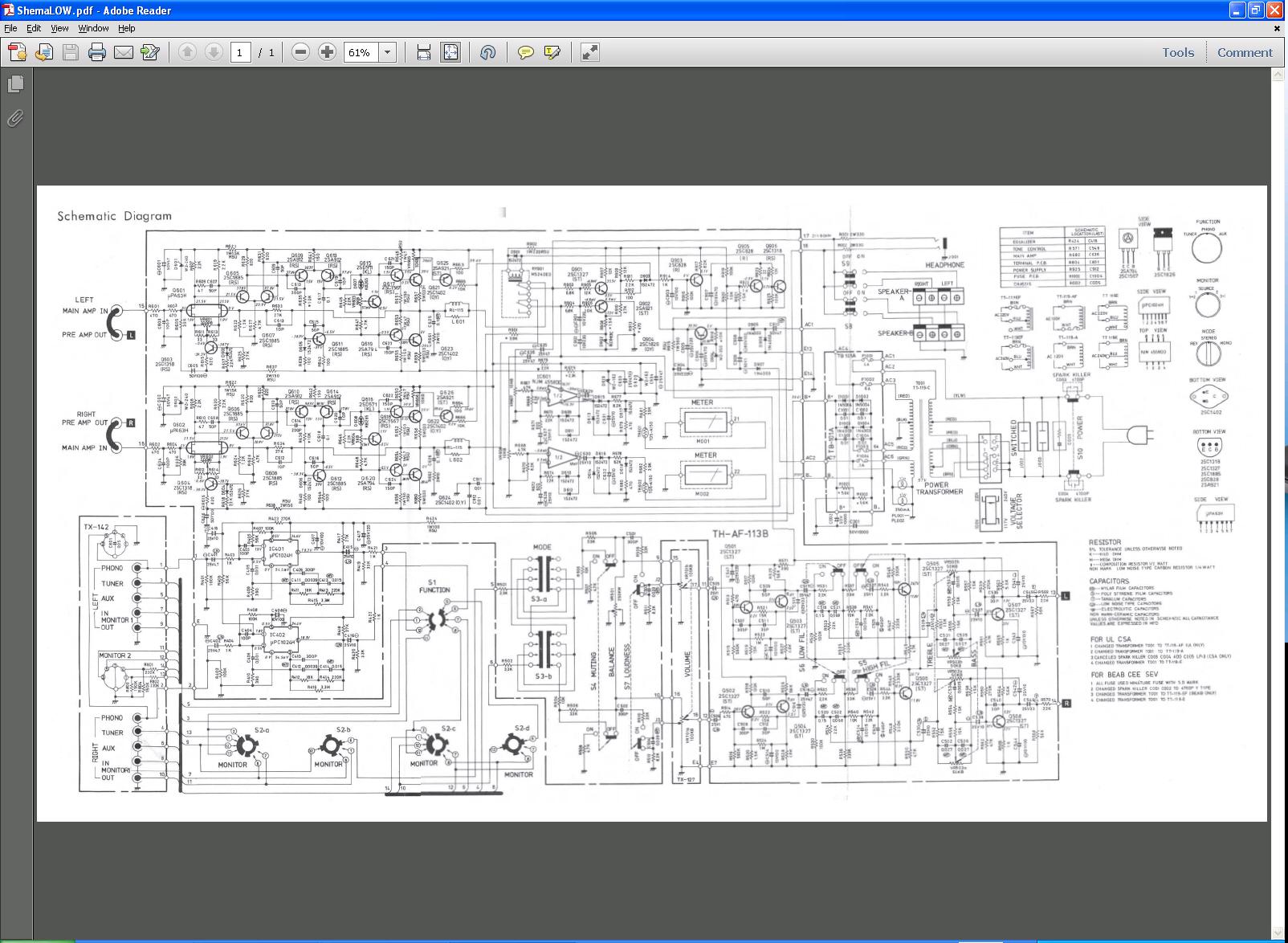

My shotgun approach so far has not yielded any results and I am out of ideas and would appreciate any help. I took some voltage readings, default values in brackets E-C-B everywhere:
B+ (39,6) 41.1
B- (39,6) 41.1
voltage regulator Q904 (35.3-5?-35.9) 34-53,4-34,6 schematics shows collector voltage 5V, but I believe that is a typo, please confirm

Thanks for the circuit,
things to check with NO signal applied. And that is a typo on Q904.

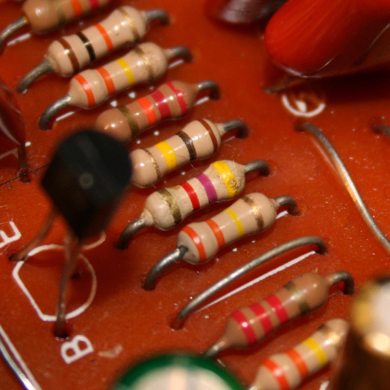

I took some measuring in circuit, I did not have the time for lifting one leg as my wife is baking cookies and that leaves only me to guard the kid but maybe this data will be of some importance. I took a picture of resistors in question and the fourth one (R550 4.7K) from the bottom looks like it has seen better days. Please comment as I don't have much experience with resistors, that hole on the third one (R546 330K) looks suspicious to me also, but I don't know.
R546(330K) 0.0162M
R550(4.7K) 4.7K suspicious one

Thanks for the readings... they seem OK and don't show much all that much drift. Also I'm sure the resistors will be OK. Unless you just desolder one end with braid and at the sametime use a croc clip as a heat shunt on the leg you can end up making things worse.
The resistors are the very last suspects. They all look normal tbh, the "hole" is just the ceramic or whatever coating... not a problem.

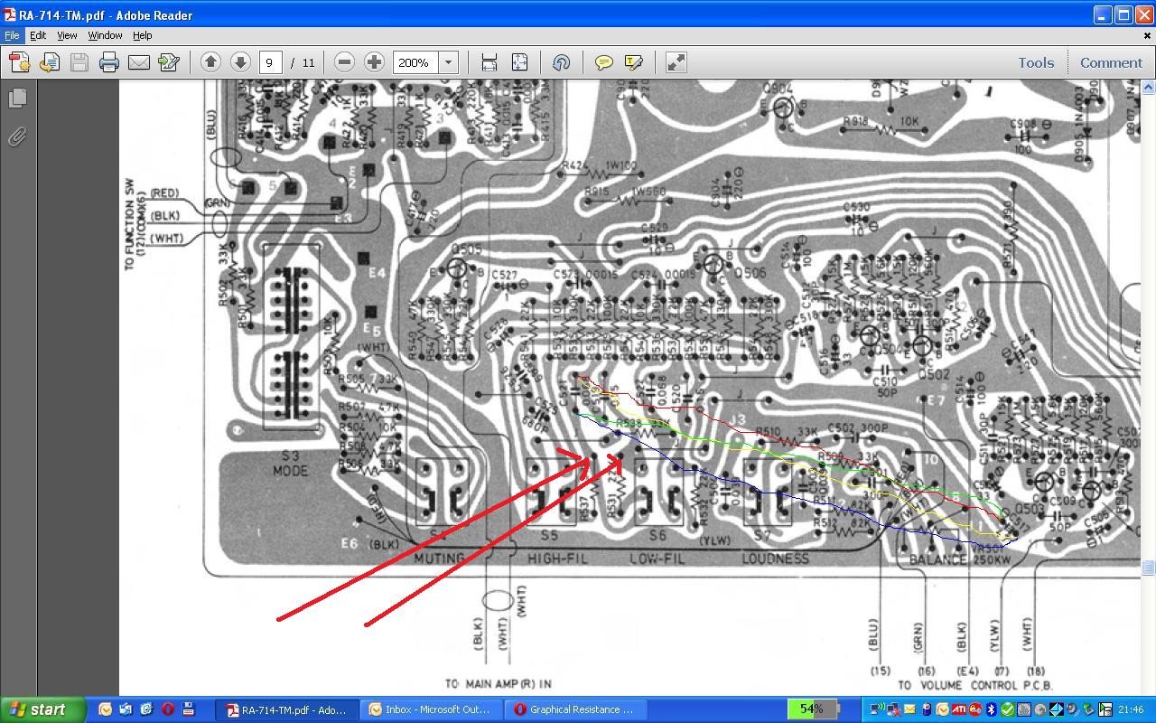

Look at the circuit and the "top" channel.
Resistor R531 can either bypass the filter consisting of C519 and C521 when the switch is "off" or place those components in circuit when on. So measure the DC voltage across those two series caps from end to end. That is from the junction of C517/R531 and C521/R539. If that is not zero volts DC then you will get a thump as the switch is operated. All those points are referenced to ground via R529 and R539 so they should be truly at 0.000 vdc. Make sure there is no signal applied.

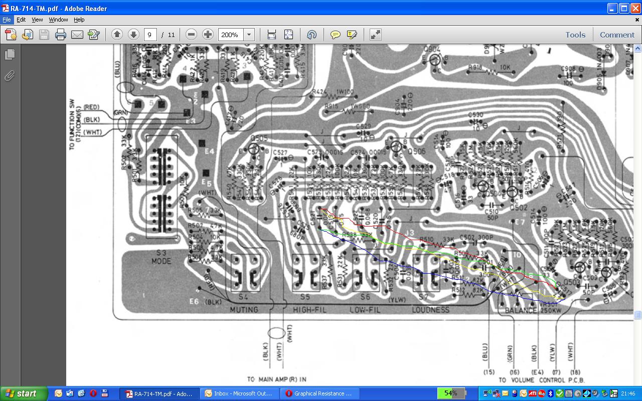

Mooly please don't thank me, you are helping me I am very grateful for that. I am enclosing picture which will reveal the magnitude of my ignorance in electronics and in art but please don't laugh at me.
red line 10.82V
yellow line 2.15V
green line 0.0V
blue 13.08V

Very difficult working from pdf's on screen.
Measure on DC volts between these two points with the filter switch ON which places the caps in circuit.
Also measure DC voltage from ground to these two points which should also be zero.

What is not very visible in the picture is that yellow, violet, red,gold 4.7K resistor has a slightly wrinkled, shrinked surface while other resistors in that row have almost a glossy surface, I would say the difference between them is like a skin from a 20-year old girl and from an old lady. It is also the only resistor that measured its nominal value in circuit, all other measured slightly lower value. Perhaps I should measure it from the underside, pcb side to exclude cold solder joint. Your suggestion is noninvasive, if I understand correctly one side of every resistor should read 0.0V relative to ground, main ground that would be E14?

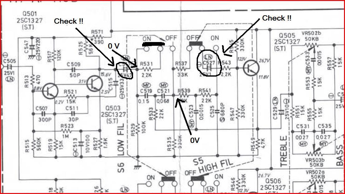

Look at this. The filter switch is now in the "on" position.
The two voltages shown must be zero with respect to ground and zero volts between them.
The two caps marked "Check" if fitted back to front or faulty could cause a DC fault.
