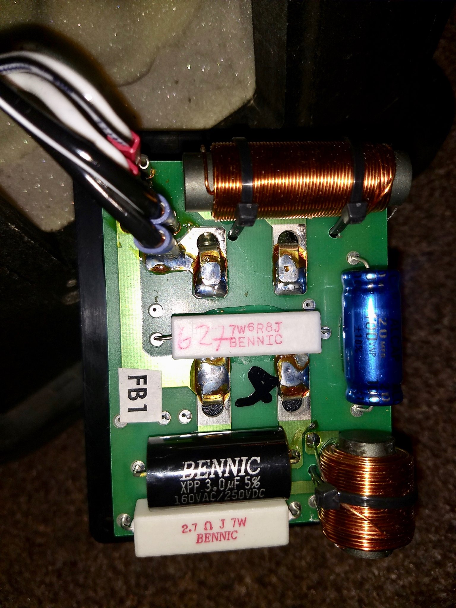

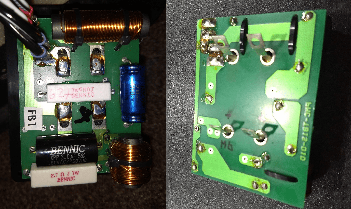

Please see photos attached of top and bottom crossover, it certainly appears to be in parallel but then I don get quite confused following tracks!
If I pop the network is there a way to check with a MM from the top as that's easily accessible
I haven't popped the crossover to check, its a bit of a pain to disconnect from the terminals.
You can use your multimeter on its lowest ohms range to verify the connection between the top and bottom sides of the circuit board. looking for below an ohm or so.
From the attached images it is difficult to see exactly what is going on in the area where the speaker wires are connected. Are the two black wires actually attached to the same piece of copper pcb track or is that just flux obscuring two individual pcb tracks. There does seem to be some solder splash at differing points that needs to be tidies up to prevent any shorts.

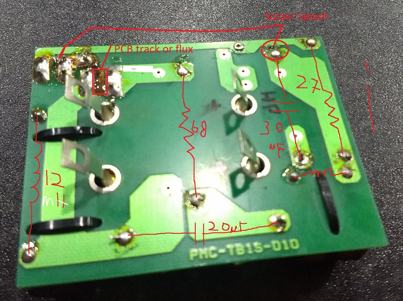

While you're trying to trace the schematic I've shown an example where I've flipped and rotated the other side so they are oriented the same. This is so you can mark the traces from the other side.
Also note that you can see the traces under the components, and you know the purpose of the external connections, but we don't.

The values you listed are as I see it, As I recall did measure the resistors at the solder pads to make sure everything was connected. I can't measure caps and just used continuity across the inductors. The guy who drew the schematic gave some expected residence measurements for the whole pub which were spot on.
FYI the 56ohm resistor attaches from the through hole near where you wrote solder splash? and attaches top solder joint at the negative HF terminal effectively in parallel?
FYI the left image shows driver connections black cable LF white HF stripe is +.
from bottom to top LF- LF+ HF- HF+ on the right I've marked HF+ LF mimics positioning.

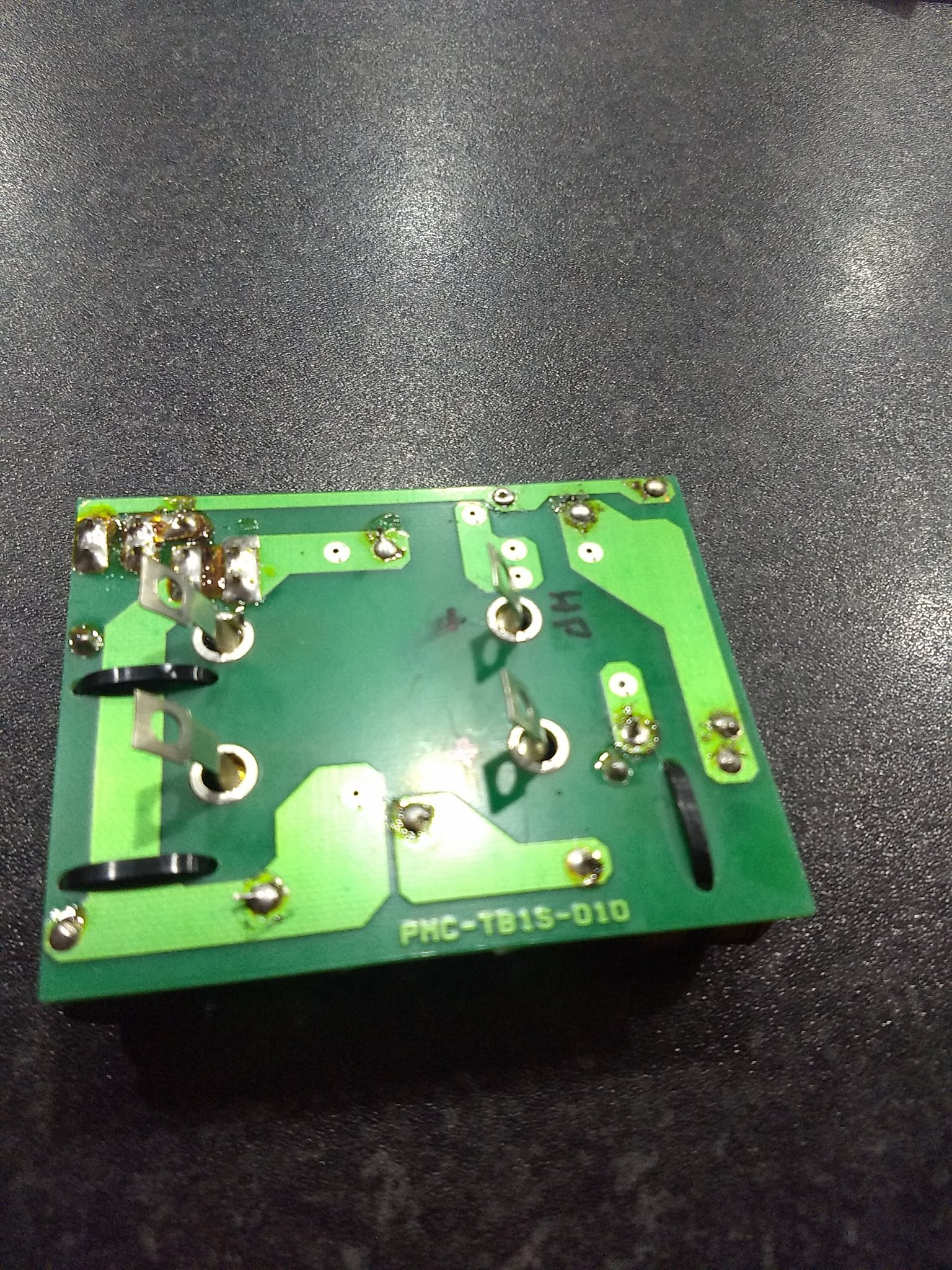

Download gimp.
And take a better photo of the back of the crossover, right in front of it and not lateral, as you did with the front. Using gimp you can reverse a photo and add text on it.

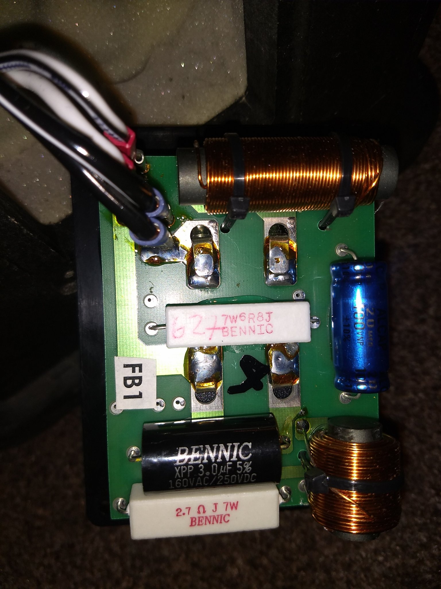

Do you have a later image of the completed boards as we cannot see where the 56 ohm resistor or the Solen 3.3 uf Capacitors are placed on your boards.
That may be where the subtle difference will be found, which may explain your findings on the current sound of your speaker.

Hi Raymond thank you for taking the time.

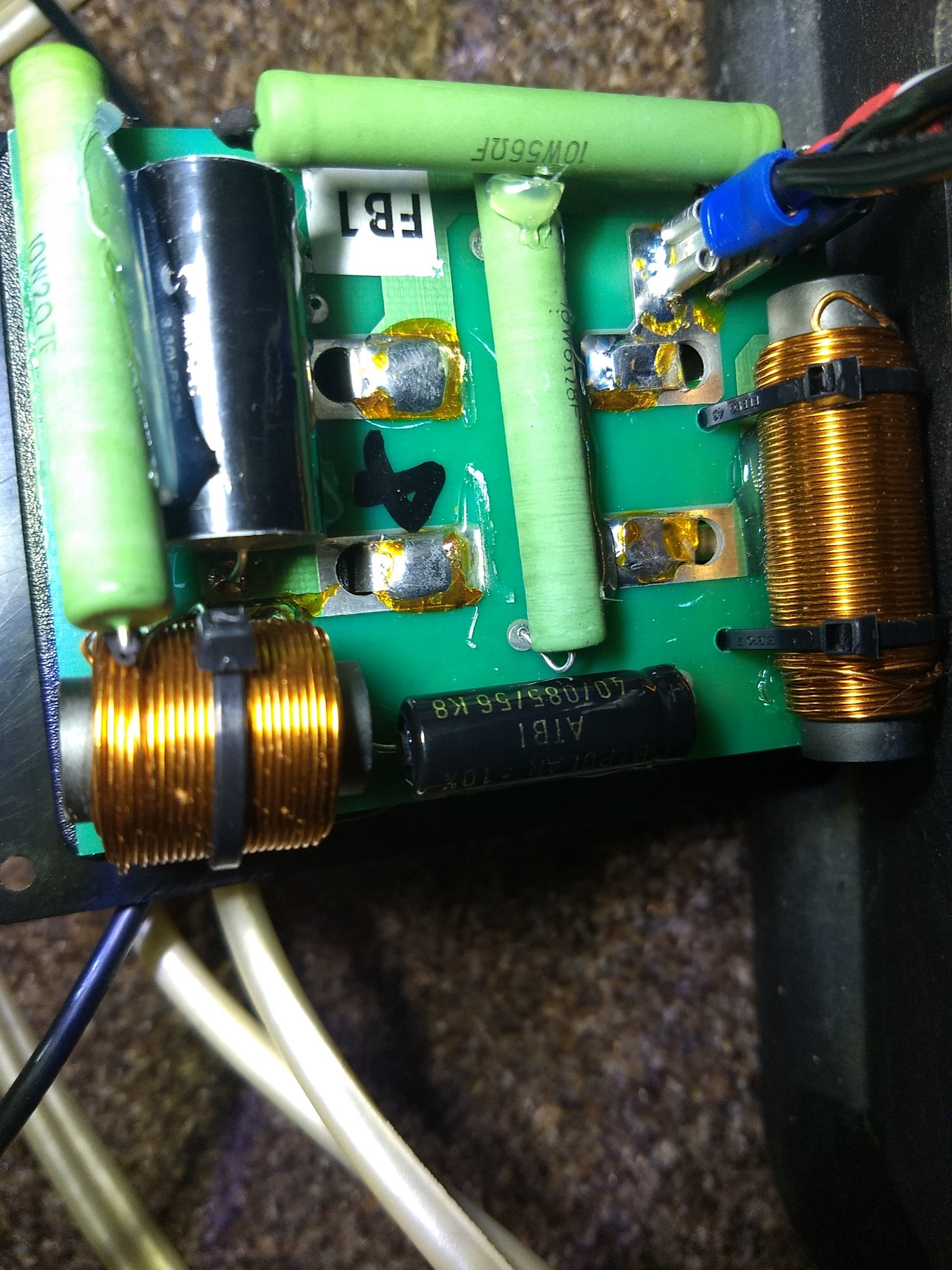

attached is one of the completed networks. It might not be the most elegant solution however I had to stay within the footprint of the enclosure opening. The solder legs have shine tube installed wherever they are in close proximity to another component and hot glued into place.
The 56ohm resistor is installed into the through hole to the edge of the board by the FB1 sticker soldered to the rear, and top soldered to a solder point hidden by the black cables. I followed the FB1+ layout and found a pic online from a random website but admit I didn't save the image

Which could suggest you have the 2.7 and 56 in parallel.
I still suspect you have one end of the 56ohm resistor connected incorrectly.
I won't say thats not possible however there is only 1 top solder position which is the - for the tweeter and whilst there are 3 holes at the other end 2 sit on an unused pad (visible from below, the other is the 3.3 cap. I used the one at the cap which correlates to the photo I found.
Hmmm,
It could also be looking back via the 2.7 ohm and the inductor say 0.3 ohm. It would be nice to see images of both sides to confirm. I know you say its a pain.
