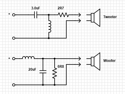

Hi Raymond
Its entirely possible it is in series, a contributor from another site came up with the schematic from looking at a photo and the +pdf.
Out of curiosity what do you mean by pull frequencies down? And the resistor getting warm?
Would a resistor getting warm be an issue? I thought the very fact they resist power would warm them up the more you drive them?
I'm looking to open up mids and reduce tweeter db as its just too forward on some tracks.
I am considering other mods within the system as the speakers maybe the strongest area and the issue lies elsewhere.
Regards Ian
A shunt resistor across LF units isn't unknown (JBL & others have done it) but it's not often done; in addition to dropping the impedance you're sinking a proportion of the current draw through it, rather than the driver. Since the majority of current demands are in the lower frequencies, it's going to get quite hot, quite quickly, especially when you crank the volume, so if that is indeed the crossover schematic (I doubt it, with those values), then you'll need a resistor with a high rating to avoid burning the thing out & also ensure you don't find some fluctuations in the actual resistance value.

Scottmoose has given you a great reply, which I am sure has answered your questions. Personally I too didnt know that some companies actually use shunt resistors for the Bass units?
You have the speakers with Xover so I believe a bit more time investigating with the ohmmeter is needed to get the full answer and verification of the actual circuit.

Sure. JBL did it in several of their historic models, but (but) only of a relatively high value; 47ohm - 33ohm was about the limit as I recall. I also used it in a commercial speaker design when I was faced with a situation where I had a particular number of particular drivers that were required to be used but the impedance in either series or parallel would have been unworkable as-was. Band-aid solution in some ways, although it did what was needed, and brought some damping advantages, once the heat-sinking was addressed. ;) An earlier version of the Elsinore (I think it was version 4) also took this approach for the damping -IIRC Joe was quite excited about it at the time, and it presumably directly or otherwise led to him shifting to the more precise input Zobels introduced in the subsequent v5 & v6
