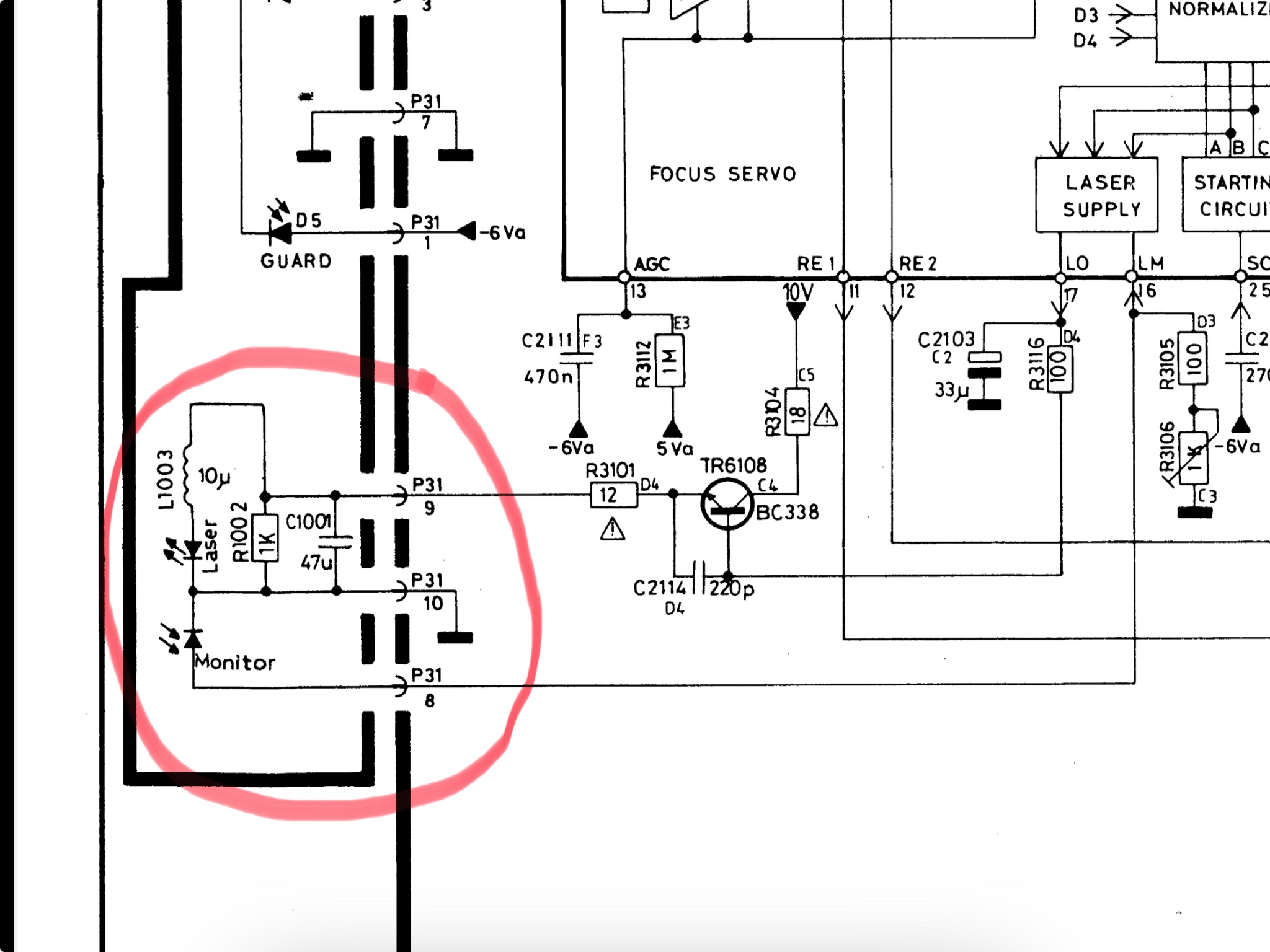

Quick update - I haven't tried the connector 31 measurements yet.
But, I did remove the CD mechanism, cleaned up the ends of the ribbon cable, placed the mechanism on top of the chassis, ran the test program and it passed all of test 4 for the radial arm. It span up, and pressing << and >> moved the laser assembly in and out. Success 😀😀😀 Once only 🙁🙁🙁🙁🙁🙁🙁
After that it went back to failing test 4 even after I took it apart again, reassembled it and placed it back in its correct place in the metal chassis.
I'll try the electrical tests later this week but I'm really at a loss as to the problem other than a failed radial assembly.

Nick, I understand your frustrations, from this point on I guess you have tried the very best you could do. Electronics that operates one moment and fails the next is a dramatic thing. There is no such thing as a selfrestoring semiconductor. Your problem must be caused by a mechanical defect. Poor connection, friction, position etc. Give it a shake and bake and use the freeze spray. Play it in different positions. No result? Find a donor CD drive😢

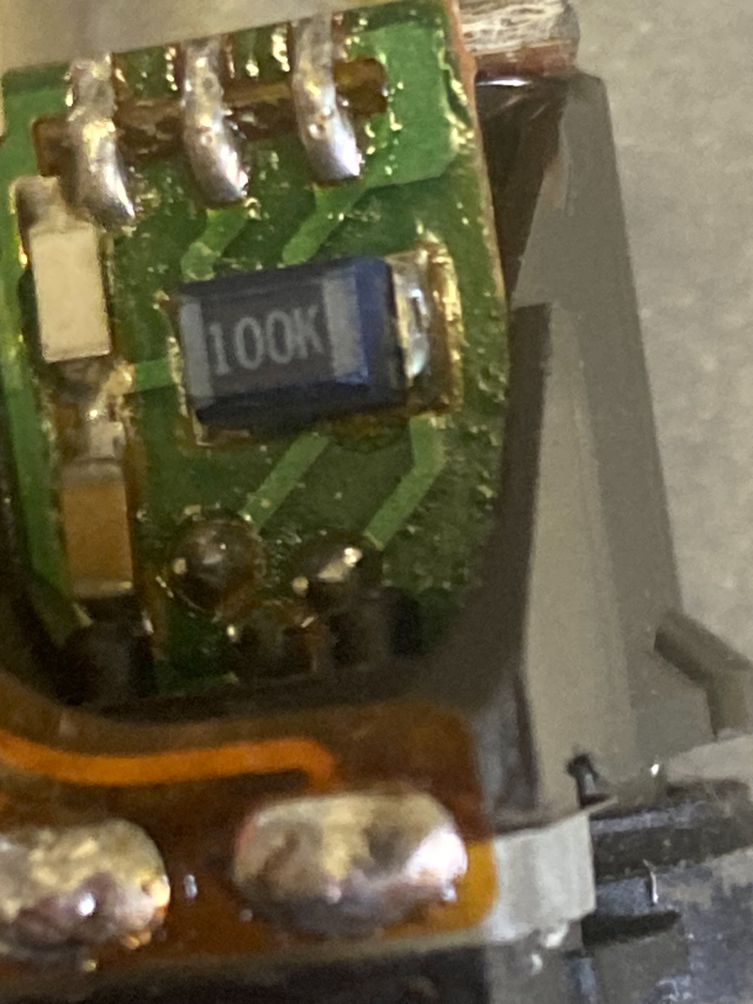

What is this component on the radial control/laser assembly? I thought it might be a resistor, but it only reads about 2 ohms, admittedly in circuit. If tested as a capacitor it tests open, with leads both ways around.
Nick, I am just as puzzled as you are. Recommend you study chapter 9-1 of the service manual. It shows the 3 SMD components on the laser assembly. It shall have a resistor of 1K, an inductor, and a capacitor. You will have to probe which is what.when you measure 2 ohms in both directions you may be across the inductance. Try to measure from ground at P31 pin 10 and 9.

I had 3 probe pairs connected, for HF, Laser output, and focus offset . Found the eye signal mentioned, at probably twice the signal strength necessary. Also a amped sawtooth noise signal at the strength of what the original signal should be was present when the "eye" was not there. Was supposed to try adjustments of one of the potmeters, when slipped, nocked over something on the table which pushed the cables and one probe jumped off its connection and slid over the PCB, probably shorting tings out. The signal was not the same anymore, laser output was suddenly doubled, disk span at highspeed and quite some other symthoms... Felt like I was almost there.. now two oceans away, at least... 😳
Well, now I have quite some more to troubleshot...
All your suggestions are qute on good and on the point, I'm afraid. I should have done all of them, but for some reason or other I've posponed them... Guess I was hoping to find the errors in al logic way, and maybe skip the work for some of it?
(I've checked the voltage levels, so regulators should be fairly ok. Well, might not be anymore...)
BTW: Oscilloscopes just looks confusing, but there are only 2-3 knobs to care about, the rest is just there to confuse you. One knob determines the height of the signal, in a Volt pr square format on the screen (up and down), and the other is the time pr square on the display sideways. The las button is to get the signal in the middle. not much more is needed, but they keep adding features you newer knew you ever needed. All one want is presenting the signal voltage amplitude for a certain time period 😛
