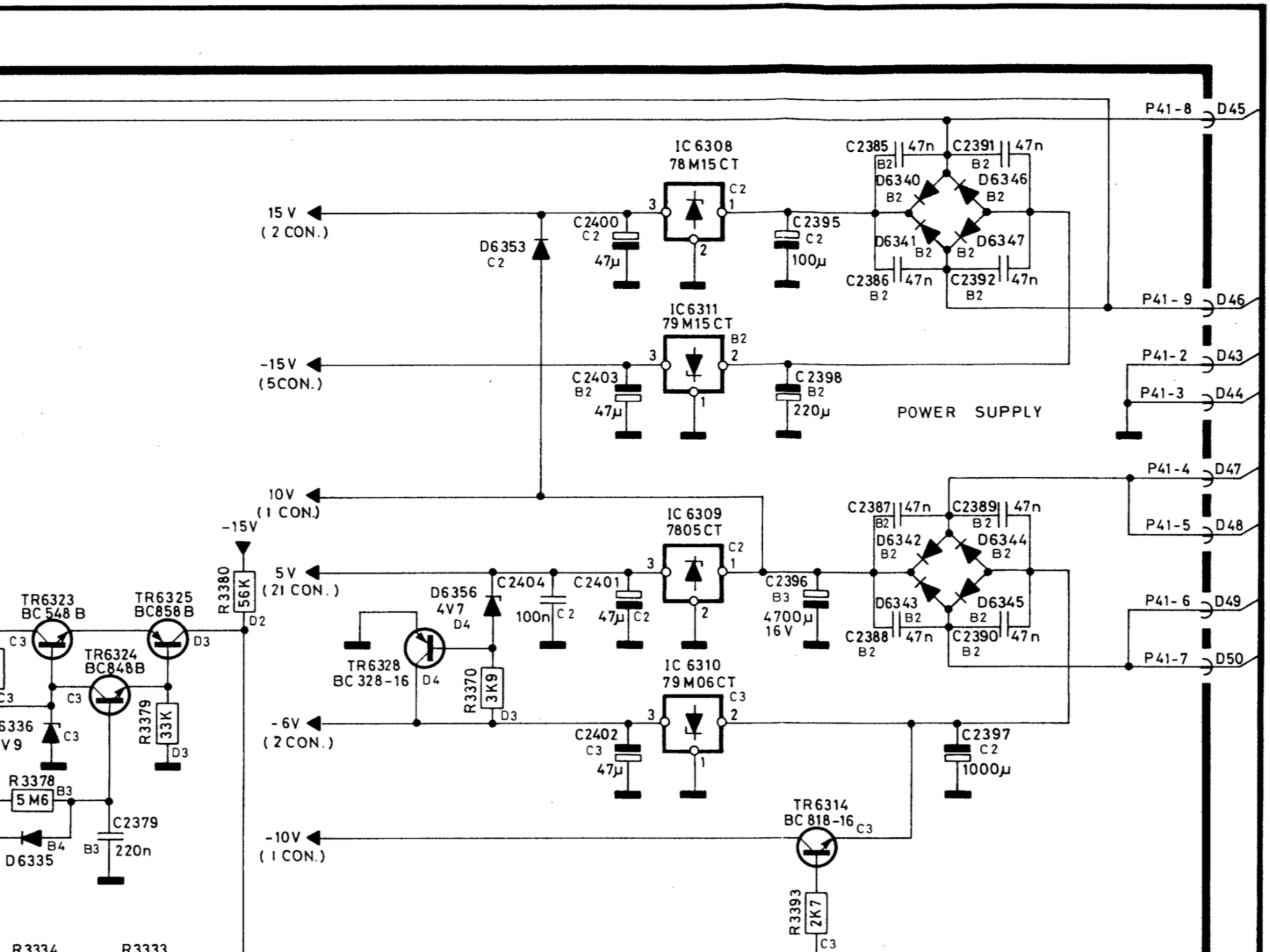

If that does solve the drive/reading CD problem, I then need to see if the 15v voltage regulator giving 10v is an issue. Hopefully not.

That maybe a clue, but normally the connector should not release the flat cable unless the lock is lifted. Recommend you use a magnifier glass to carefully inspect the pitted indents on the flat cable. When unreliable you can use scissors to cut the flat e.g. 1 mm shorter. About the 15/10 Volt issue, did you check or replace the diode D6353?

I identified the source of the funny +10v output from the +15v regulator. Me!!! I brilliantly replaced the +15v 78M15CT with a -15v 79M15CT. Note to self, remember to take glasses off when trying to read small print on components. Doh!! Changed the component and voltages are as they should be. Put it all back together, AGAIN, and it still doesn't work.

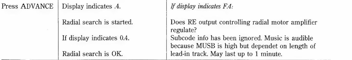

Completed service mode test and got as far as this;
Looks like another Google to see what all that means. The test won't go past that. If I try the next step it just ignores the >> key press. I can start the test again by pressing Advance but it always stops with an F4 error.
Nick je bent op de goede weg. Jouw CD3300 blijft dus hangen op F4, dat betekent dat de radiaal servo een probleem heeft.
Ik zou alle voedingspanningen op het IC 6102 op het Servoboard eens gaan meten.(ik hoop dat je een goed testprobe hebt zodat je geen sluiting zult maken). Ik weet niet of je de beschikking hebt over een oscilloscope, maar de hi-low testen volgens para 7-7 kan je met een multimeter uitvoeren.

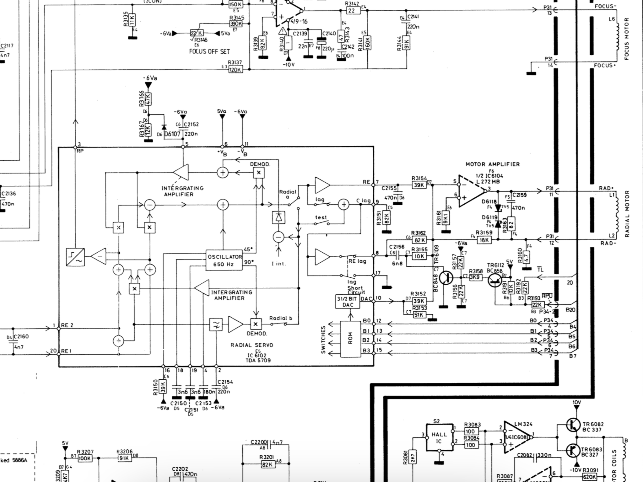

I've taken readings from the IC6102 pins, as in the photo. Readings are Volts unless specifid as microvolts
Supply at pins 6 and 11 seems to be OK.

Hi Nick you have measured the voltages on the servo board and I could not see any abnormalities. Let us focus now on your test results of chapter 7-1 and 7-2 It hangs on step 4 which means the tracking correction circuit does not function correctly, the RE Radial Error is somewhere at fault. Previous successful test indicated that the laser arm moved correctly and freely over the full range of travel from completely in to out.
The failing step 4 is the fase where laser arm is trying to center around the tracks in it’s preparation to read the TOC (Table Of Contents) of the disc. The arm should be very close to the spindle motor (fully in).
You measured at P31 pin 11: 1V and pin 12: 200mV. It would be interesting to know where the arm is located while the disc is rotating in step 4 while you hook up your meter across pin 11 and 12 (not to ground). See whether this voltage fluctuates when you lightly tap on the cabinet.
Not having an oscilloscope I recommend to go to para 7-3 and measure the status hi or lo on IC 6301 (We are now on the Servo Panel para 2-5) follow the steps as given and note any different in status when switching between steps 3 and 4 of the para 7-2. Please note that 5 V power from the Decoder board is also applied to IC6301
The Service Manual dor the CDM-2 explains in greater detail the RE Radial Error correction in para 3-6 or 3-10.
