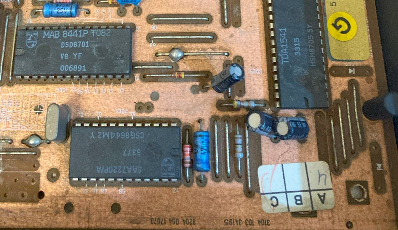

changed all the caps on the decoder board. I first changed the ones relating to power despite none showing as faulty. I measured the DC voltage getting to the servo board from the decoder board and it is close to specification, but not perfect. The two feeds that should be + and - 10v are between 11v and 12v (taking into account if they’re + or -). The other power feeds should be -6v and +5v; I’m reading about + and - 6v on both. Do these numbers look OK?
Still no joy, so I checked and changed all the remaining capacitors, both radial and blue axial, on the decoder board. Am I right in thinking they relate to sound processing? All the Philips blue axial ones were out of spec, so not a wasted effort.

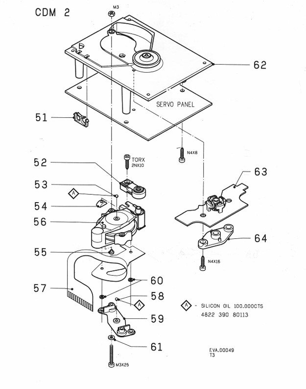

I think the failure to play is down to a mechanical rather than electronic issue. When they don't play there is a definite rubbing noise from the CD. I wonder it's the rubber bushings losing their damping/springiness properties over the years.

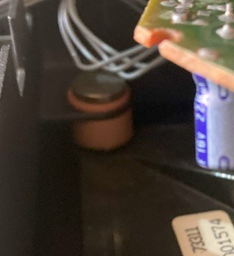

great to hear you solved it !! The issue with not playing directly and the rubbing may be caused by the fact that the CD is a bit too close to the lense. For this you might try to adjust the torx-screw on the motorspindle. Maybe a 1/4 turn would be enough (check out which way is up and which way is down). Best to mark the current location of the screw and then turn it a little bit.
Are you referring to the motor that drives the CD? On my version of the CDM2 there seems to be no height adjuster. The drive motor is held in place by a plastic retainer, part 64 on the diagram, that itself is secured at each end by a torx nut and bolt. I think the only way to adjust the motor height is by slacking off the retaining bolts. But, I'm not sure that is correct as I can't see how you would get each bolt slackened in sync to ensure the retainer is level. The actual swing arm motor is again held in place by in a similar way, part 59.
Or, are you referring to the torx-screw holding part 52, the laser itself?

As it's not playing, the usual first step is to replace the blue capacitor, 16v 33uf, on the servo board. General advice is to use a specific capacitor, but there are some that have just used a good quality one. Search for "capacitor 2013".

You mentioned: As it's not playing, the usual first step is to replace the blue capacitor, 16v 33uf, on the servo board. General advice is to use a specific capacitor, but there are some that have just used a good quality one. Search for "capacitor 2013".
I have not been able to locate this C2013 elco of 33uF on the Servo PCB schematic. Is there a TYPO error?
Part List does not address a C2013 either. Did you mean C2103 connected to the base of TR6108?
You're right, typo. Sorry, it should be 2103. It's the one in line with the variable resistor that controls the laser output. If you've got the same service manual as me, page 2-3 shows the servo board PCB 30 and its just above the resistor 3106. When you finally get to look at the board components you can't miss it.
