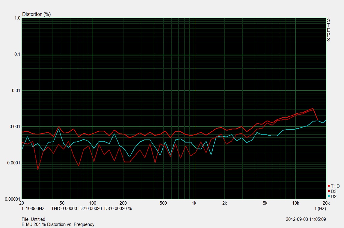

The first is %Distortion across the audio bandwidth: What this tells me is that Harmonic Distortion increases as frequency increases. THD rises above .001% 4khz and above.

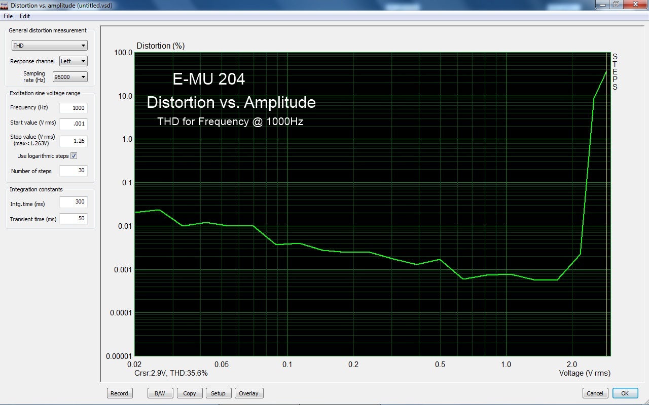

The next two screen grabs are the STEPS Distortion vs. Amplitude.
This is at 1KHz: This tells me that the lowest distortion results are obtained between .5 to 2 Vrms. Which is good because a lot of pre-amp and amp specs are reference at .775 Vrms (0dBu). I think most older audio equipment have higher distortion levels at this amplitude, so I should be to get fairly accurate readings with this card.

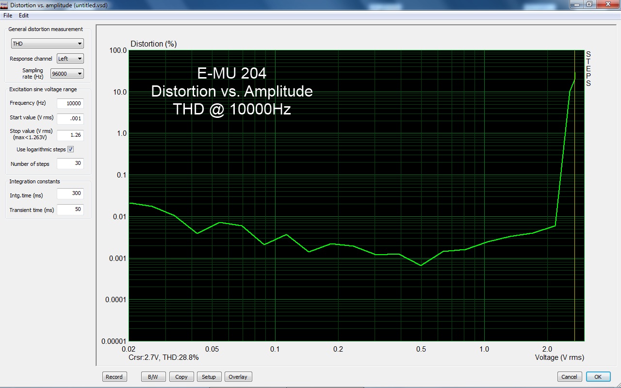

This is at 10KHz: This tells me that the lowerst distortion is obtain with output levels at .5Vrms. Not the best performance, but as long as I am aware and consider this data when doing audio performance test using 10KHz I should be ok.

All in all that's a nice set of results.
The fact that THD rises with increasing frequency isn't a surprise as this happens in the vast majority of audio devices. Usually it's the result of the amount of feedback being reduced as frequency increases, this is done to maintain stability, but as the feedback is reduced, THD therefore increases, as the feedback's corrective ability decreases. Blameless power amps follow similar trends, being 0.0005% say at low frequencies, rising to around 0.005% by 10kHz. Given the performance of the sound card you would definitely be able to confirm if your blameless power amp was performing correctly (ie you have successfully dealt with all gross issues), but you wouldn't be able to give a precise level for the amount of THD it produces. You also have to pay attention to the higher order harmonics too. For example if the higher order harmonics in the sound card are very very low, then you'd still be able to measure the presence of crossover distortion in a power amp or similar.
The one thing you have to bear in mind about the distortion vs signal level is that the measurement process only adjusts the output level of the signal generator, it does not alter the recording level. Now on some sound cards they have a resistor based attenuator BEFORE the ADC and this is important because it allows you to cut the signal amplitude before it goes through the ADCs pre circuitry and the converter itself. This being instead of the signal being fed directly to the ADC and then any attenuation being attenuated applied after the conversion process.
With the latter, if you were feeding a signal into the ADC that was causing the input circuitry to clip, then reducing the input level wouldn't fix the clipping. Sure, the signal level would appear reduced on the screen, but it would just be a reduced version of the clipped signal.
As you'll have guessed, with the former, if one can alter the signal level before it reaches the ADC and it's pre circuitry, then you have the ability to stop the input from clipping by altering the input level.
Why is this important? In the second case it isn't as you have no control over anything analogue and attenuating the signal digitally wont give you anything more, all it will do is reduce the signal to noise ratio. However, if you've got an ADC with an analogue attenuator before it, this does give you some extra options for fine tuning.
It might be that the DAC reaches its lowest THD at an output level of say 0.8 volts RMS, but the ADC has its lowest point at an input level of 0.5 volts RMS. If you were performing a loop back under these conditions then you would never get the two crossing one another, however if you've got an attentuator before the ADC, you how have the ability to reduce the input level so that when the DAC reaches 0.8 volts, only 0.5 volts reaches the ADC.
Finding out the sweet spot on the output and the input can be a little tricky, but once you're fully aware of your systems performance you can work around it to get the most out of the system. Like when measuring a power amp for example, you almost always use a resistor divider after the amp to reduce the high level signal amplitude so that the sound cards inputs aren't fried. When you do this, set the sound cards output to the value that gives its lowest THD, then set the resistor divider after the amplifier so that the signal level that the sound card sees on its input also falls at the point where it measures the lowest THD.
Now that might require a pot on both the sound cards input and output and would likely not be needed for most measurements anyway, but if you really needed that extra zero or few % for measuring something difficult, then it'd be worthwhile.
The nice thing with a lot of this is even if the signal to noise ratio is reduced by setting the amplitudes to the sound cards sweet spots, it doesn't matter. You're doing this to measure the lowest THD. If though you want to really see what the highest signal to noise ratio is that you can coax out of a piece of equipment, then just turn the output and inputs up so that the maximum dynamic range of the sound card is being used. Sure distortion might go up, but in this case you don't care about that as you want to measure the noise floor instead.

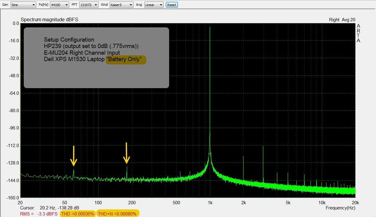

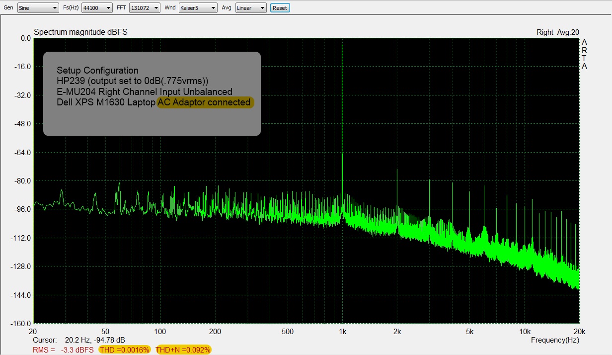

I found out that my laptop generates a lot of noise with connected to the AC source. Pulling the AC jack and conducting ARTA test on battery only produce some great results in THD and THD+Noise.
As suggested by BFNY, I also got better results from my HP239 Generator.
1. The first screen grab is my setup using Hp239 to E-MU-204 to Dell Laptop (AC/DC) supply connected. The results are to not pretty.
2. The next screen grab is the same setup but with the laptop on battery power. Big difference, but I still see some 60 Hz & 180 Hz artifacts.

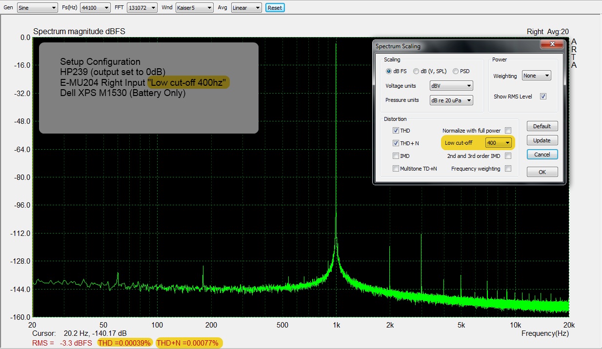

3. The last screen grab Laptop on battery power and Low frequency cut-off set at 400hz. This trick I found playing around with ARTA. This really improved the THD + Noise figure by ignoring the AC artifacts I assume are from overhead lights or the HP239.
I also found that my wife's Toshiba Laptop produced even poorer results both with AC/DC connected and on battery.
So everything in the setup including the PC/Laptop can impact the results. I wonder if there are laptops that are manufactured with better shielding and power supplies.
