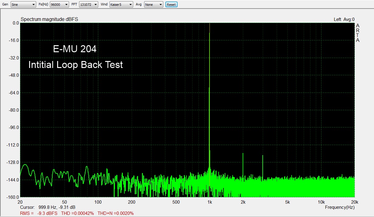

I just received a new E-MU 204 External USB Card. I am running it on my Dell Laptop with Win 7 64Bit OS.
I like what I see so far.

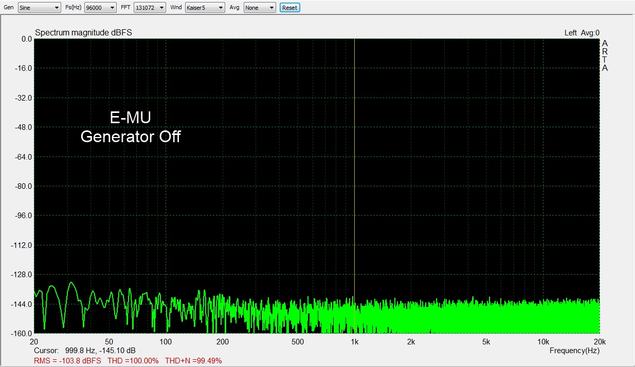

Please take a look at my screen grabs. The first is with ARTA Generator on. The second with the same levels and the generator turned off. I adjusted the levels for the lowest THD + Noise.
How do they look? How do I determine the noise floor of this card? I am just not sure what I am looking at.

That looks like very decent performance. The thd at 0.0004% makes the card suitable for a lot of things. Try firing STEPS and doing a 20-20k measurement, you can also do a measurement of amplitude vs distortion too.
The noise isn't amazingly low but it's low enough. The fact the adc/dac only seems to show second and third harmonics is good also, but perhaps if the noise floor was lower they might be apparent. Of course the Noise + thd value is degraded simply because the signal level has been reduced for the best thd value.

On many of these sound cards, the generator (DAC) is not as good as the ADC. Usually performance can be improved with a good external low distortion sine generator. HP339A, Tek SG505, etc.
Also note there will be high frequency, out of audio band noise (~MHz) from the sound card source as well. You'll easily see it on a 100MHz or greater scope
Also the software used to generate sine wave can have an influence. I have not played with this for a while, so can't say how ARTA does in this area, but it looks pretty good. There was an older thread here with measurements back around 2009 see my comments and measurements starting here

I am still not sure how to determine the noise floor of the E-MU with the sample screen shots I provided above.
What is the noise floor measure in? dBFS, dBV, dBu.

From those two graphs I would say that the noise would be at -103.8dB.

@5th - Thanks. That is exactly what I thought the noise floor was. So I was correct in my set up. First establish a decent spectrum scan and then turn off the generator. What ever the RMS value is in the lower left is the noise floor. Easy.

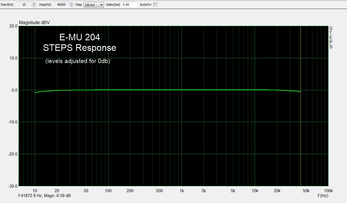

Here is my STEPS scan. I am still working on the "amplitude vs distortion" scan. But I am close.

That's just the frequency response (which looks good btw). Run the sweep again but then increase the vertical scale so that 0dB is near the top and then say something like -130dB is at the bottom, then you'll get the harmonics plotted and we can get a good measurement of distortion vs frequency. You can alternatively click on the % button and it'll open a new window where distortion is shown as a %. I prefer the % window generally but the decibel scale csn also be useful.
