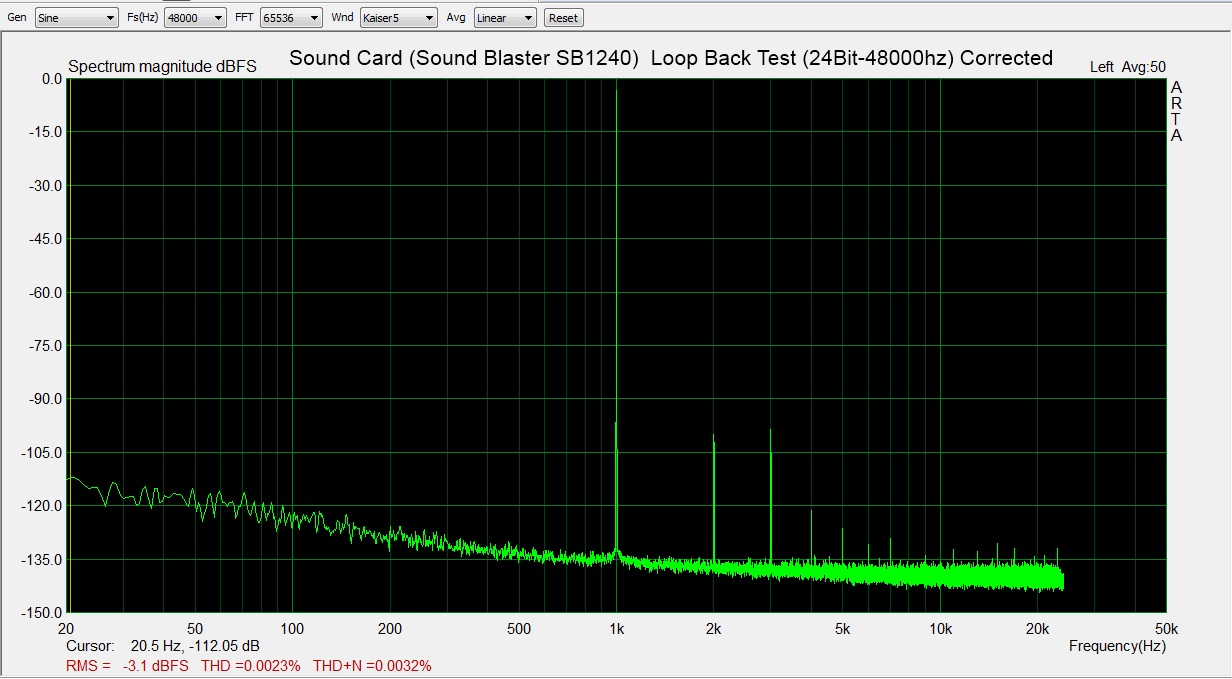

Using any Software Analyzers is new to me. I have played with most over the last month and have settled on ARTA for the time being.
My goal: To use this software to conduct performance testing and troubleshooting of audio equipment I am working on. Pre-amp and amps.
I am building Pete Millett's Sound Card Interface (documented on this site). I am waiting on a new external sound card (M-Audio profire 610). I will be hooking these up to my Dell XPS Laptop (Win7 Pro 64Bit OS).
To familiarize myself with ARTA I am playing with my older Creative Labs Sound Blaster THX SB1240 USB Card and my Dell.
I have the card in loop back running spectrum and frequency response test.
The card is advertised as a 24Bit, 96000hz in/out device.

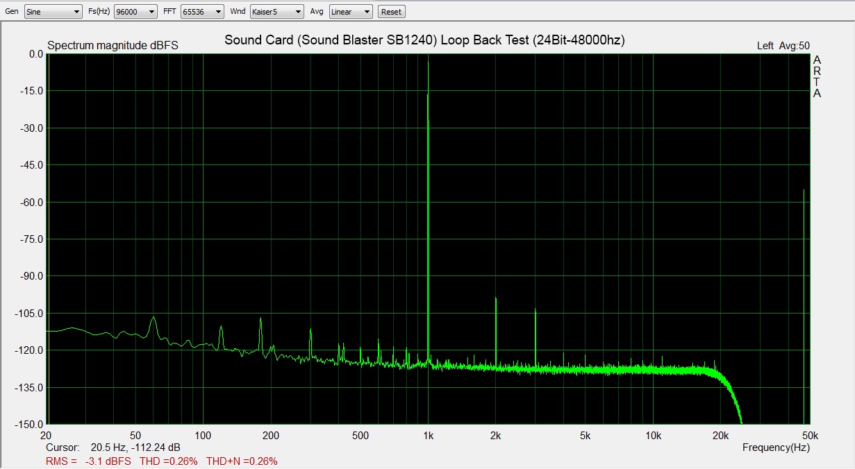

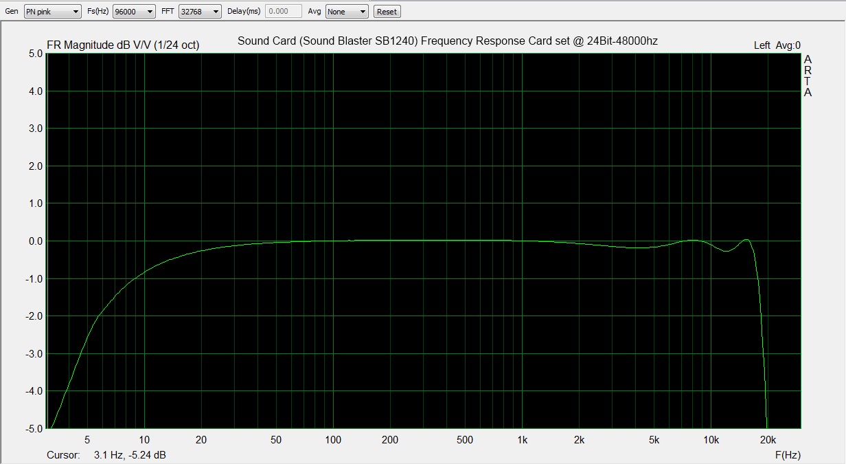

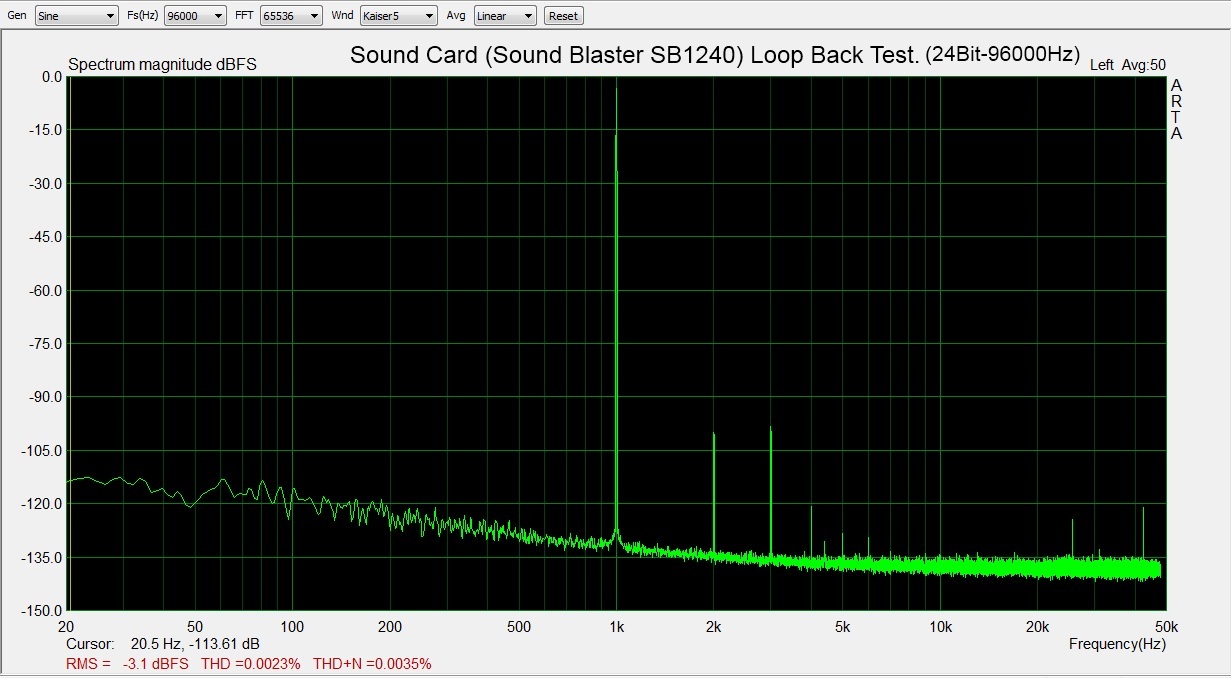

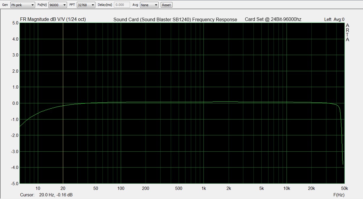

I have run test using 24Bit,96khz as well as 24Bit,48khz.
The results between the two are quite different. I don't know which to trust. In fact neither setting may be accurate.
It is my understanding that the 24Bit setting determines dynamic range, and the sampling rate determines the bandwidth of the device.
I would expect the test result would be the same. Using the 96khz sampling rate produces the best results in THD, THD + Noise, and Frequency Response is much flatter over a larger bandwidth.
I am sure there are some forum members here that are quite familiar with the software. Please set me straight.
Here are the results in pictures (Notice I have set the 1khz level the same in both spectrum test)

Picture three is what happens with some cards when re-sampling is involved. In other words the card's hardware is running at 96kHz and windows/SB software, resamples the 48kHz signal up to 96. Obviously having the ARTA sampling frequency set to 96kHz means that the software no longer has to resample and the results improve somewhat.
As you have surmised, the sampling rate does set the bandwidth of the system and we can see from your fourth graph that the device does indeed function fully up to the ~50k bandwidth allowed by a 96kHz sampling frequency.
Now if we compare the THD graphs run from the spectrum analyser we end up with a situation that is fairly common and in this case you should not rely on the actual numbers that ARTA is providing, but to eye the harmonics yourself.
First of all you will notice that the noise floor has risen slighty between 48kHz and 96kHz, this is what you'd expect to happen when you increase the measurement bandwidth as more noise gets in.
Second though is the second and third harmonics, going from 48>96k results in the second harmonic falling ever so slightly but you've got a large increase in third harmonic. Also with 96kHz you have some spikes appearing beyond 20k that were not measured at 48k as the bandwidth was limited. The third thing to notice though is that in the 48k plot you've got a large spike appearing at just under 50k, this is the result of having ARTA set to 96k, and so it's expecting to receive 96k data, but having your hardware set to only 48k.
It is very important in these situation to make sure that the software sampling frequency is set to that of the hardware, otherwise you get artefacts appearing that cloud the measurements. The first example here being the wiggly top end with the 48k frequency response and then the second being the large spike at ~50k ARTA is enterpreting the spike as some harmonic distortion, which is why the THD % is so high for the 48k measurement.
Thanks 5th Element! I see and understand what you have said. I have corrected the 48khz specktrum.
THD in both the 96khz and 48khz is the same. Now I feel better.

Try loading up STEPS (part of the ARTA package) and run a stepped sine distortion measurement. This will give you a good indication of what the cards performance is like at frequencies other then 1kHz. If it's THD is flat up very high in frequency then one could say that it's far more useful then a card that could exhibit a strong rise in distortion with increasing frequency. You could also run a distortion sweep of amplitude vs distortion to see how the card performs at lower signal levels too.
Certainly though for a $60 product that's nothing to be ashamed of, the fact that it is only the second and third harmonics that are dominant, with the tall order harmonics a nice way down is also nice.
Whether or not this is useful depends on what your goals are. If all you're going to use this for are frequency and distortion measurements of loudspeakers, then ~0.004% is more then enough, as is it more then enough for measuring the current tech in most class D amplifiers too, not to mention a lot of tube designs and verifying if active xovers are working properly. But if you want it to be able to assure you that your 0.0003% DAC/headphone amp, or ultra low distortion blameless power-amp and a matching pre-amp are working to spec, then you'll need to get something better.

Regarding the 2nd and 3rd harmonics in the loopback test - try reducing the master output volume and/or the record level in the sound mixer application. On many sound cards running both at maximum will increase harmonic distortion significantly.
On my Soundblaster Audigy 2 ZS I set both to about -1 to -2dB to avoid this. Try adjusting the sound mixer sliders while in the real time analyser mode and see if you notice a sudden drop in the harmonics as you turn the output or input levels down slightly.
I would echo 5th elements advice regarding sticking to native sample rates - it looks like 48Khz is being resampled, so I would avoid that altogether. I do all my measurements in 96Khz 24bit regardless of whether the test needs the bandwidth or not, just to be sure I'm running in a native sample rate with a known calibration.
Although my card also supports 48Khz 16bit natively the amplitude calibration is different, which means if you're doing calibrated measurements you'll need to re-verify calibration if you change sample rates. Just stick to one native sample rate and you'll be fine...
