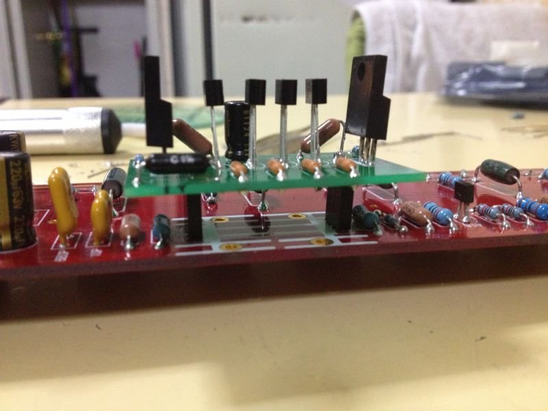

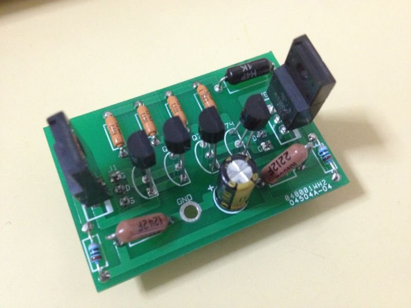

I decide to first make one test daughterboard using only "spare jfets" to avoid damage in case of a design error. I use very unmatched LSJ74 b-grade, the assembly took to me about 1 hour. Also I replace on the Aleph-2 main board, the single resistor R11 (offset adjunst) by 2 resistors in parallel plus a trim pot with the same values that Graeme used in his Aleph-X 100J design.

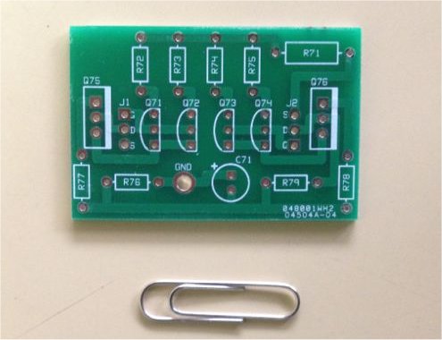

On the first image is the board, the resistors should be larger to be able to acommodate bigger ones, like Dale RN55 or RN60 series, beginner mistake.
The second image shows the populated test daughterboard, and the third is the board finally mounted on the Aleph 2 main board. The spacing was perfect, so they fit without problems.
At power on the most important was no burn component 🙂, the offset with the jfets installed start on +12mv and it begins to decrease to -16mv (with IRF9610 normally start on +8 and decrease near to zero). I wait about one hour, take some electrical measurements, all seems to be fine.

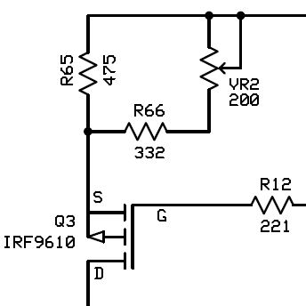

When I first changed the front-end to JFets the DC offset was raised a little out of a reasonable margin, I was warned by Zen Mod about that, so I replaced the R11 (221R) resistor with a combination of a two resistors (R65 & R66) and a trim pot (VR2), see attached image, this let me adjust the DC offset to near +/- 5mV, but after a long period of more than 2 hours after the amplifier get warn, the JFets tend to change a lot with temp drift.
