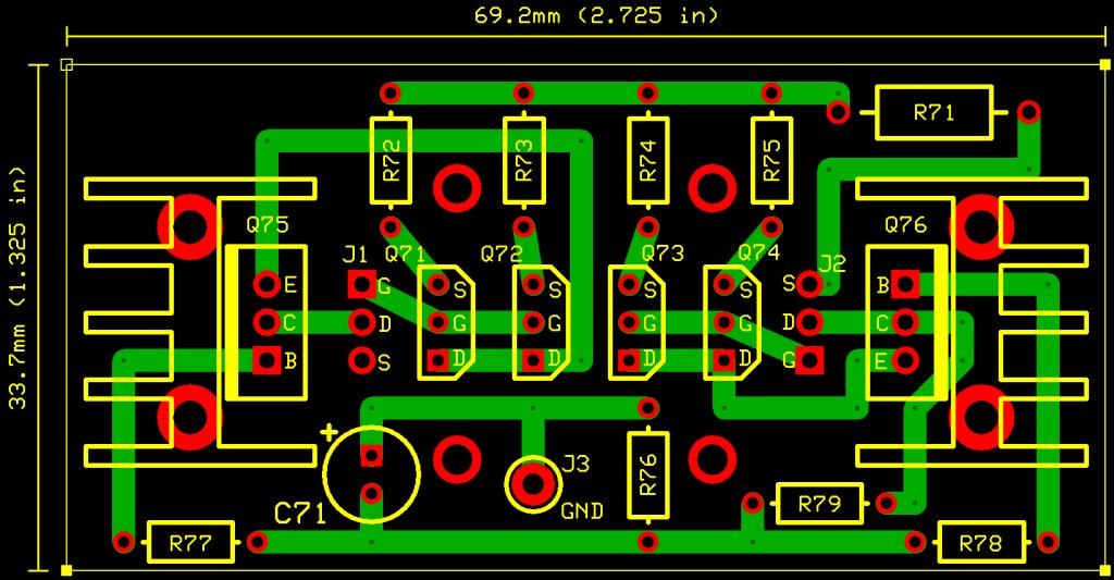

A quick look it's OK. Not shown, but you will heat sink the cascodes, right?
I'm really do not have consider heatsinks for the cascodes, a least until now, I had build an F5 Turbo V3 a few months ago with +/- 41v power supply without heat problems on cascodes, but I'm open to incorporate any suggested impovement.

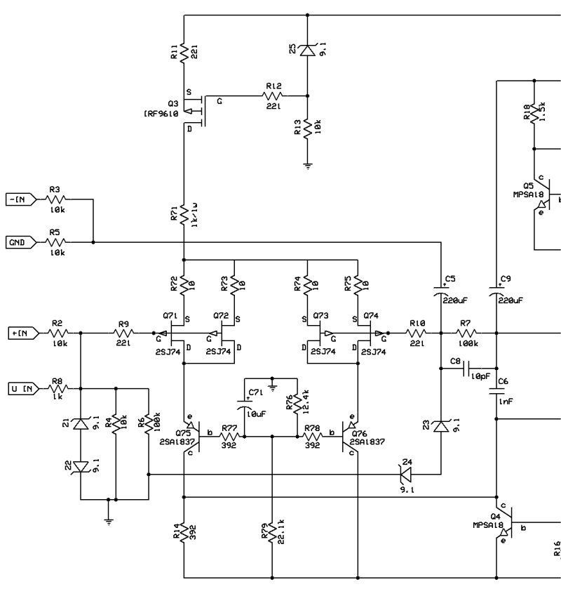

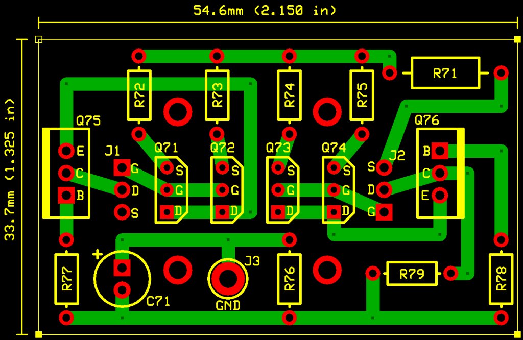

New Schema & Board w/2SA1837 Cascodes and Heatsinks
I had changed the BC556 by the 2SA1837 for cascodes and incorporated heatsinks. The board is now bigger and heavy, so I added four holes to fix it to the monting holes of the IRF9610's heatsinks on the mainboard.
Also R71 (1w) & C71 have a bigger size on the daughterboard to support more alternatives of resistors and capacitors.

The 2SA1837 are enough bigger to use it without heatsinks, it's a good new for me, I really didn't hope so.
Now I need to draw the board without heatsinks.
Thanks Zen Mod.

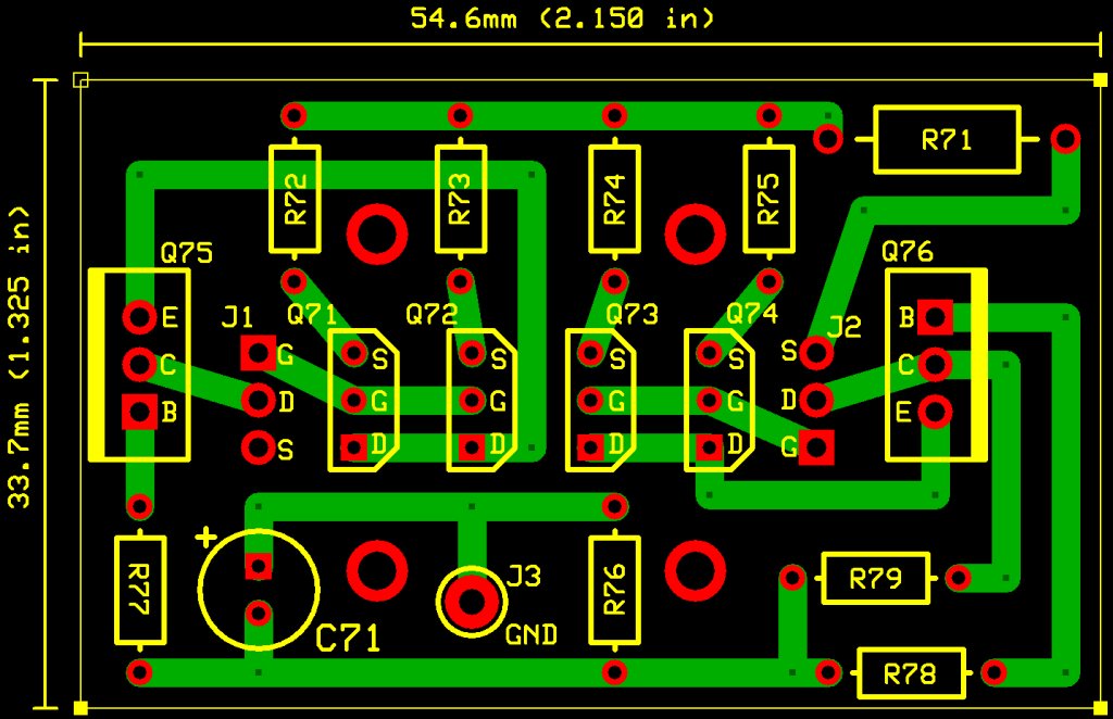

JFet daughterboard PCB w/2SA1837 cascodes w/o heatsinks (larger pads/same holes)
I had some limitations in the PCB software with the pads sizes and holes sizes combinations, I had increased the pad size keeping hole size where possible.
Alejandro
Alejandro
OK , do what's possible
point is that , with larger pads , entire pcb is of greater quality and durability
when pads are small , sometimes is enough to just take a look of it , and solder could break
You really should make all your trace angles 45 or 90 degrees. PC board layout is part of what I do for a living and odd ball angles are not cool.
This will clean up a couple of places where the traces potentially run too close to each other. I don't know what the design rules are for your fabricator - but I'm just saying.
Graeme
Graeme
Graeme

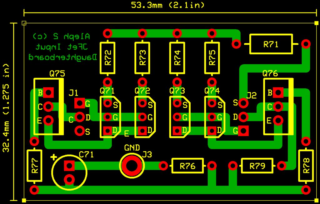

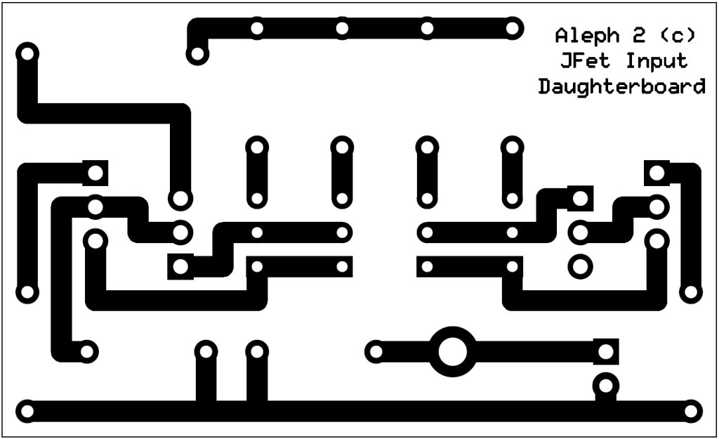

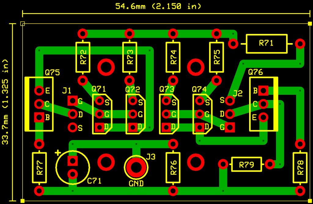

I'm just starting with PCB design, all comments are really welcome. I agree with you, the traces with odd angles are ugly and maybe they do not meet the clearance area between traces that fabricator states. I'm using a free PCB/Schematic application from ExpressPCB - Free PCB layout software - Low cost circuit boards - Top quality PCB manufacturing, it's really easy to use and has online order at a "reasonable" price for small orders, it lacks of the advanced features of professional apps, but it's a good for starters like me.
I had re-revised the PCB layout, now with only 90 degrees angles, Q75 rotated, more symmetry between left & right sides, the 4 holes for fix the daughterboard to the mainboard where also removed, some traces re-routed.
Attached you will find the new layout picture and also an image of only the bottom layer (copper side, not mirrored).

That looks much better. Very nice.
Please note - I'm just commenting on the way it looks. I didn't check the layout against the schematic.
Please keep us posted as you build and test this.
