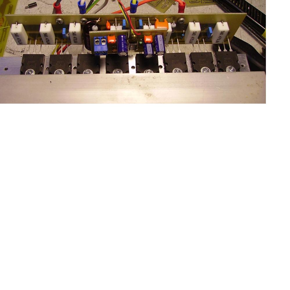

this what you see is the basic schematic
-there is a complete zobel in the output
-in earlier models this network C10-R10 C11-R11 was ommited
- in my version except 2drivers exist also 3pairs of outs 1943+5200 and a few other cahnges
- about thermal stabilize in erlier models on parallel of 220R (R7) was added a thermistor attached to the heat sink
-fully regulated psu for 15+15 volts ( even though the schematic say 16.5+16.5 ( havent tested this yet but i am working on this also )

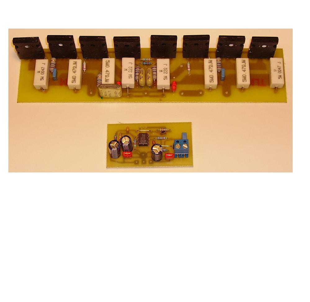

- ive also designed a pcb that includes the main board with all the heavy power stuff and a piggy board that includes all the small things like op amp and so on ( extremelly very compact and size of only 4cm x20 cm ) you can look at the picture ....
-also bench tests are doing just fine with only problems that this amp like many others was kinda sensitive to wiring and layout so you cannot make tests with 4 klm of cables arround you....
-finally let us not forget that this is an amp class AB+B so top of quality is not the target here but compact easy cheap and power full is more like it
real life tests are coming any day now and after that updated schematic ( and pcb why not !!!!) with a full set of wave forms will be presented in a few days

I asked about the original bias point because the output stage bias is not very well defined, being dependent on the driver bias point, driver & output beta, temperature, etc. It will be dependent on component to component variation without some form of feedback.
You mention a thermister that you might want to duplicate from the original design. A diode string or Vbe multiplier are other solutions as I'm sure you know.
Larger emitter resistors on the outputs will also help thermal stability but are not a complete solution.
Just noticed that drivers and outputs are the same devices, that is some overkill on the drivers, but on the other hand I think that they're often undersized when temp and SOA are considered.
