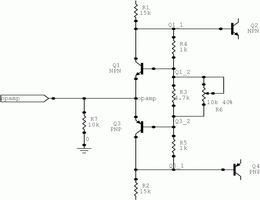

I am a big fan of simple amplifiers. This amplifier no doubt will sound good. I would be concerned for my speakers though since there is no thermal compensation. I am the last one to say to make a circuit more complicated, but, adding a better bias circuit would benifit this amp. Attached is a very good way of doing this with opamp input. Using mpsa06/56 as q1 and q3. This will give a way to adjust idle current for the output as well.

Varying R26/27 will change the idle current through Q1/2 as well as Q3/4/5/6 ect.. It will also change the load presented to the opamp. This is also an advantage that the adjustable bias circuit has in that the load seen by the opamp will remain fairly constant. Unless you do beta matching so the bjts are the same for both channels these resistors can end up being different values for each channel to get the same idle current through the outputs. A very bothersome way to do things. Replacing R26/27 with current sources or bootstraps would further improve things as well as helping with power supply noise rejection.

Question 1: If these resistors are different between the channels there would be a slight difference in gain/feedback but probly not enough to make a difference.
Question 2: Just keep the high current traces away from the low current signal traces and there shouldn't be a problem.
jerluwoo

Please Jerluwoo, post a more complete schematic.
Your idea to substitute chips is very interesting...but the schematic is not complete...put supply voltages, filters, inform voltages and currents for us...a more detailed thing for us.... please.
I like... and very much.... the idea to substitute the input chip.. and in special if able to work into the same power amplifier voltage....not to have the audio swing limits resulted from the plus 15 and negative 15 volts DC supply.
Is this common base?.... strange way to connect the input.... but also very nice..... higher current together the input is very interesting.... having your input into the emitter, you can have more current "contribution" from the colector to emitter junction...this will change impedance.... interesting.
Please, if not asking too much...indicate the output current and voltage.... all transistor leads voltage and currents too.... say... the ones you suggest.... things you have made REAL world and listened...if made only into the simulator (untested real life) ...well.... this way will not be needed anymore, because i will not trust to try real life a sample of your circuit...i have simulator and i know the differences between them and real life.
Into your circuit, we will be able to introduce the off set control and bias control.

You will definitely want some sort of bias control that senses temperature, so mount these devices to the driver transistors for compensation. Replacing R26/27 with CCS's is a good improvement because if the line voltage fluctuates larger, the bias will remain constant.:up:

I have used monolithic transistor arrays and found them to be useless in positions requiring matched transistors. They also can crosstalk. It is just too convenient to be true.🙄 You can buy matched transistor arrays that are really separate matched dies such as those from THAT corp. and there are others. But they are EXPENSIVE.:bigeyes:
Compare 40 cents to about 7-8 dollars!! ...if you buy 10 or more.:bawling: :smash:
Thanks CBS240, should have mentioned to mount them on the heatsink. I first saw this configuration used in an early 90's USAmps car amplifier. Opamp TL074 input into triple EF output. The amplifier was rated a mere 40 watts into 4 ohm but made about 270 watts bridged into 1 ohm, it trully was capable of some mad current output.
