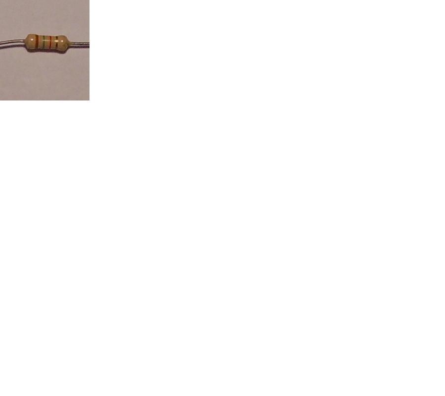

THE SOLUTION .......
YOU CAN CALL ME COLOUR BLIND ..... BUT I WAS PRETTY SURE THAT THE RESISTOR I USED FOR R26 R27 WAS 15K ....WELL IT WASNT ....IT ONLY LOOKED LIKE IT IT WAS 1K5 THAT WAS THE PROBLEM .....
now that we have an original working amplifier we can talk as much as you like about improovmets .....
here is a foto od the stupid resistor ....for sure looks like 15K
after all i have to thank all forum members for helping any way .....

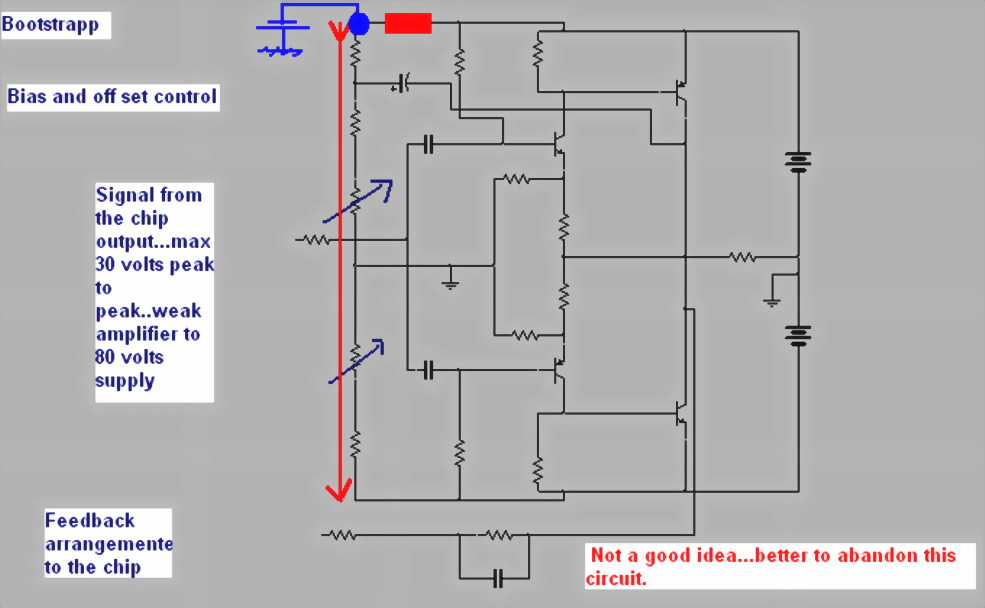

The amplifier is biased and controled by the voltage you have into the Chip output
The Dc voltage there, the potential will bias the transistors, so, it need to be precise there.
You have not off set or bias adjustment..if something is wrong, check the chip and the components you have around it.... as this one is responsable by the off set results and iddle current.
Do not tweak resistances.... the chip may be the problem...use the same suggested by the designer..do not try other ones.
To fix the problem, and to turn you able to operate this amplifier using other chips, alike the TL071 you like, you gonna need to make many changes into the feedback line, and maybe to couple the chip output using a capacitor to block DC and to to build a resistance network to bias your circuit... even a bootstrapp can be used... a series of resistances flowing current from positive to ground.... small current... from 5 to 15 miliamps flowing and calculating the voltages you gonna need into your driver input.
You will need something around 0.9 volts positive up and negative 0.9 volts into the bias resistance... audio can go using capacitor to each one of the drivers (two capacitors, one to each driver).... this bias resistance will adjust your operational point, but i am afraid you gonna face some off set problems.
I do not thing it is a good idea to explore this amplifier...it uses a chip... and the chip is the main controller..... well... this limits your range... you will not have too much room to tweak.
The small peak to peak audio level, from the chip, even if you find a good way to amplify a little, will be the limiting factor.
regards,
Carlos
