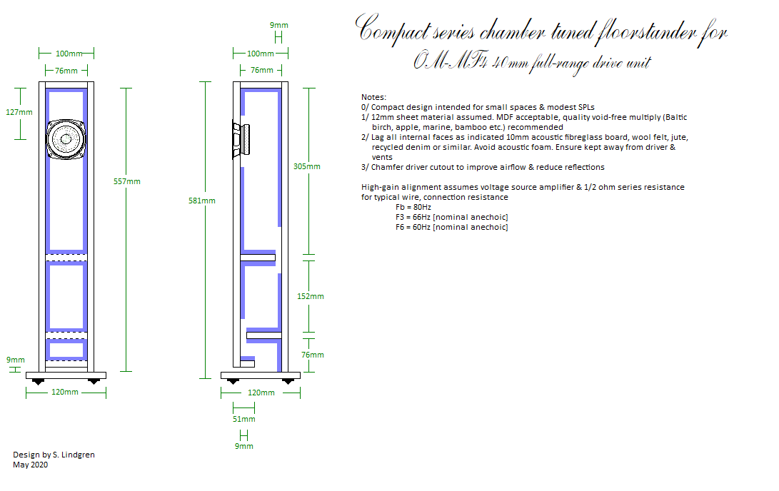

that's interesting - might the 2-1-1 ratio of chambers with all equal ports be something rather universal ?
not sure what the cascaded extension of the DBR can do
It's funny this topic should come up, because I happened to design this about a month back for the forthcoming Stereo Magazine (Japan) OM-MF4 drive unit.
