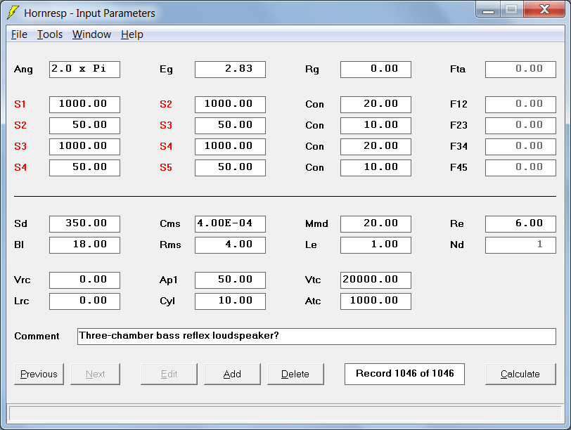

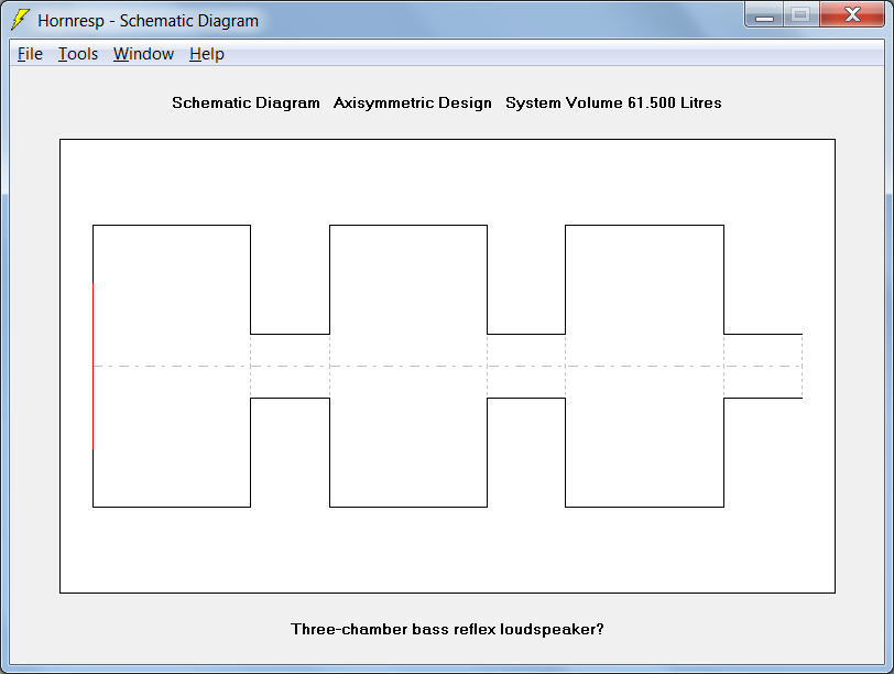

David - I've likely asked before but is there a way so simulate a 3-chamber bass reflex with hornresp ?

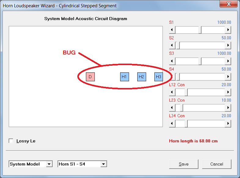

Hi freddi,
I'm not sure how you define your 3-chamber bass reflex topology, but if it is simply a third ported chamber added in series to a conventional DBR system, then such a design could be modelled in Hornresp as shown in Attachments 1 and 2.
Note that this particular design has brought to light a bug in the new system model schematic, which hopefully will be fixed in the next update 🙂.

Thanks David. FWIW I was thinking of extending the dual chamber reflex type with one more chamber. A non tech late friend did that as he said "designed on acid😀" for two five inch and two 1" domes - it sounded very good
Its interesting to see what happens in your example when all ports are shortened from 10cm to 1.8cm
