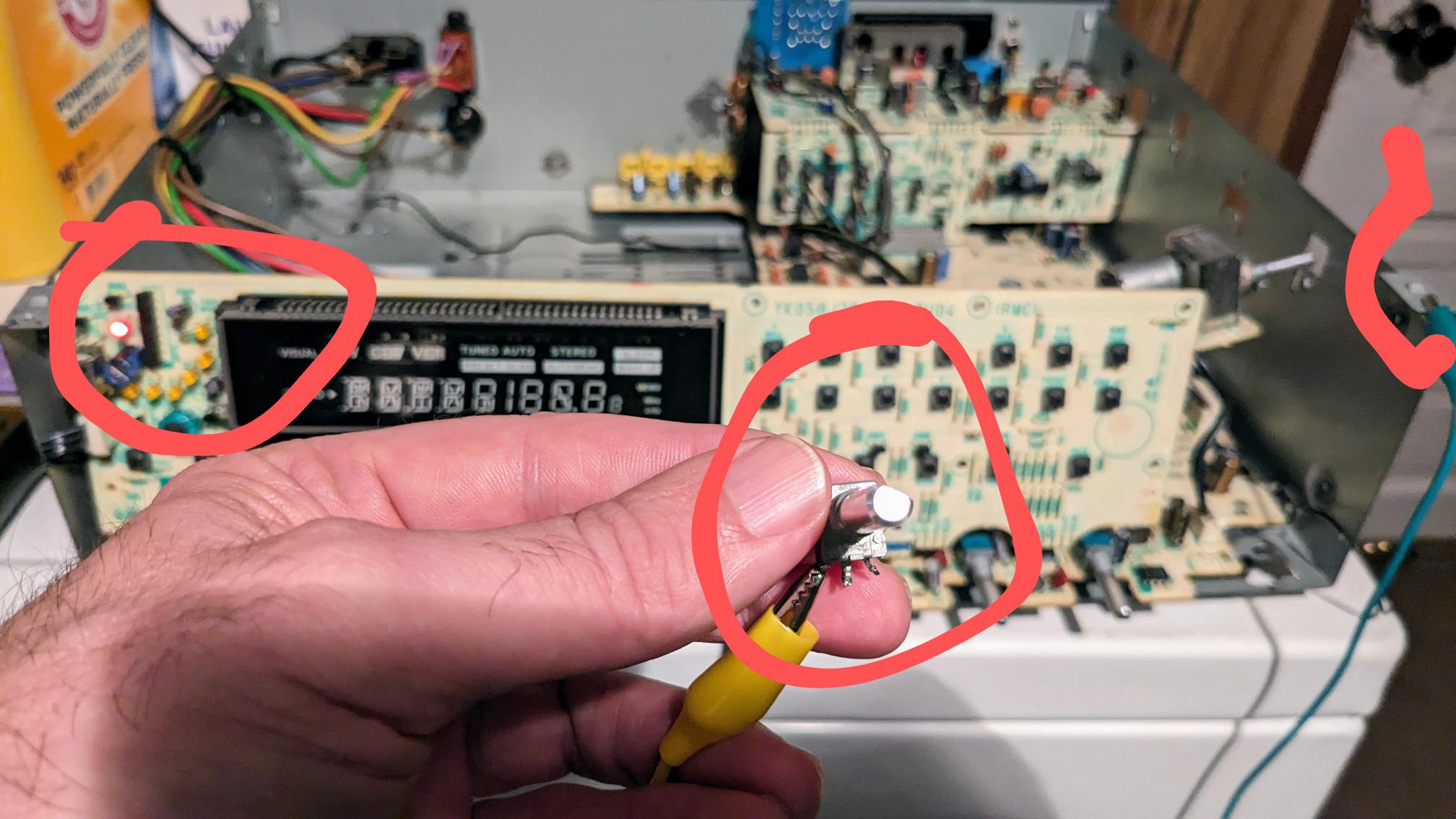

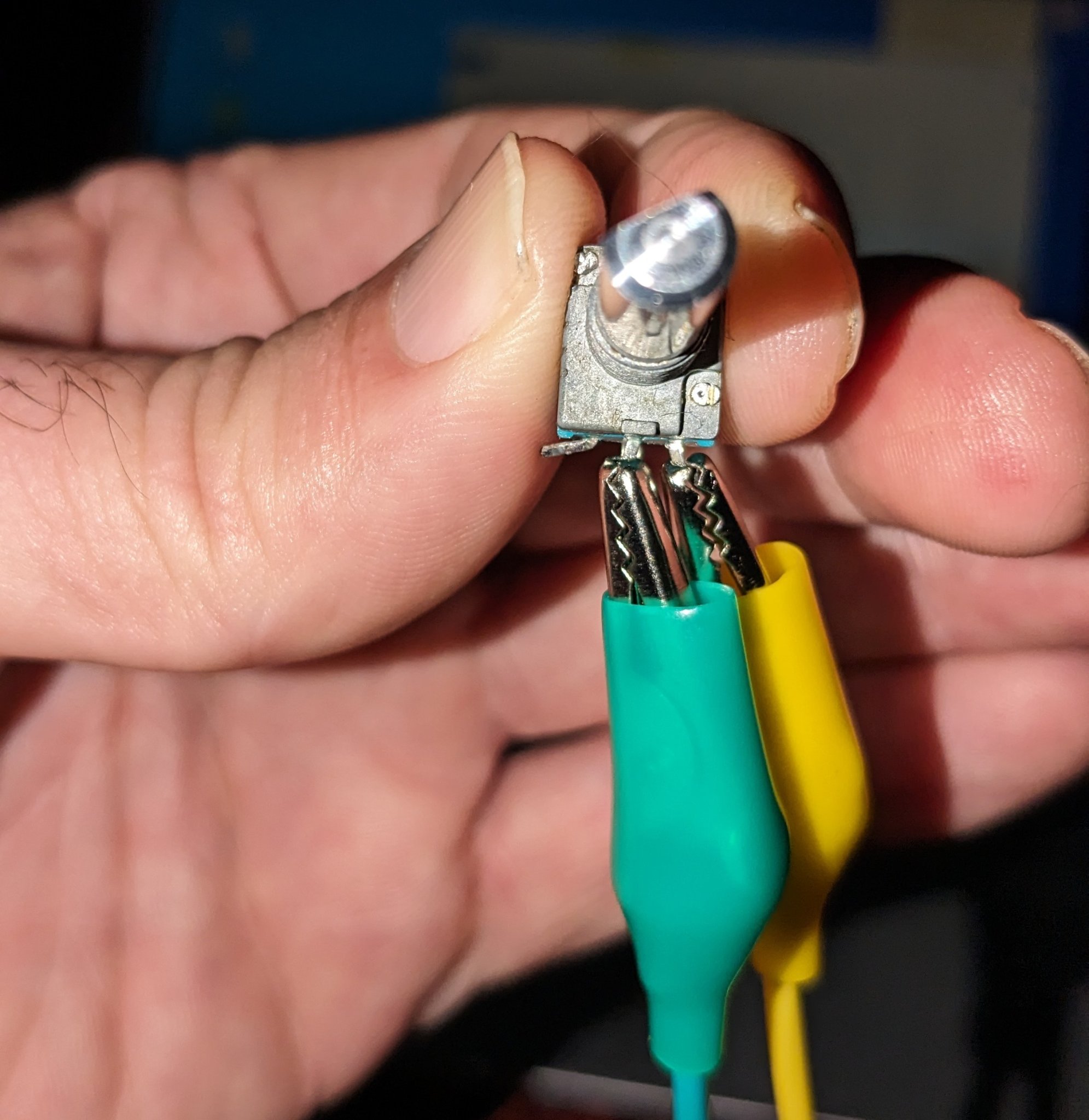

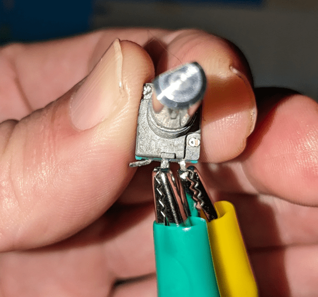

I've taken measurements and photos. All side (L or R) references are taken facing the shaft's end (see photo showing "R fully R"). I'm including all measurement photos, but also documented here:
MEASURING PIN ON LEFT SIDE

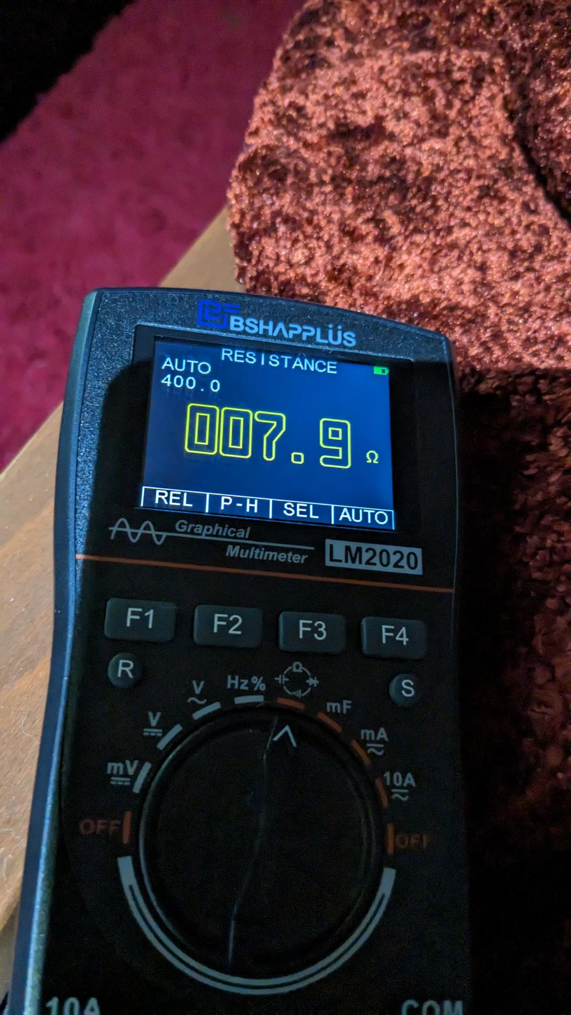

balance pot fully left = 10.6 ohms
pot at center detent = 44.9k ohms
pot fully right = 44.9k ohms
MEASURING PIN ON RIGHT SIDE
balance pot fully left = 44.8k ohms
pot at center detent = 44.8k ohms
pot fully right = 7.9 ohms (see photos for method example)

Okay, the original pot is special. It is resistive up to the centre point, then a short to the other end. That is so the level of the channel not being reduced remains constant.

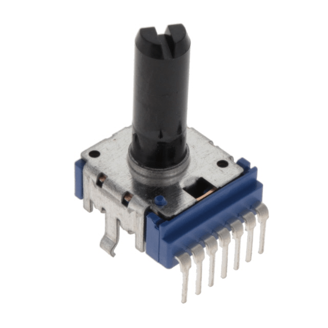

47K twin control, wire each channel separately.
6mm shaft.
You will find Alps, Bourns and others.
Digikey part number, for Bourns unit:118-PRS14R-30025-103B1-ND
Got this as a sample off Digikey site, no ties to them, this is just for giving an example.
That can be made to control your unit.

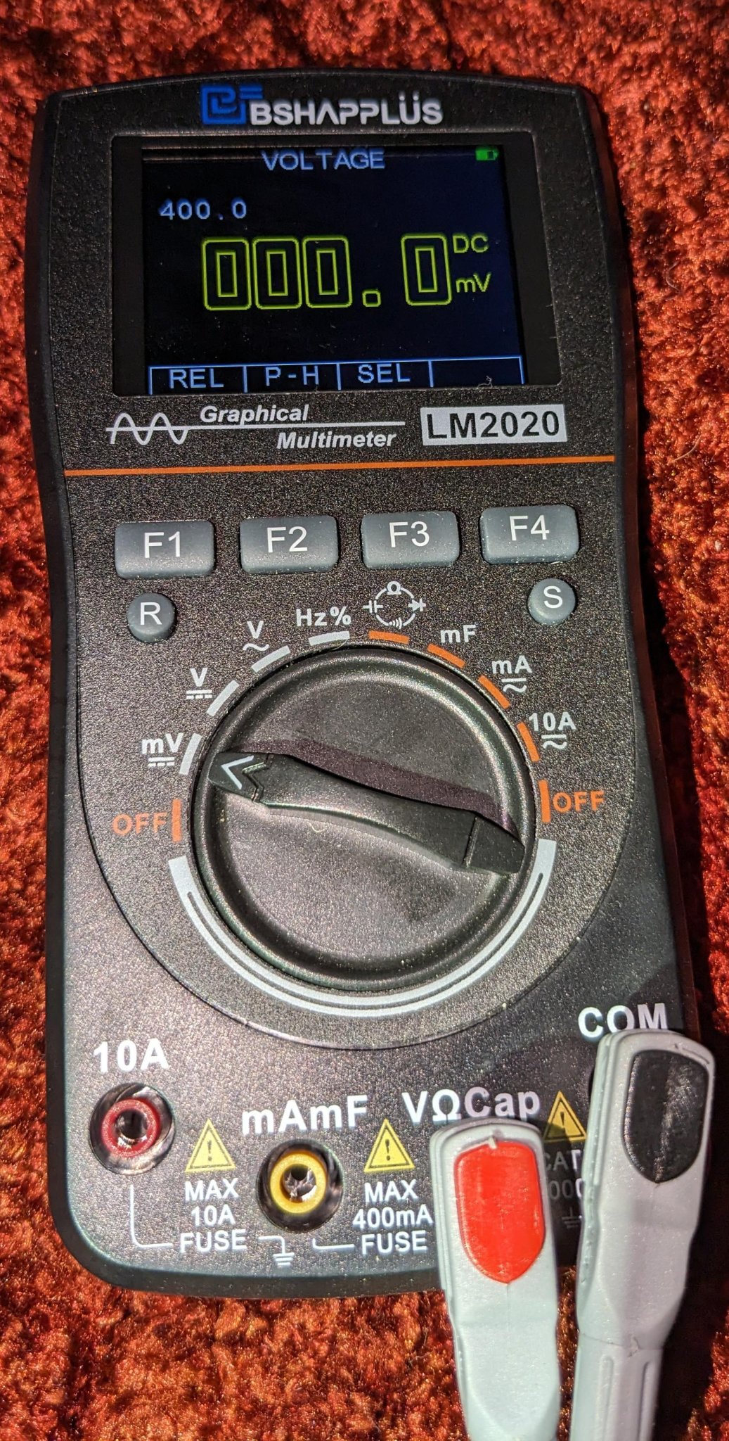

What you have not done is measured the DC voltage on the end pins or PCB pads. That meter isn't that good. I don't know if you will get meaningful readings on the mV scale. Try.
Done. You're right (I suspect) - no readings at any position., tried with clips on right & left pins, all through the shaft rotation for each side pin. I'm also presuming this is an Autorange unit, so there's nothing I can do about making it more sensitive.
Okay, so measuring on the pads with the control removed and the unit powered up, you read 0.0 mV DC on any pin or pad?

Yes, you need to measure on the circuit board with the unit powered on. We need to see if there is any leakage voltage on the control. Of course, if the control is out in the air, there can't be any voltage across it.
As I said earlier, any DC voltage on these controls that flows will make a good control noisy.
Okay, thanks.
So we know that DC voltage is not the culprit here.
