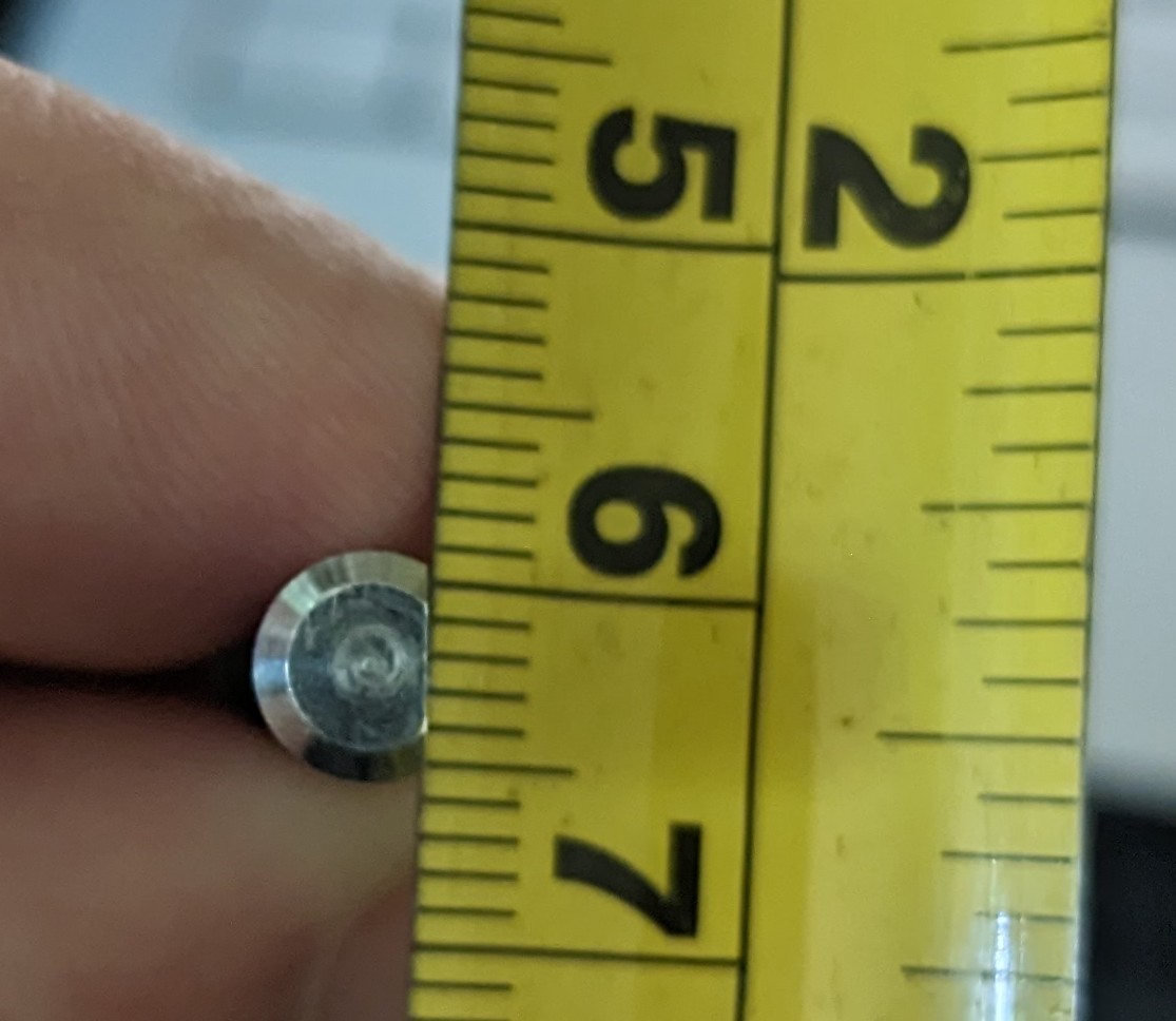

What I am seeing is a D shaft. I suppose that the shaft diameter is 6mm since I see other specs in mm. This is where it gets a bit hard sometimes, and I have adapted different knobs and shafts to fit, but it is a bitch. When you are all done, you also have to see that it isn't out of square in any direction. Yup, best to find an OEM.

Agreed, and please do. Please let me know if I can be of more help in this process. I've attached a photo of the shaft diameter (sorry I don't have a digital caliper)When you are all done, you also have to see that it isn't out of square in any direction. Yup, best to find an OEM.

You can measure the shaft and bushing however you want, just compare apples with apples.
It's probably metric, as will be the replacement, so a micrometer would be best to use.
Yes, a caliper would be most accurate. Roughly from what I see in the photo, it looks to be a 6.3mm/1/4" which was the common size back then. Carver equipment that I have worked on in the past is 1/4" shaft. You should look at the service manual at the 'Carver Site'. You may be able to get a better idea from it. There is a parts locator page, and then a parts list page as well.
