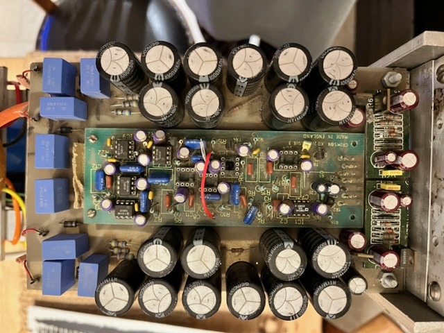

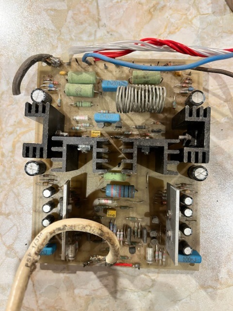

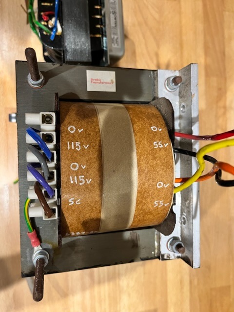

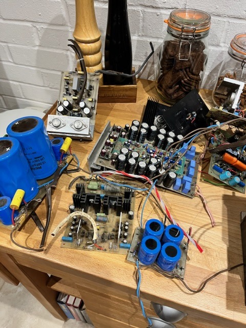

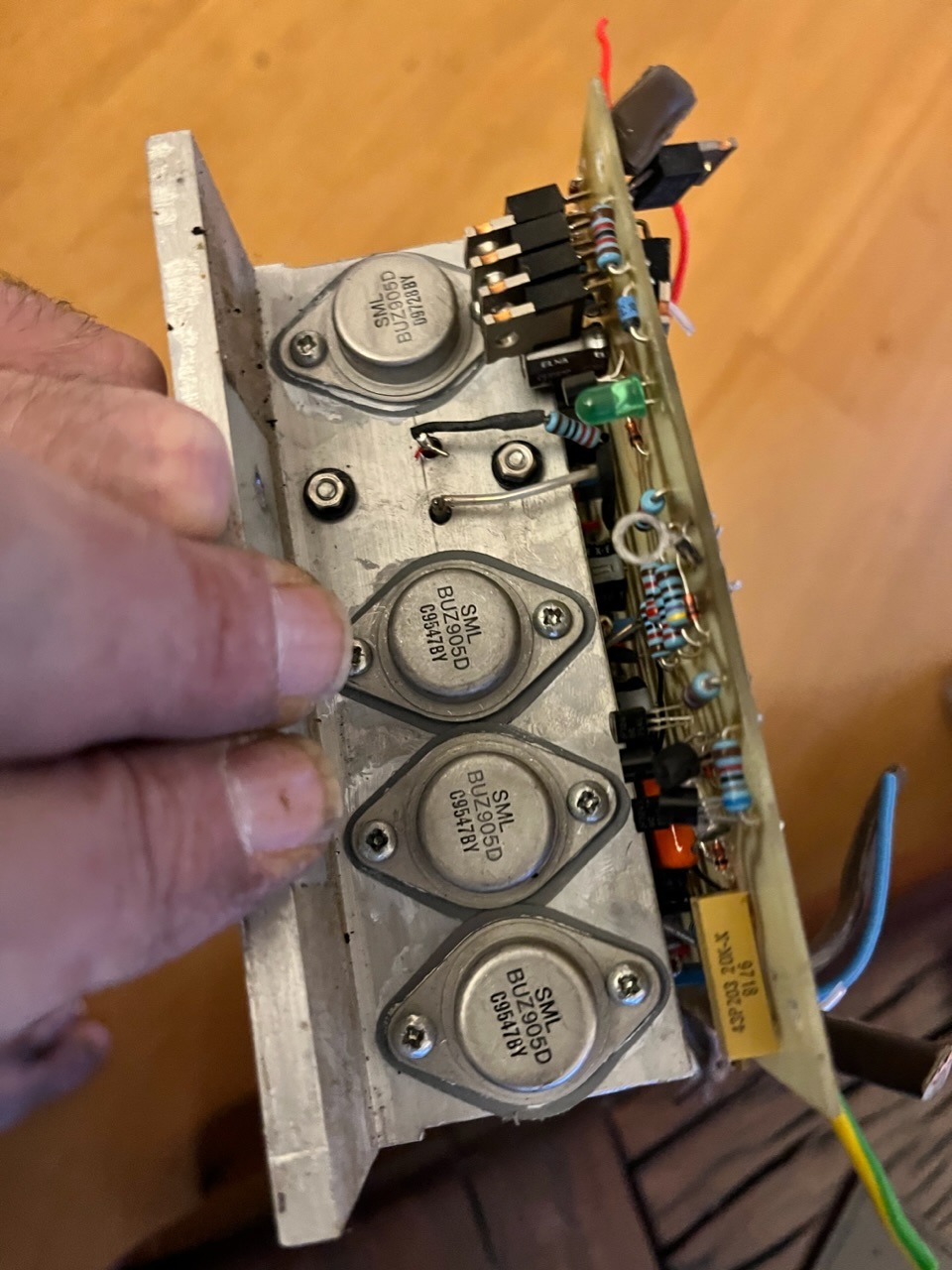

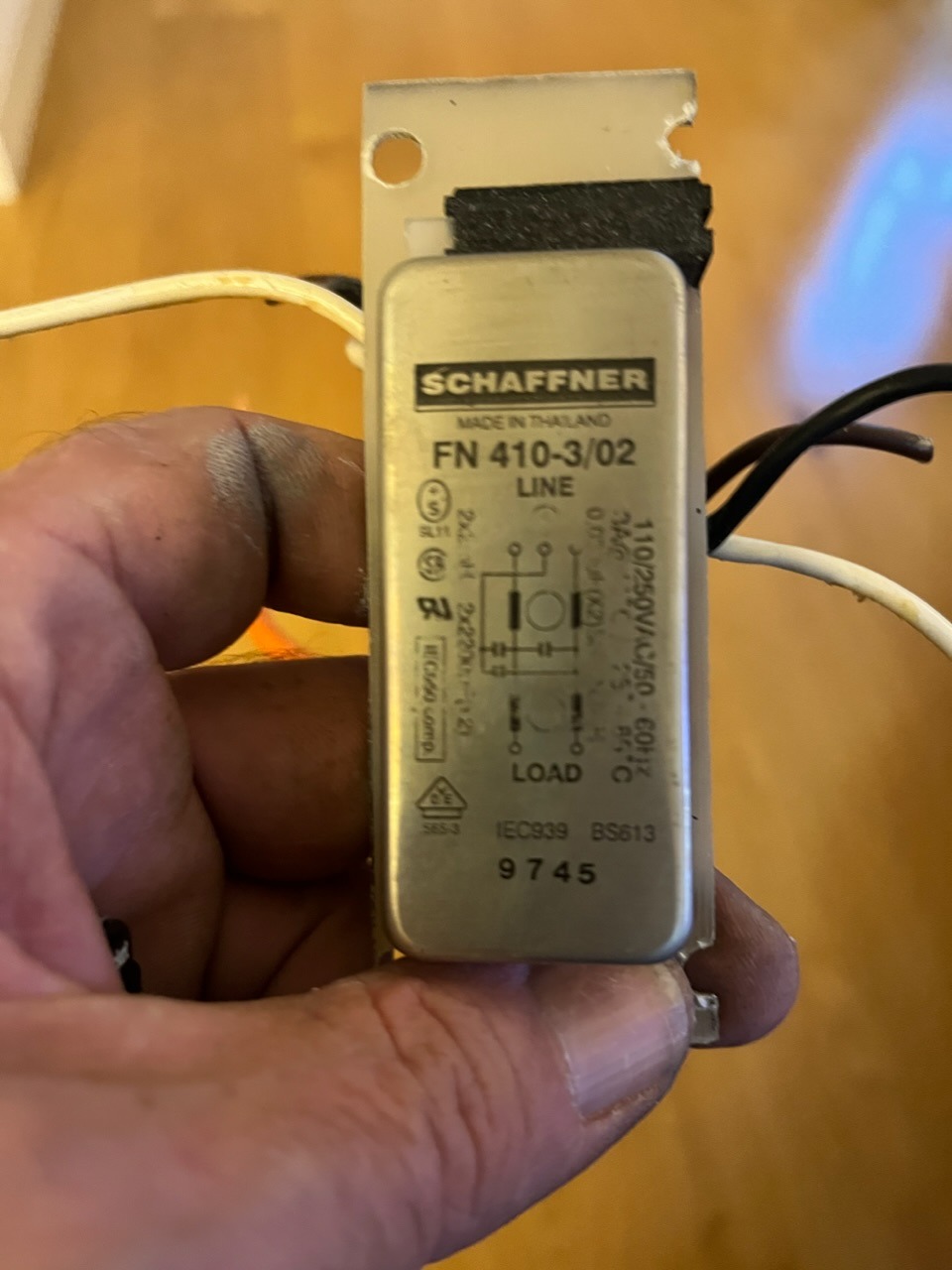

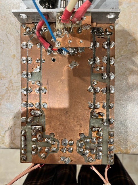

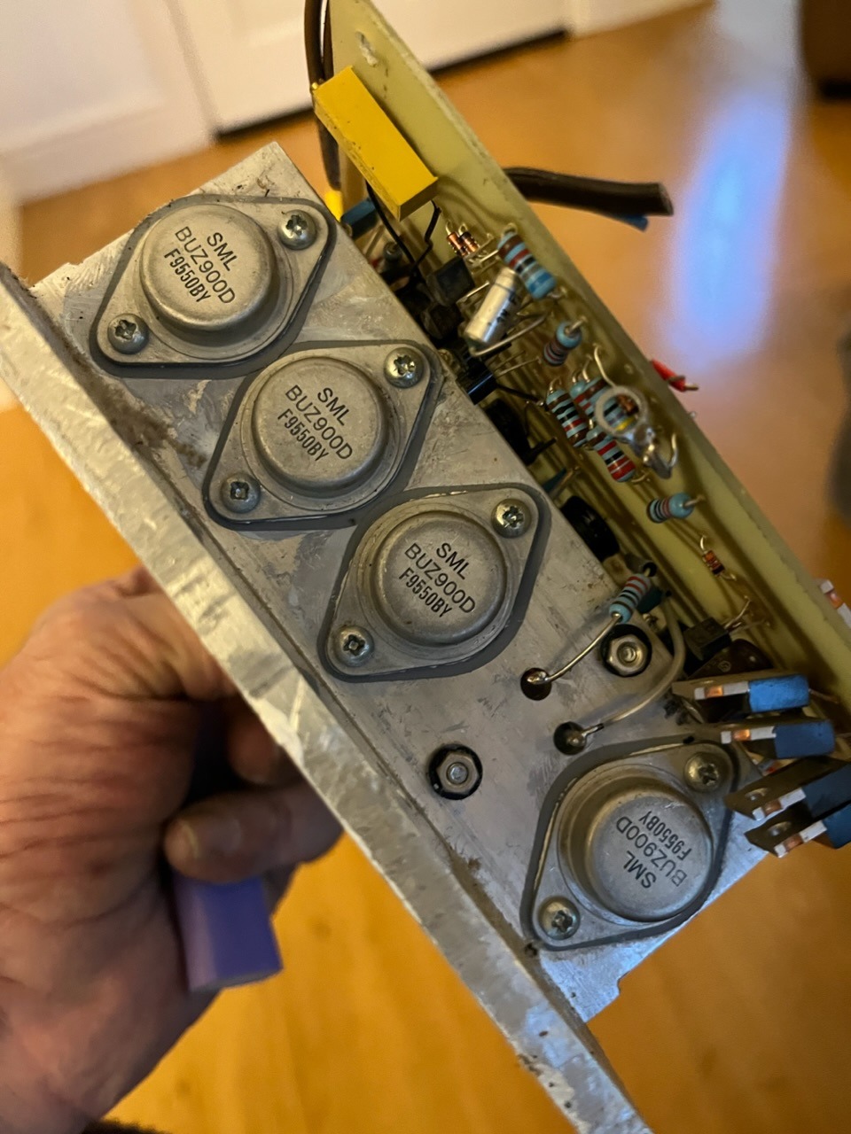

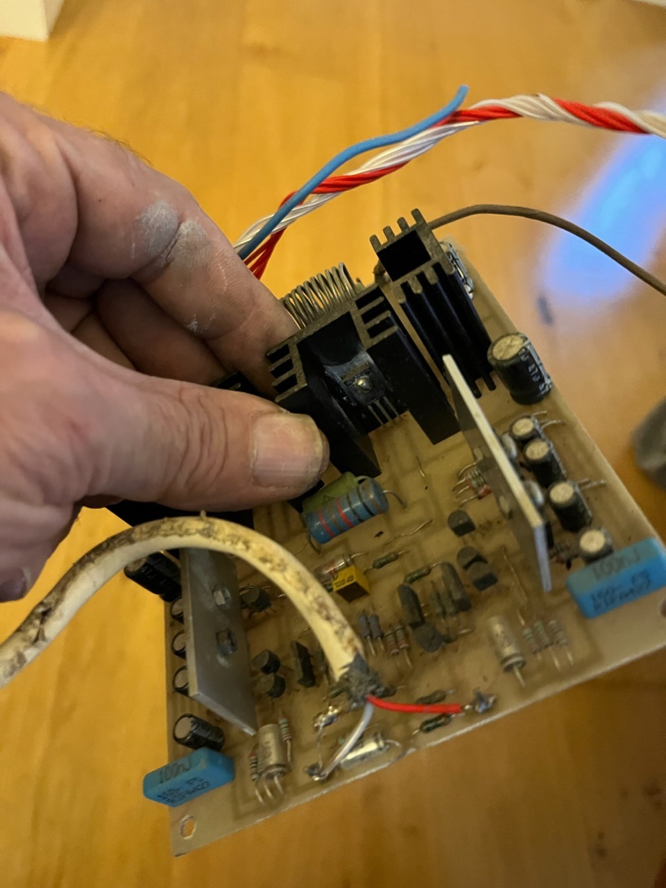

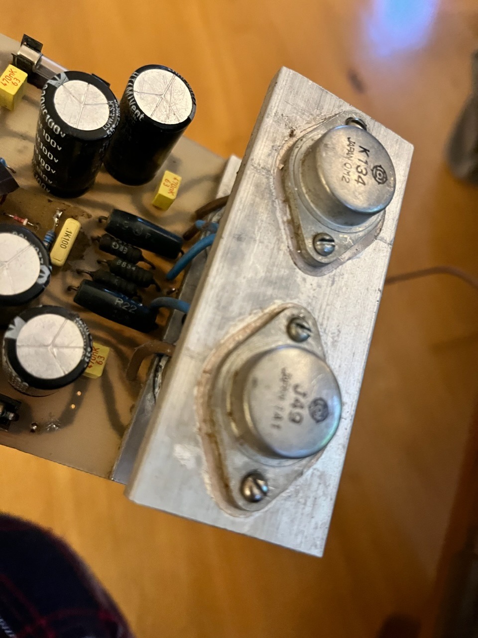

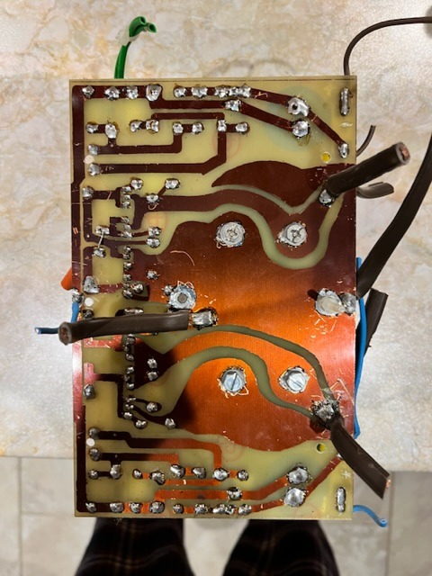

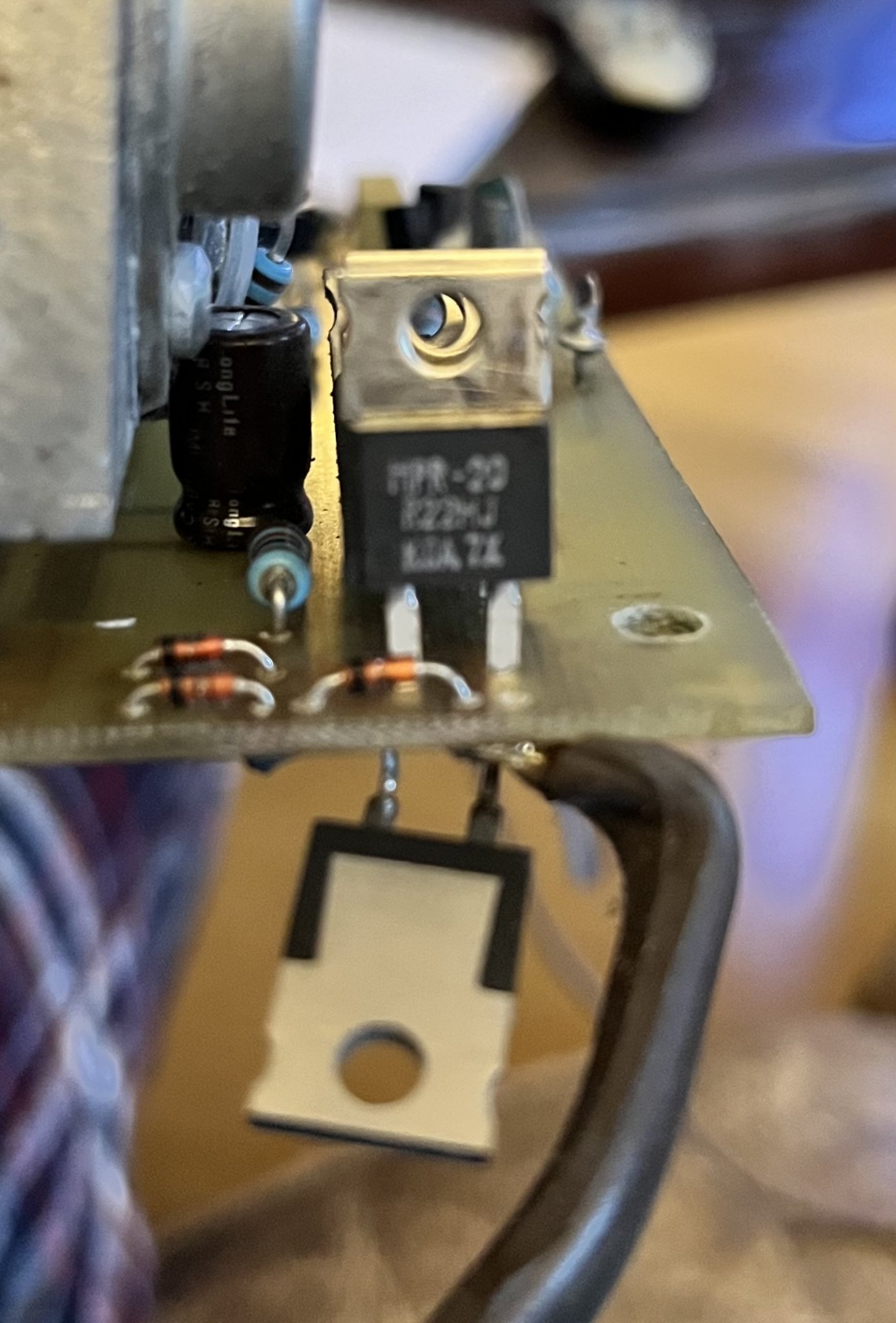

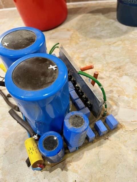

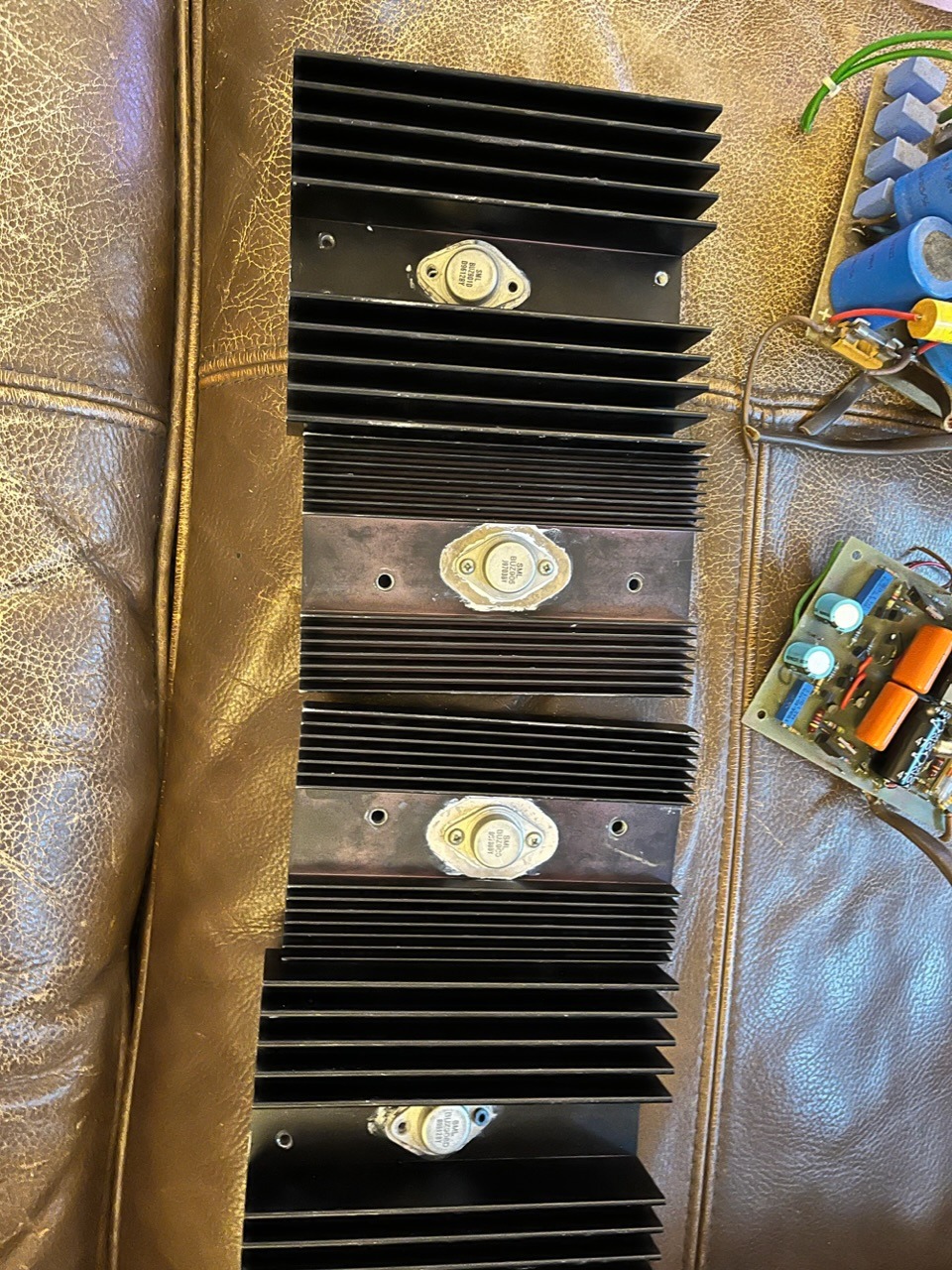

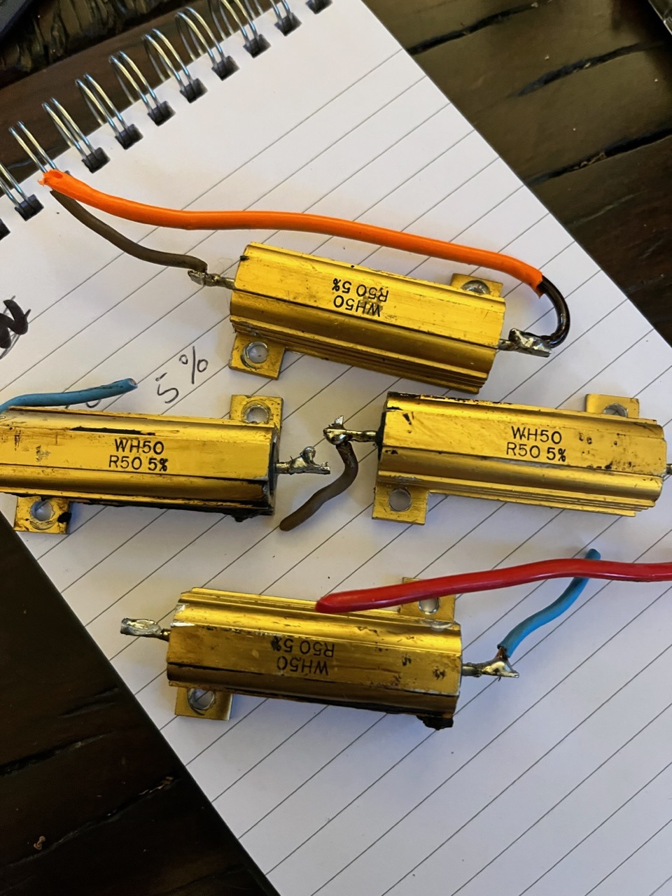

Well I’ve stripped down one of them .
Is there anything within of any value? Or is it scrap ?
