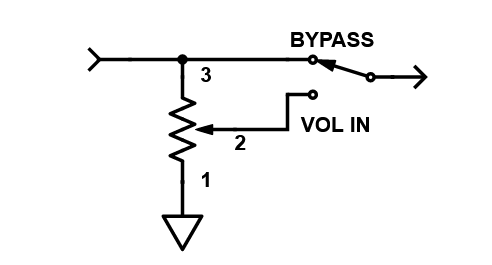

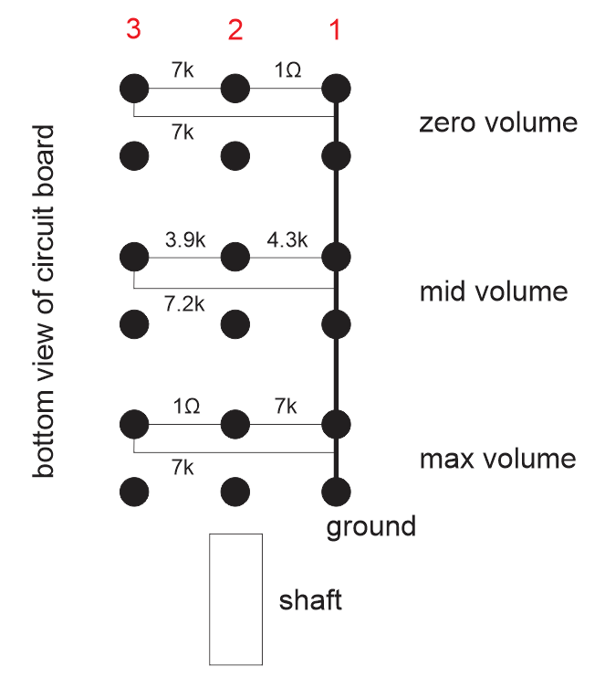

A bit too extreme for me. I'm just trying to get normal volume to be somewhere higher than 9-10 o'clock. I am hoping that installing one of the logarithmic pots that I ordered from AliExpress will resolve the situation. We will know in about 3 weeks when they arrive. If not, I'll live with the slight improvement provided by the 1k resistors that I added, which got me to about 10 o'clock.
Any problem with shorting across 2 and 3 with the pot in place to bypass it and get full volume? If so, it would be nice to have a switch to short across the pot so the volume control becomes optional.
There's a possibility shorting the DAC output if the volume control turn all the way down!Any problem with shorting across 2 and 3 with the pot in place to bypass it and get full volume?
Hmmmm ... so use a resistor like 1 ohm instead of a direct short? I like the idea of adding a switch so I can use the volume control or not use it. I may do that.

I don't think that's an option because of the circuit. It is impossible to tell where pins 2 and 3 go. They do not go to the RCA output. They go to some point in the circuit, possibly to the op-amps. The only known quantity is that pins 1 are ground, and there is linear variable resistance between 1 and 2, and between 2 and 3.
BTW, I destroyed one side of the linear pot tonight while changing the resistors to a lower value. Too much heat or the solder bridged two of the pins where I couldn't see it. Oops. I should have completely desoldered the pot before fiddling with the resistors. The solder they use and the solder I used are like oil and water. So, I removed the pot as carefully as possible with minimal damage to the board, which I was going to do anyway when the new pots arrive. Some of the conformal coating is missing and in danger of shorting nearby exposed traces to the pins if I don't cover those spots somehow (nail polish?), but the solder pads are all intact. The conformal coating scratches off easier than any I have ever seen in my life. We will see if the logarithmic pots work whenever they arrive - about 3 weeks. If not, I may have a brick or have to remove the pot again and have to bridge across it. To avoid a short as a previous post suggests, I would use the smallest value metal film resistor I have on hand. The pot read 1 ohm at max, per my previous picture.

Hi I think you discovered the careful total demolition trick (of the potentiometer not the DAC) works OK.
With stuff built cheaply one should be prepared that any rework can cause more damage than the complaint it should solve. Peeling off of PCB tracks is a joy that has to be experienced 😉
It comes down to do things right at once with careful thinking beforehand, quick soldering and applying no mechanical force. If you have to open the device more than 2 times you are often in the danger zone. Just think anything you do should be done right the first time if at all as any change may lead to premature disposal.

I absolutely 100% agree! I have no experience with lead-free, and earlier posts indicated it would be ok to mix. Not so at all. Do not try it. I now know.
I was going to remove the pot anyway as I ordered logarithmic pots, so no big deal. The traces and pads have zero damage due to my care and patience. Only the conformal coating suffered minor damage. I have tested, and there are no shorts, and clean solder pads, so I'll just cover the scratched conformal coating with nail polish as I have done in the past.

A logartihmic pot instead of a linear pot made all the difference in the world, and they only cost about a dollar. I tested them and chose the one that seemed to track the best at various settings. https://www.aliexpress.us/item/2251832601318607.html

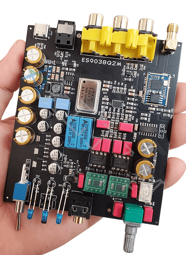

The next question is, which pair of op amps does what function in this DAC? Ideas anyone? It comes in two versions:
2*TI OPA1612 + 2*JRC 2068DD
4*TI OPA1612
The "upgrade" version is the one with 4*TI OPA1612. What function are those two, I assume less expensive, JRC op amps doing? What is the likely effect of "upgrading" them? A further "upgrade" is four MUSES02. The seller says that all four have to be changed to MUSES02 for some reason that doesn't make sense to me.
I also purchased that version, which came with four fake OPA1612 in it, so I am wondering about changing two, or all four, of those. Yes, I now have two of these DACs to fiddle with. I don't know which two to try, or if all four would need to be changed.
Note: I don't use bluetooth or headphones, so if two of the op amps are related to those, they likely are useless to change in my case I assume.

There is an "upgrade" version available that supposedly has a "better" crystal oscillator in it for a few extra bucks.

As an example, I have two of these DACs now. One has an "upgraded" gold-colored oscillator, but it came with some sort of fake OPA1612 op amps. It sounded very, very good but somewhat dull to me like maybe the top end was attenuated slightly, but the midrange was absolutely gorgeous. So, I pulled the four genuine OPA162 op amps from the other one, which I thought had a slightly hard edge to it but really good dynamic punch, and I have installed those in the "upgraded" gold oscillator unit. I may have a winning combination now, but I'll have to listen for a few days before forming a final opinion. I never make a decision like this without a few days of listening to each change with recordings that I have listened to hundreds or thousands of times on my system and others over the course of 35 years.
I have asked the seller to ask the manufacturer what the front pair of op amps does vs the rear pair. I put two OPA1612 in the front and two of the fakes in the rear, and the fakes may be damaged now. It stopped playing after 15 minutes and went dead silent. So I took out the fakes and put in the other two OPA1612. The four OPA1612 together still play fine, and I am listening to those now. I don't know if the fakes are still ok or not. I'm not worried about destroying them if I did.
I am wondering what four MUSES02 would sound like, but genuine MUSES02 are expensive, especially for a set of four.

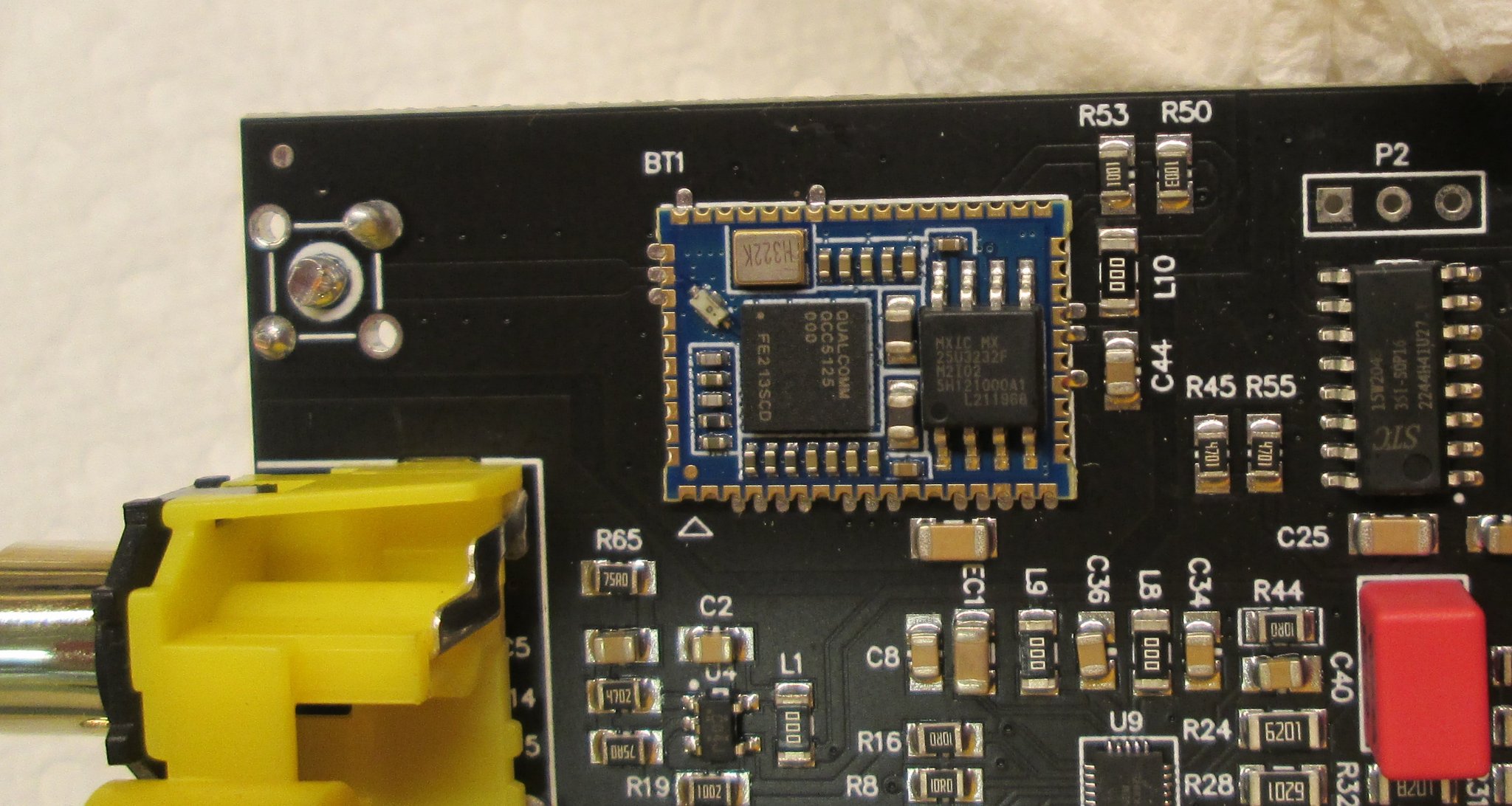

Anyone know how to remove or at least permanently disable (maybe cut the power) to the Bluetooth module shown here? What holds the chip in place on the blue PCB and what holds the small PCB to the main PCB? I wish I could just pry it off, but I'm afraid to try that. If I could identify which resistor(s) power it, they are easily pried loose with tweezers. What I think is the chip pinout and documentation are attached.
The Bluetooth PCB is (normally) only held in place by its soldered contacts. Slight mechanical force and soldering tool will do wonders removing it. When a very thin sheet of plastic or metal can be put between main PCB and the BT PCB it goes fast. Removing L10 maybe also will work out OK but it is difficult to see all PCB tracks. The BT board has a few supply pins so power must be cut to those pins when you ar not able to remove the PCB itself. It is quite unusual to see extensive filtering with ferrite beads, these really make the difference. I am now testing a DAC that has Bluetooth but thankfully its BT module is only powered when chosen as a source. Bluetooth is the enemy of sound quality it seems as disabling/removing it nearly always leads to an improvement.
A razor blade slid easily between the two circuit boards, and the Bluetooth board then popped right off! Thanks for the tip. I have not tested the DAC yet. I assume it still works.
