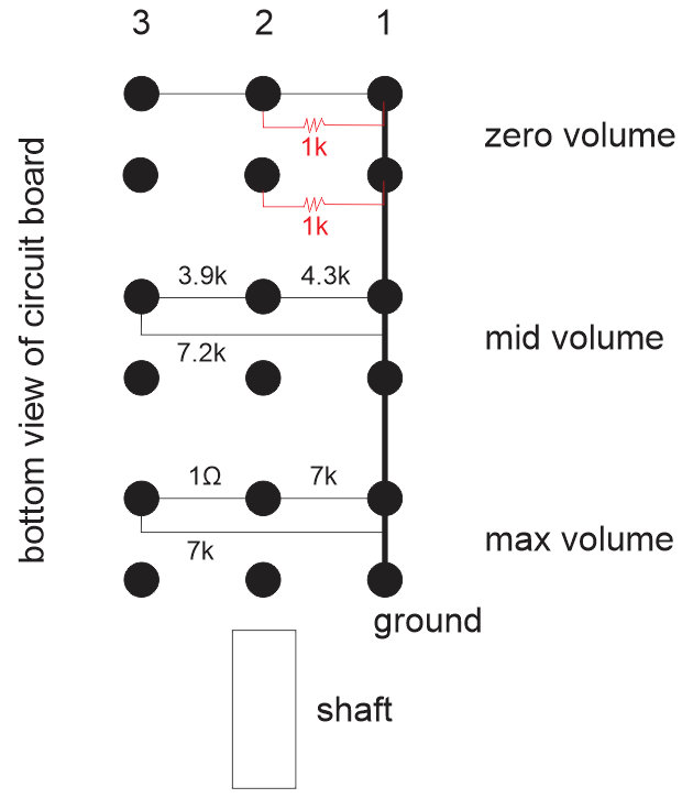

So we have B10k molded onto the pot. 10k linear I suppose when I see that given the B designation.
So on with the meter. I cannot find any connection between the pot and the RCA output jacks except the ground. It looks like the circuit board traces from the pot do not run to the back. Here is a crude drawing with the pot in place on the board. Do I have the pin numbers correct? Bottom view of the board looking at the solder joints.
I have a huge assortment of 1/4 watt metal film resistors in various values. Is the quick and dirty fix to use a 1kΩ? It looks like they are using the lead-free solder. All I have is rosin core 60/40 and rosin core 62/36/2. Is that a problem? I have read not to try to mix them.

1) Is my diagram correct?
2) Can I use my 60/40 rosin-core solder or 62/36/2 rosin core solder when the board was made with lead-free? I am out of desoldering braid.
Yes, diagram is ok, and keep the resistor leads short to avoid shorting out.

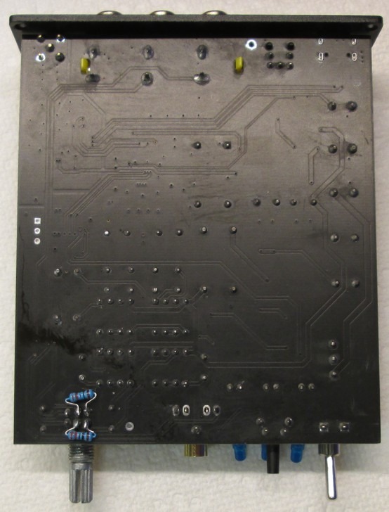

We have music with a pair of 1k metal film resistors! I HATE lead-free solder. The 60/40 I used didn't want to work at all and it took multiple attempts. Still not sure how good the connection is.

The result: the 1k resistors moved normal listening position from about 9 o'clock to about 10 o'clock. That's not much difference, but it helps. I have located 9mm logarithmic pots that I hope will work. I ordered five for $4.75 from AliExpress. When they arrive, I'll test them to see if they really are logarithmic and if so which one tracks the most accurately.

Out of curiosity, I tested the high range of the volume after adding the 1k resistors. The maximum output of the amplifier is achieved at about 3 o'clock on the potentiometer. Normal listening is now about 10 o'clock instead of 9 o'clock.
