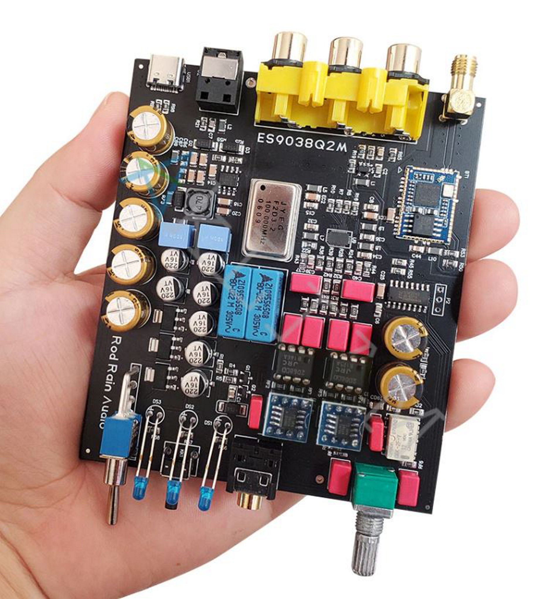

Hi everyone. I received an inexpensive "Rod Rain" Chinese DAC 2 days ago, and although it sounds nice, normal listening volume is only about 9 o'clock on the volume knob. Is there any chance I can simply replace the pot to give me better control? Having only from 7 o'clock up to the 9 or 10 o'clock knob position means precise adjustment isn't very easy.
I have no idea what the value of the pot is or how it works in the circuit. I asked for a schematic and was denied. A picture of the board is all I have. Note that the op-amps are 4 x OPA1612, not the ones shown in the picture.
I am using the digital coaxial input and the left-right RCA jacks output to my Dynaco ST-70 series ii amplifier.
It works, and I like the way it sounds, but the volume control issue is annoying. I am not an electronics expert or engineer - just a novice with a multimeter and a soldering iron - so I don't know if this is something I might be able to fix or what the fix might be. Suggestions welcome. 🙂

Update: the seller states that it is a 10k pot? Can I simply replace it? What value?

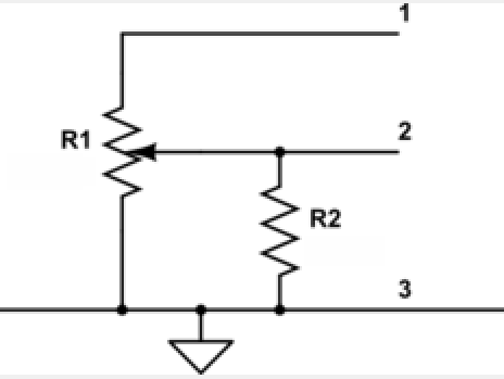

Would a cheat like adding an R2 as below work?

I's ohms law.
Calculate for different positions of the pot.
You could use a couple of resistors to make an attenuator on the output.
Making an RCA attenuator avoids permanent alteration and messing with the board with the potential for damage.

Based on the picture of the PCB, it seems that the potentiometer used in the Rod Rain DAC is a standard 10k linear pot with three pins. If you're comfortable with electronics and have a multimeter and a soldering iron, replacing the pot could be a feasible solution.
You could start by desoldering the existing pot from the PCB and measuring its resistance with a multimeter. If it's indeed a 10k pot, you could replace it with a higher quality one of the same value. Make sure the new pot has the same pinout as the old one, and be careful not to damage any components or traces on the PCB during the desoldering and soldering process.
However, keep in mind that replacing the pot might not necessarily solve the issue if there are other factors limiting the volume control range, as I mentioned in my previous response. Also, note that modifying the DAC could potentially void any warranty or return policy, so proceed at your own risk.

Easiest would be the extra resistor from wiper to ground. Around 1k.
Adjust the resistor value so your normal listening volume is about halfway up.

Post 5, are we sure the circuit would be happy playing into a 1K load?

See post #6. No need to turn up the pot to near the maximum.
And the OPA1612 used can drive 600 Ohms.

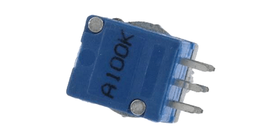

OP can easily verify this by putting the potentiometer in the middle position and then measure the resistance from wiper to either one of the other pins. Should be about equal when it is a linear potentiometer.
Because logarithmic law pots cost more than linearWhy on Earth would an engineer design that and a manufacturer build that? It doesn't makes sense (to me). I'm no expert, but even I know it's best to use logarithmic for colume control.

I think the type of pot will clearly printed on its back.
We will know soon.

It looks like there are some decent film/foil caps in the filter (red ones near the op amps). Not bad for a budget device.
