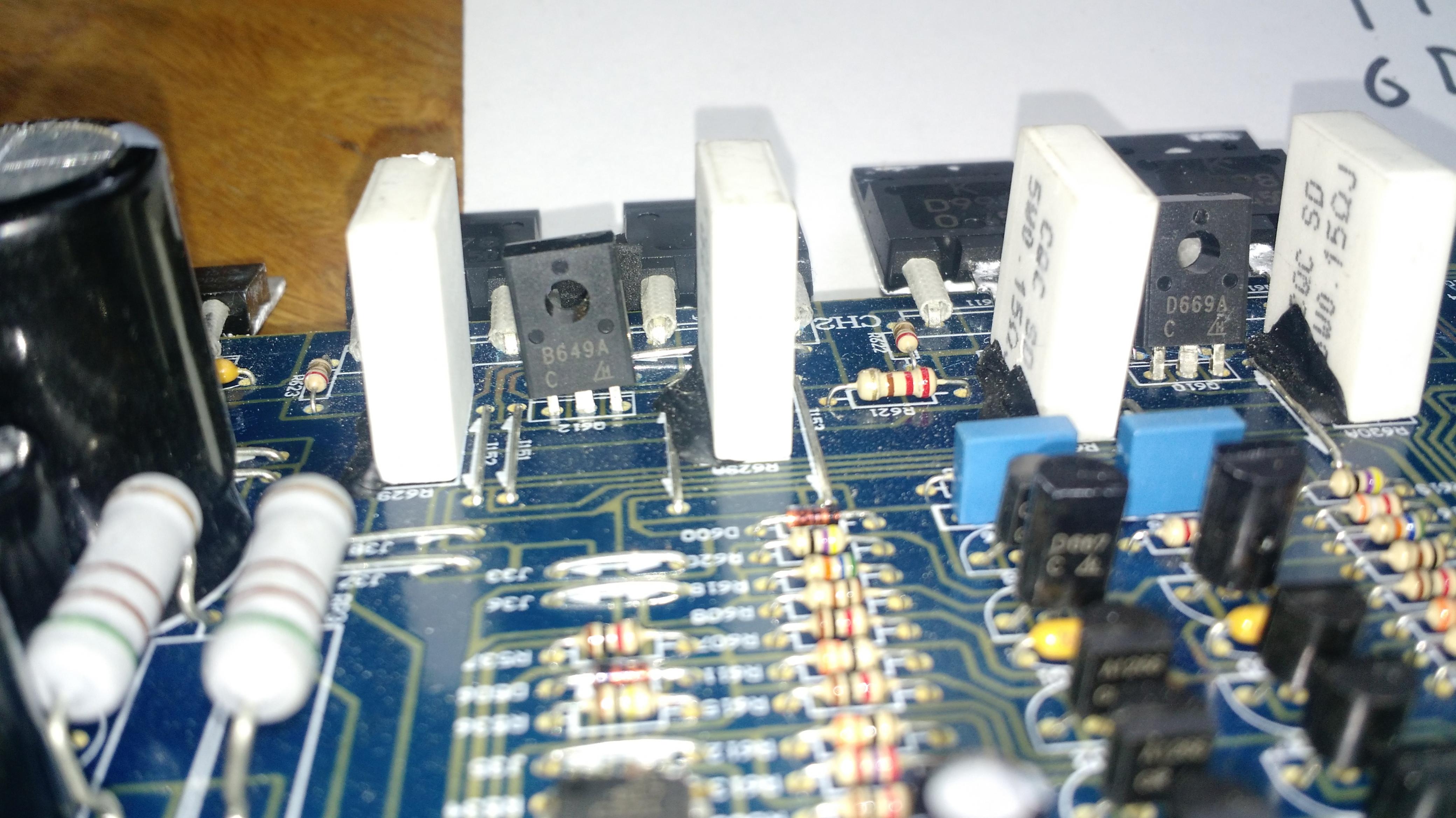

Please forgive me (my dumb mistake)... I believe your talking about B649A/D669A in the output section and in between the tombstone resistors - is that correct? I have a transistor tester on order - it should be here tomorrow I'll pull and test them when it arrives.
It appears the IC TL494 has failed it show the same voltage as the external supplied voltage on most all the pins (not just 8, 11 & 12). Can I sub in a TL594? The data sheets appear to be the same, with the exception of Vcc Low voltage shutdown.

Hi Perry, Yes thanks - I knew that. But what I'm trying to say and I just re-verified is... With the MM on diode setting pin 7 is shorted on both positive and negative terminals. Also with MM on diode setting the positive and negative terminals also show shorted.
Again when I replace the negative power supply bank of the 3 IRF3205s they fry when I put DC power to the amp even with the small little 12v 3amp power supply I have for testing .

Hi Perry, thanks here are the results for the TL494 with 12v hooked up.
MM on DCV red lead on pos term black ead on pins.
All pins (including #7) = 12v
MM on DCV red lead on neg term black lead on pins.
All 16 pins = 0V
And I need to add it sparks the + or - wire when I hook up 12v DC to it with the power supply plugged in (without the remote wire attached).
Attached another full board pic of how I just tested it for reference.

You never use the B+ terminal for a reference. Black probe on main ground, meter on DC volts.
Sparking is normal for initial contact or after it's been disconnected for a while and the caps have discharged. Repeated violent/intense sparking isn't normal.

The voltage on the solder pad for the gate leg of the FETs should be about 5v DC. About the same as pins 9 and 10 of the TL494.
Hi Perry, I have both banks of the PS IRF3205s out of the board.
Here are the results with the Remote wire active:
B+ = 12.32 V
TL494 Pins 9&10 = 4.48
PS negative side FET Bank all gate pads = 4.48 V
PS B+ side FET Bank all gate pads = 4.04 V
Note: PS negative side I replaced all gate resistors with 47 ohm 1/4 watt 1%
B+ = 12.32 V
