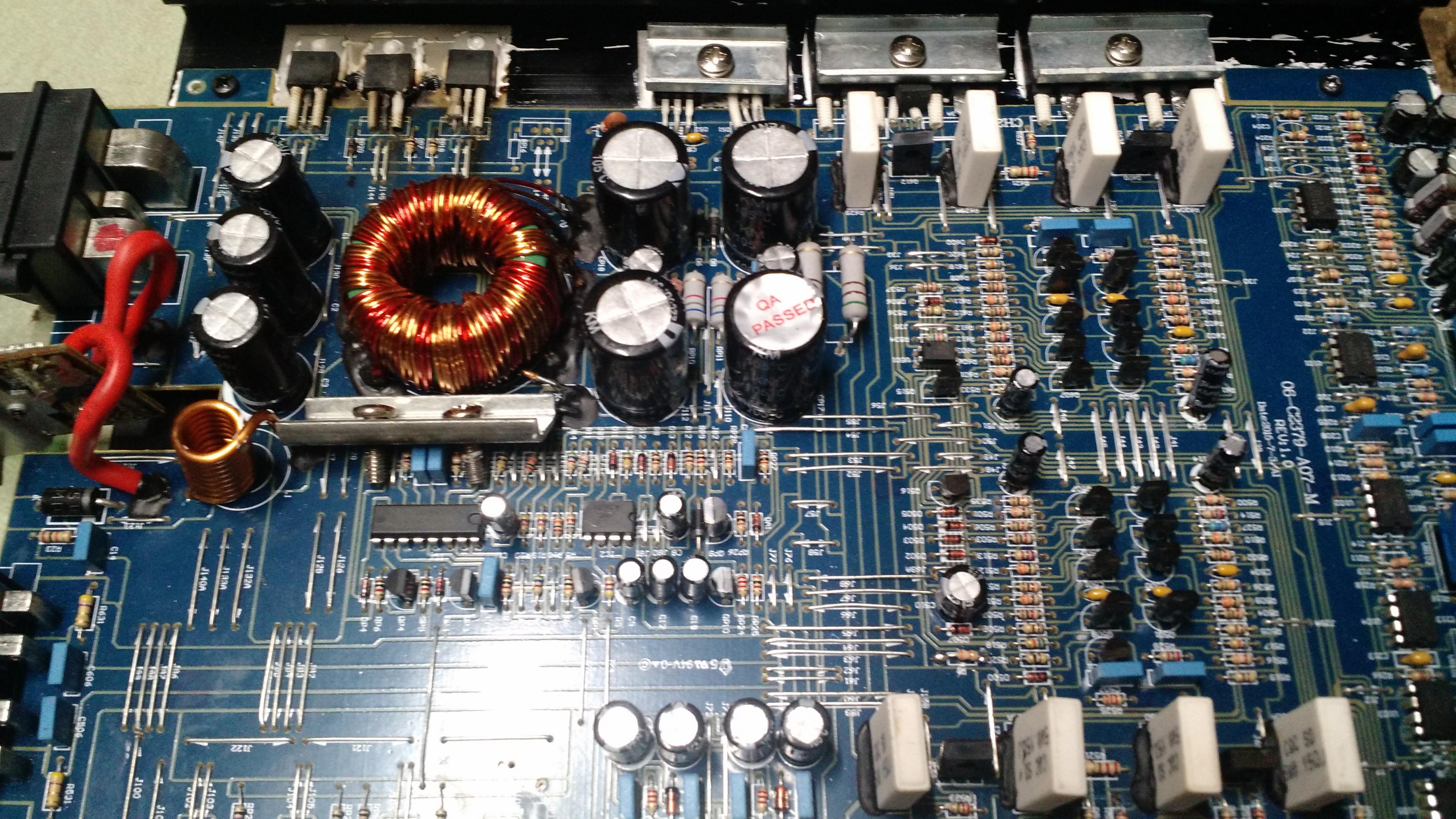

Point out the resistors that were burned on a photo.
Screws are pointing to the 3 open resistors on channel 1
Did you pull them to check them? They are different values.

Well I replaced channel 1 output transistors along with a few resistors. I also replaced all of the power supply transistors with IRF3205s. I then hooked it up to a 12v power supply with a 5watt fuse, did a little probing. I thought everything looked good... I even played it about 15 mins on the test bench.
I then reinstalled it back in my truck and after about 10 mins of playing the power supply bank burnt out 🙁
I know for sure I didn't have any solder bridges - now I'm lost on where to start over.

I reattached the picture. I just replace all of channel 1 and both banks of power supply transistors. A few resistors we're also open and needed to be replaced.
